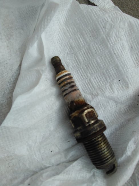

I recently was changing my spark plugs and wires, got all but one done. With the plug I was unable to get out, I was unable to get any grip or bite on the plug, upon investigation I discovered deposits, or dirt surrounding the hexagon for the socket to fit on to. Now I'm receiving a misfire from that spark plug and would like to know what can be done to clean the deposits from around the spark plug in order to get to the hexagon to try and take it out? Any help would be greatly appreciated.

I am not sure what you have in the spark plug hole, but I doubt it's carbon deposits. It could be dirt or gunk or something. I would lean towards maybe some plastic or something along those lines. If it is dirt, crud, or something like that I would get a can of engine degreaser/cleaner, which is available at any auto parts store for around $5.00 and spray done in the spark plug hole and let it sit for ten to fifteen minutes. Don't worry about hurting the spark plug, I doubt it would anyway, because you are going to replace it anyway. Get a screwdriver, rag, or brush and get that out of the hole and from around the spark plug so your spark plug socket can get get down around the spark plug and get it out of there. Get back to us with how things are progressing, please.

Okay, well I got a hanger, started chipping away at the dirt and/or rust. Was able to see the hexagon and got the socket on it and was able to remove the plug.
