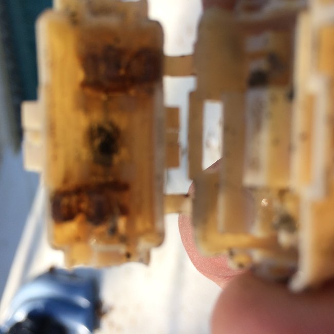

Been talking to a couple other folks and looking at TSBs. One thing that has been happening in a few other GMs is water intrusion into the fuse panels. The water causes a partial short that causes the engine to keep running even when you pull the key.

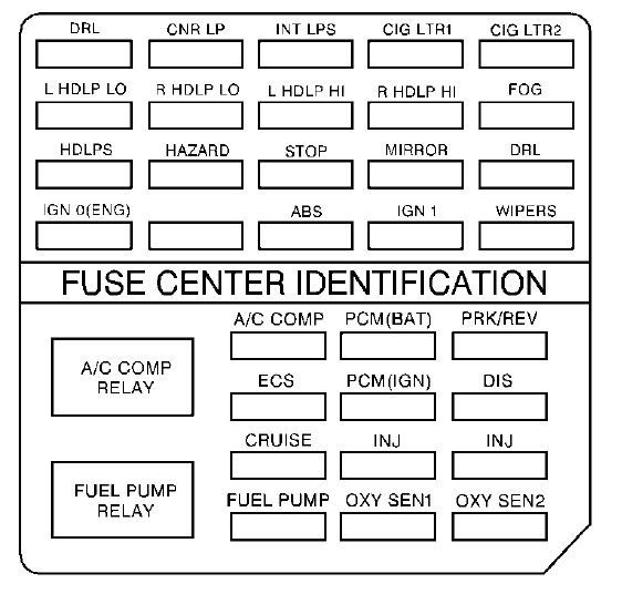

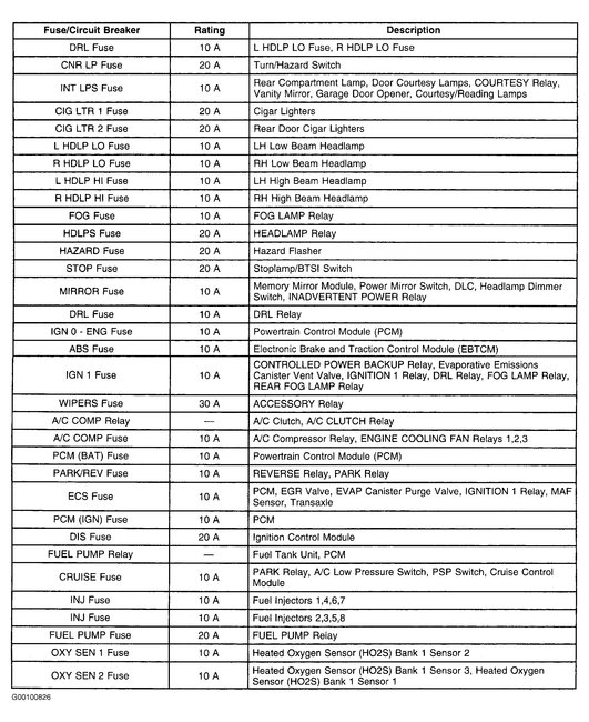

Here's something I noticed, its been there awhile though so its not a direct cause. There is a very small red wire that connects the passenger side of the ECS and CC fuses under the hood. Its wedged into one side slots. I"m clueless on that. ECS has a pretty big role though, manual says:
"ECS Transaxle Shift Solenoids, Mass Airflow, Canister Purge, PCM, Linear Exhaust Gas Recirculat, Front Ignition-1 Relay
CRUISE Stepper Motor Cruise Control, Power Steering Pressure Switch, Low Refrigerant Pressure Cutoff Switch, Park Rela"
Like I said, the jumper has been there awhile, but why.

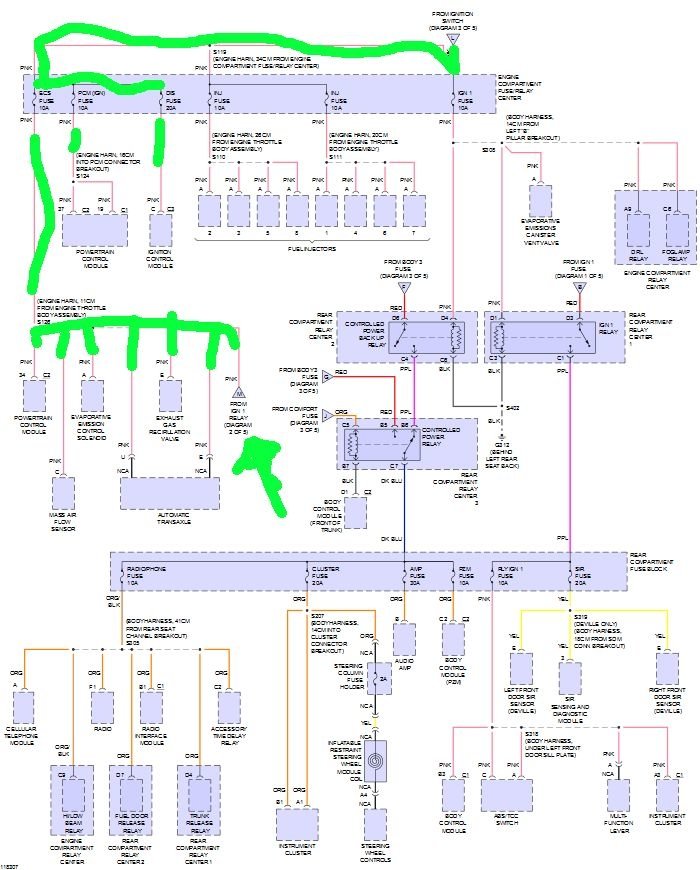

If everything works the shot has to be turning on just about every circuit, so it almost has to be one of the larger fuses.
Pulling the ECM fuse is simply shutting down the ignition and fuel. The short is above that system. That is shown because you can hear the "hum" when you put the fuse back in. So everything is still powered. The only reason it isn't running is that the starter didn't turn over the engine. Basically the car thinks the key is in the run position all the time.
The water intrusion I mentioned occurs on the rear of the panels, and inside them. You probably wouldn't see any damage at the fuse blades.

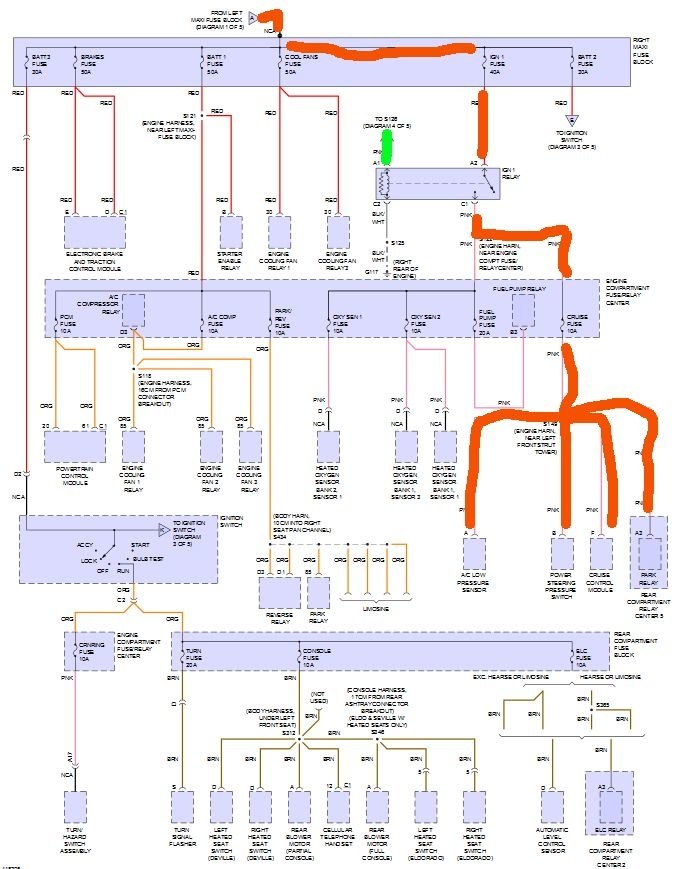

I have 4 sets of wiring diagrams for your car. GMs OEM files, Alldata, Mitchell, and Identifix.
Thanks for all the information. That all the circuits act powered is actually a big help. It means that a constant power or ground has to be the issue and that it is independent of the ignition switch.

OK I have a test for you. You will need a test light, cheap one is just fine, just make sure it has a long cord.
You mentioned a jumper from ECS to CC, That might mean that there is a damaged circuit under the box, the question is which one.
Use the light with the key off and see if you have power to both sides of the CC fuse. If you do, you shouldn't, that is a switched circuit.

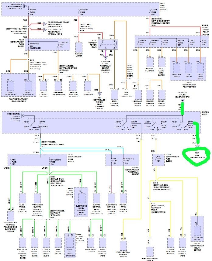

Looking at the wiring that jumper may be the problem. The CC fuse appears to be switched by the Ignition relay, which itself is switched by the power feed from the ECS fuse. This wouldn't be an issue normally. But that jumper could be actually causing a feedback loop. When you turn the key on, the power should feed to the CC fuse through the ignition 1 relay. That relay is fed from the battery with no switch.
The relays switching power actually comes from the ignition switch to a buss bar in the fuse panel. That bar feeds the ECS fuse, the PCM (ign) fuse and the ignition control module. The ECS fuse is the one that feeds power to the switching side of the ignition one relay.
So you turn on the ignition switch and normally the power would go to the ECS fuse, then out of the ECS fuse into the control side of the ignition relay. That in turn connects the cruise fuse, fuel pump, O2 heaters, and more to a direct power source through the same maxi fuse that powers the ECM and the rest of the engine controls.
If the jumper is doing what I think it is, the power from the ignition switch isn't controlling the ignition relay, the jumper is causing it to stay on because as soon as power is applied from the battery the jumper sends power to the ignition relay, which then turns on the rest of the systems because the PCM thinks the key is on.
Might be totally wrong but it's a theory.

That's what I figured. With the key off there shouldn't be power at that fuse. It should be dead. The jumper is feeding it power when it shouldn't have any.
If you can see the diagrams the red is the CC fuse. It comes from battery power through the relay. It should go on/off as the key turns it on/off. BUT. If you look at the green path that is the ECS fuses feed. It goes through the key switch so it should turn on/off with the key. So far it sounds good. But if you turn the key on one time, the power that comes through turns on the ECM, ignition and more. It also turns on the circuit that feeds the red wires. Not an issue until you realize that circuit is now feeding direct battery power back through the jumper which locks the relay on.
I actually cannot see how it even worked before because of the way that jumper would effectively bypass the key switch as the control. It is taking a power circuit that is switched by the key to shut off the system and connecting it to a constant power on source. I think the person who added that jumper got REAL lucky that it worked at all. The only thing I can think of is that maybe the circuit pulled just enough power after key off that the relay could open, or there is an added diode somewhere to keep the power from feeding back the wrong way.
I would replace the fuse panel first to eliminate that jumper. I don't think the ECM is part of the issue. I think it is just a bad panel. Pulling the ECM fuse breaks the loop and the systems power down.
