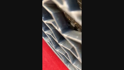

I have the vehicle listed above and an aftermarket supercharger installed with it, I went to add coolant to the supercharger through its separate reservoir bottle and it wouldn’t stay full, eventually pouring out of the radiator. Now it will not start, it cranks but no start. I don’t know why this would happen or if I did something wrong.

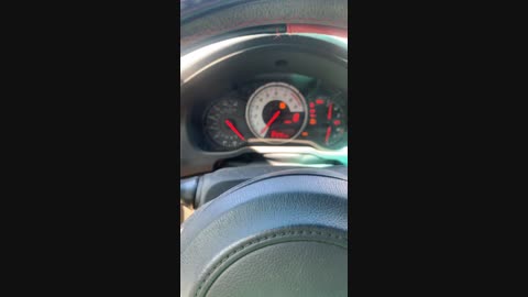

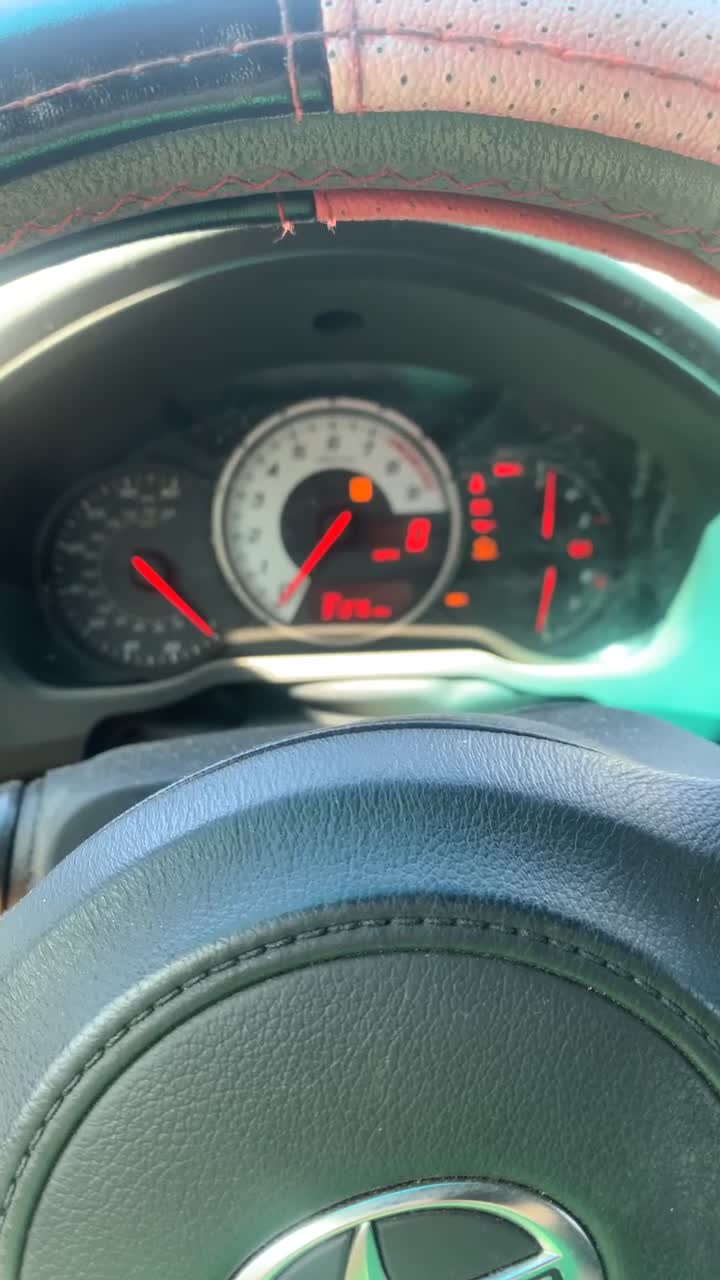

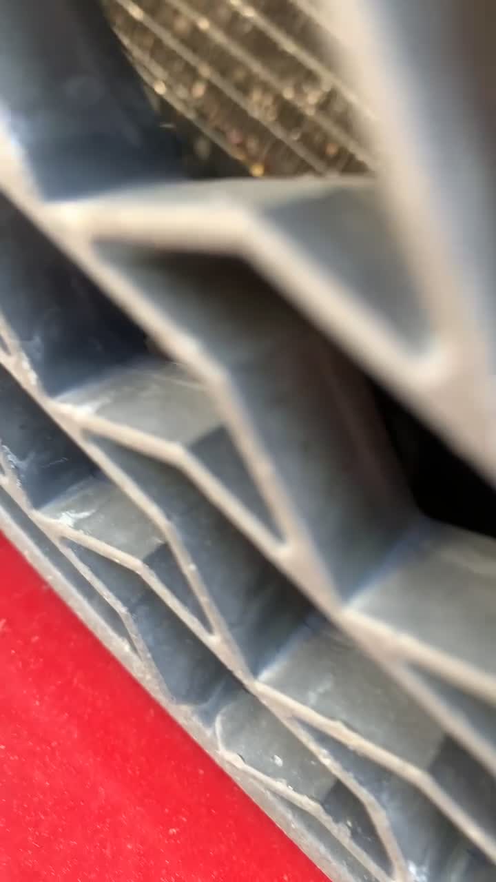

Attached some videos, I have a sprintex/innovate twin screw supercharger on my 2013 Scion FR-S.
It has its own separate radiator and was thinking that it went bad or the water pump.
It has a specific place to pour the coolant into so I know I poured it correctly, just the bottle wouldn’t stay full and before I knew it, it was dripping from the smaller radiator.
