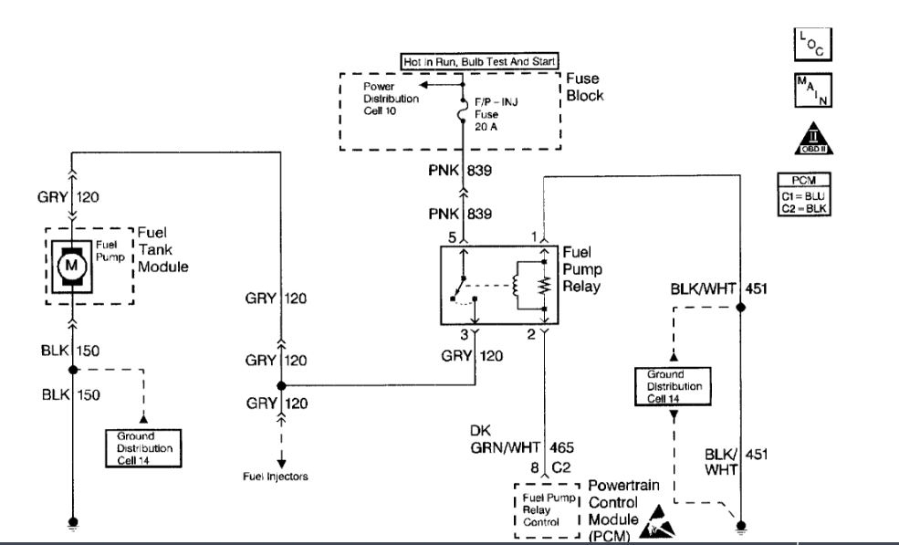

Ran car out of gas, put fuel in it still would not start. Replaced fuel pump, fuel filter and checked to see if the relay switch clicked when key was turned on. Still no fuel. Pour a little gas into it it will run until the gas burns off. Checked fuel pressure regulator also. Got any ideas?

I attached a wire diagram for you to view. Check for power to the relay. There is a fuse listed and be sure there is power to both sides.
The PCM controls the control side of the relay.

Thank you, but we have it fixed. Ended up being a broken wire.
