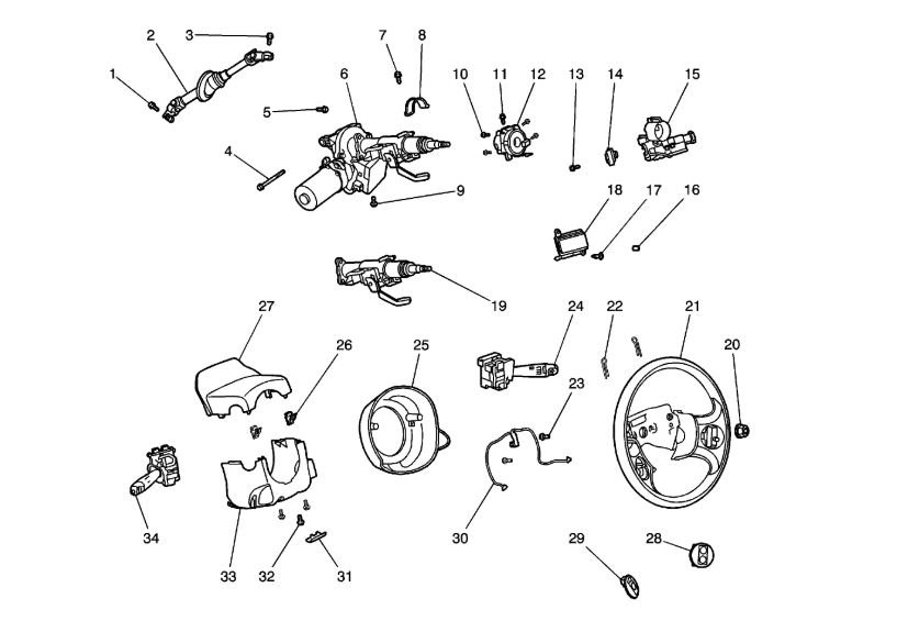

- Lower Intermediate Steering Shaft Bold
2 - Intermediate Steering Shaft Assembly
3 - Upper Intermediate Steering Shaft Bolt
4 - Lower Steering Column Support Bracket Bolt
5 - Lower Steering Column Jacket Bolt
6 - Steering Column Assembly
7 - Ignition / Start Switch Clamp Bolt
8 - Ignition / Start Switch Clamp
9 - Upper Steering Column Support Bracket Bolt
10 - Turn Signal Switch Bracket Screw
11 - Turn Signal Switch Bracket Screw
12 - Inflatable Restraint Steering Wheel Module Coil Assembly
13 - Ignition / Start Switch Screw
14 - Ignition / Start Switch Assembly
15 - Ignition / Start Switch Housing
16 - Spring
17 - Ignition Lock Cylinder Control Solenoid Screw
18 - Ignition Lock Cylinder Control Solenoid Assembly
19 - Steering Column Jacket Assembly
20 - Steering Wheel Nut
21 - Steering Wheel Assembly
22 - Inflatable Restraint Steering Wheel Module Retainer
23 - Steering Wheel Shroud Screw
24 - Wiper / Washer Switch Assembly
25 - Steering Wheel Shroud
26 - Lower Trim Cover Clip
27 - Upper Trim Cover
28 - Cruise Control Resume Switch Assembly
29 - Cruise Control Switch Assembly
30 - Harness Assembly
31 - Lower Trim Cover Plug
32 - Lower Trim Cover Screw
33 - Lower Trim Cover
34 - Headlamp / Dimmer / Park / Turn Signal Switch Assembly

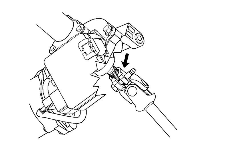

Removal
Removal Procedure
1. Place the steering wheel in the straight forward position.
2. Remove the steering wheel. Refer to Steering Wheel Replacement.

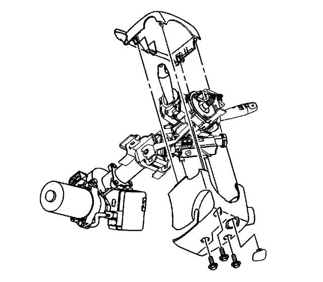

3. Remove the column trim covers. Refer to Steering Column Trim Covers Replacement.

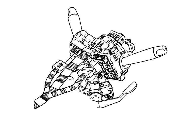

4. Disconnect the head lamp/turn signal harness connector from the SIR coil module assembly.
5. Disconnect the wiper/washer harness connector from the SIR coil module assembly.
6. Disconnect the SIR coil harness connector from the SIR coil module assembly.
7. Remove the SIR coil module assembly. Refer to Inflatable Restraint Steering Wheel Module Coil Replacement.
8. Disconnect the ignition lock cylinder harness connector.
9. Disconnect the ignition switch harness connector.
10. Disconnect the theft deterrent control module electrical connector, if equipped.
11. Place scribe marks on the intermediate shaft to steering column, for use during assembly.
12. Remove the intermediate shaft pinch bolt at the steering column and discard.
13. Slide the intermediate shaft off the steering column.

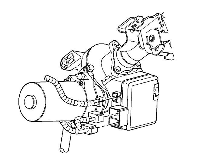

14. Disconnect the electronic power steering (EPS) control module power feed harness connector.
15. Disconnect the EPS control module small harness connector.

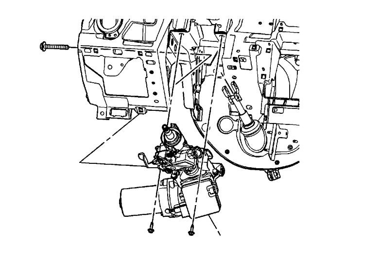

16. Remove the steering column pivot bolt.
17. Remove the steering column mounting bolts.
18. Remove the column from the vehicle and place on a bench.
