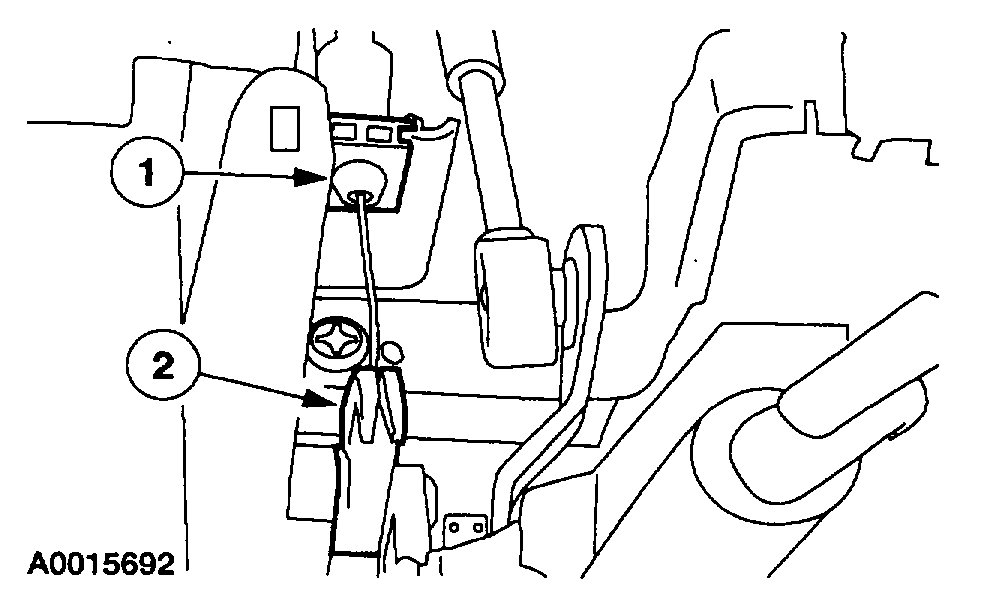

Most commonly, the shift interlock isn't the problem, but rather the brake light switch. When this happens (it will not shift from park) confirm the brake lights are working. The park lock solenoid gets power through the brake light switch, so if it fails, you cannot remove it from park.
If you find the brake lights are working, then I would suspect the park lock solenoid.

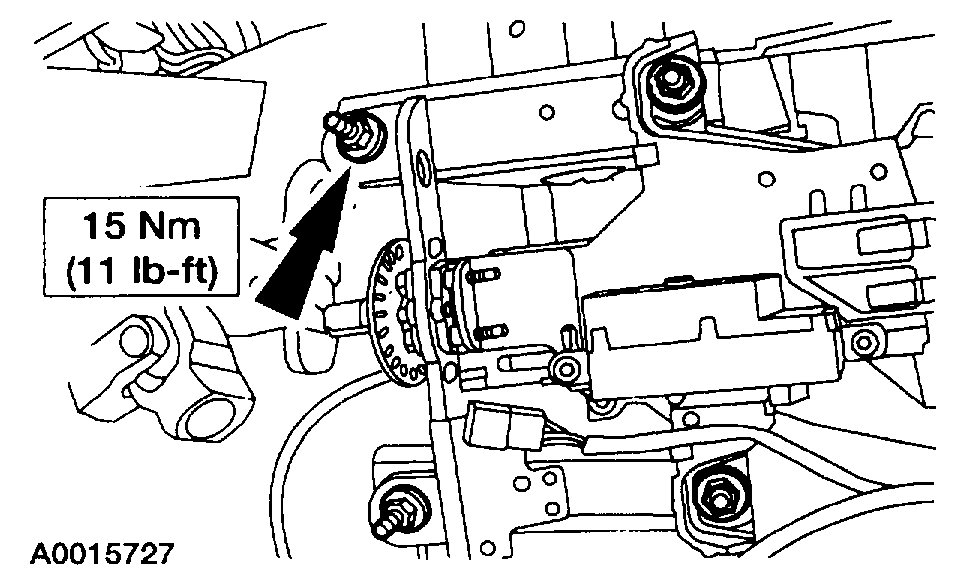

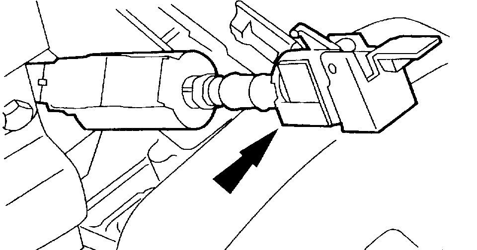

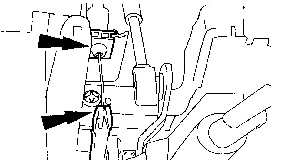

If you determine one is bad, here are the directions for replacing both. First is the brake light switch. Picture 1 correlated with these directions.
REMOVAL
1. Disconnect the battery ground cable.
2. Remove the BPP switch.
1 Disconnect the electrical connector.
2 Remove the self-locking pin.
3 Remove the BPP switch from the brake master cylinder push rod.
INSTALLATION
1. To install, reverse the removal procedure.

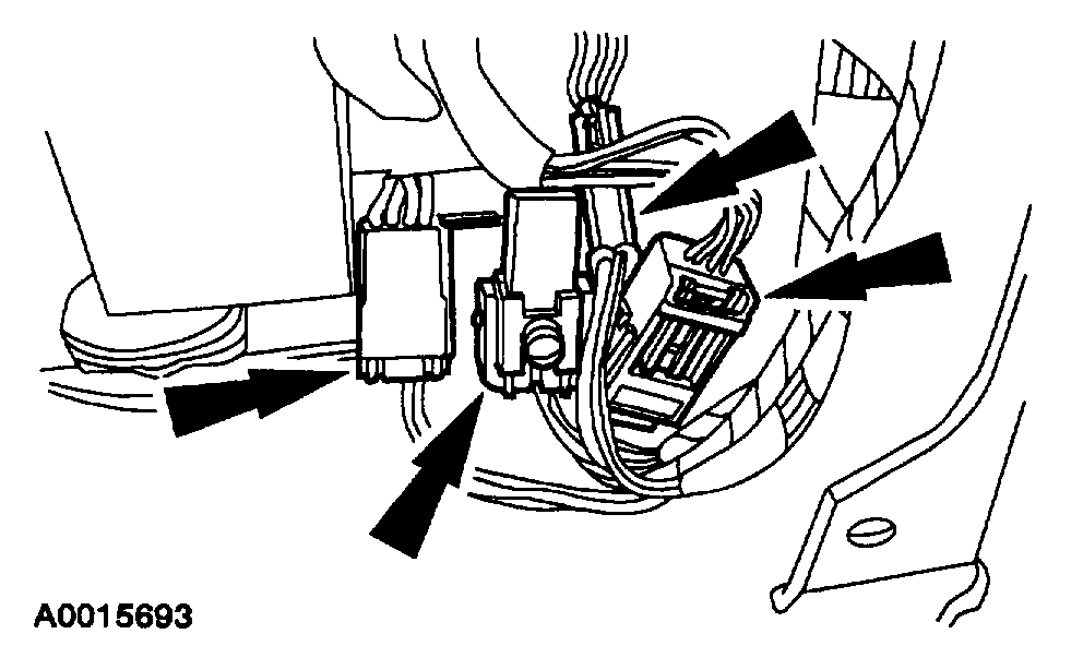

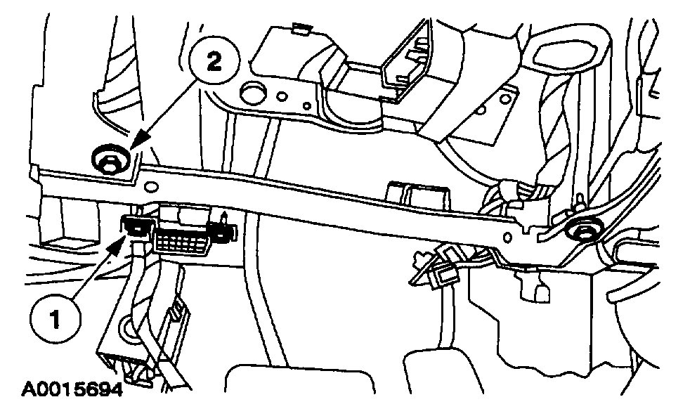

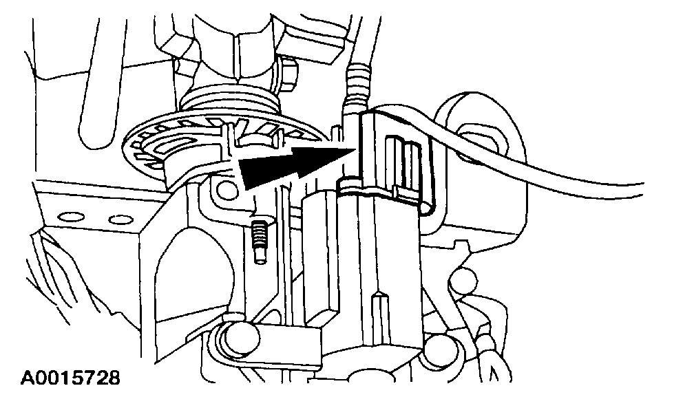

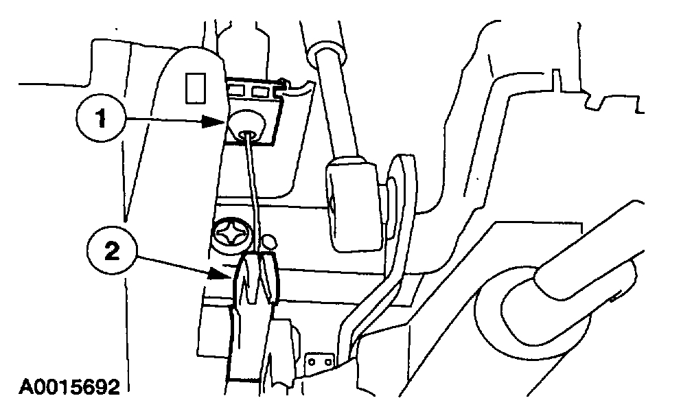

Here are the directions for the park lock solenoid (park interlock). The remaining pictures correlate with these directions.
Brake Shift Interlock Actuator-Floor Shift
Removal
1. Remove the center console.
2. Remove the-ignition/shifter interlock cable from the floor shift.
1. Disconnect the cable from the bucket.
2. Disconnect the cable from the shift cam.
3. Remove the LH lower instrument panel trim.
4. Disconnect four electrical connectors.
5. Remove the steering column support bracket.
1. Remove the diagnostic electrical connector bolts.
2. Remove the steering column support bracket bolts.
6. Remove the nuts and lower the steering column.

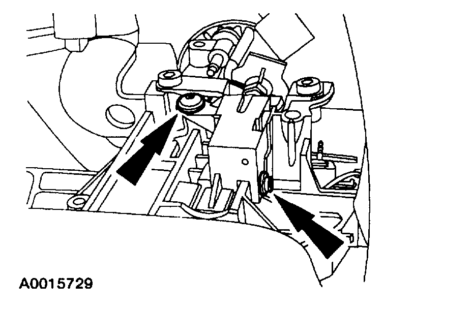

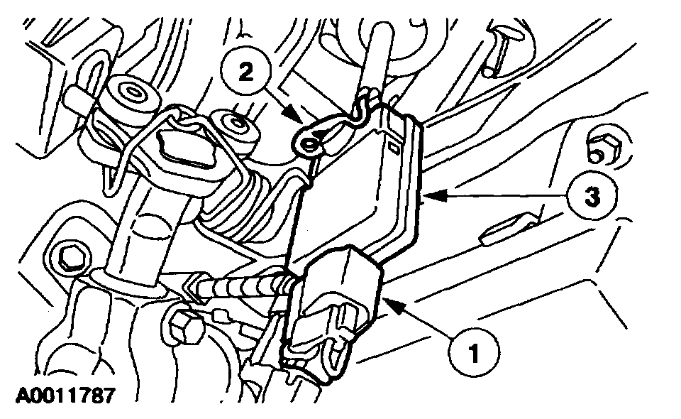

7. Disconnect the shift interlock electrical connector.
8. Remove the bolts.
9. Remove the ignition/shifter interlock cable and actuator assembly.
Installation
1. NOTE: Check for correct interlock operation. The ignition key should be removable only with the trans-axle range selector lever in park. The trans-axle range selector lever should be locked in the PARK position with the key removed.
Follow the removal procedure in reverse order.

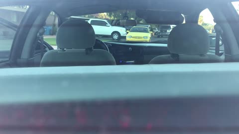

JGONZO2398
  • 409 POSTS
So guess what happened? My parents tried to use my car but it was stuck in park, I took advantage of the situation and checked to see if the brake lights were working as my mom pressed on the brake pedal, and they do not. I guess they are working randomly I just have not noticed. I will check the fuses and probably switch out the brake light switch.
Tuesday, April 13th, 2021 AT 7:47 PM
  • 110,192 POSTS
Perfect timing. It is most likely either the switch is bad or out of adjustment. Inspect it before replacing it to make sure it is tight and making contact with the brake pedal. I attached the directions for replacement in the earlier link. However, if you need anything other than what I provided, let me know. Please let me know how things work out for you and if you have other questions.
By the way, I feel confident it is not a fuse. That would fail all the time. However, I have been wrong in the past and will again in the future. LOL I just keep trying my best.

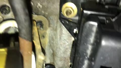

See anything out of the ordinary?

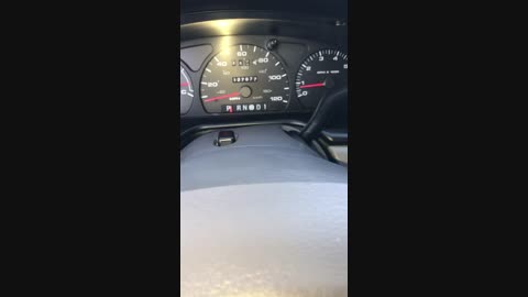

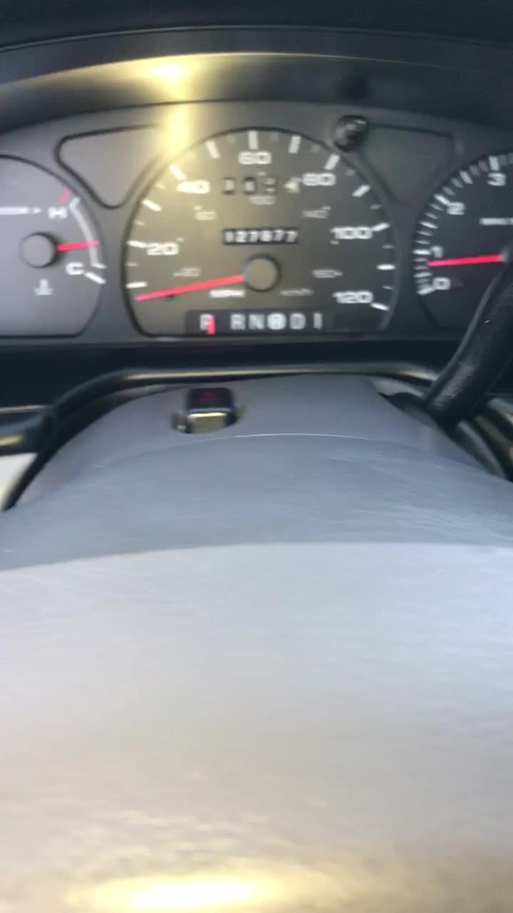

JGONZO2398
  • 409 POSTS
Check this out. Was stuck in the beginning of the video, as soon as I moved the camera to my foot on the pedal, it shifted. Then those last two times I tried to shift it was stuck again.
  • 110,192 POSTS
I do not. Manually actuate the switch to see if it turns the lights on. It is just a button. Also, make sure the switch is tight. If the switch still does not turn the lights on, check for power to the switch. It should always have power, even with the key off.

Haha, I took a video of the upper brake light behind the back seat, positioned my phone as best as I could to get a view of it since there is literally no one to stand behind my car right now and check if the brake lights are working. There is only like small lights and flashes, does not seem normal to me. What do you think?

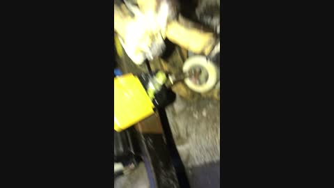

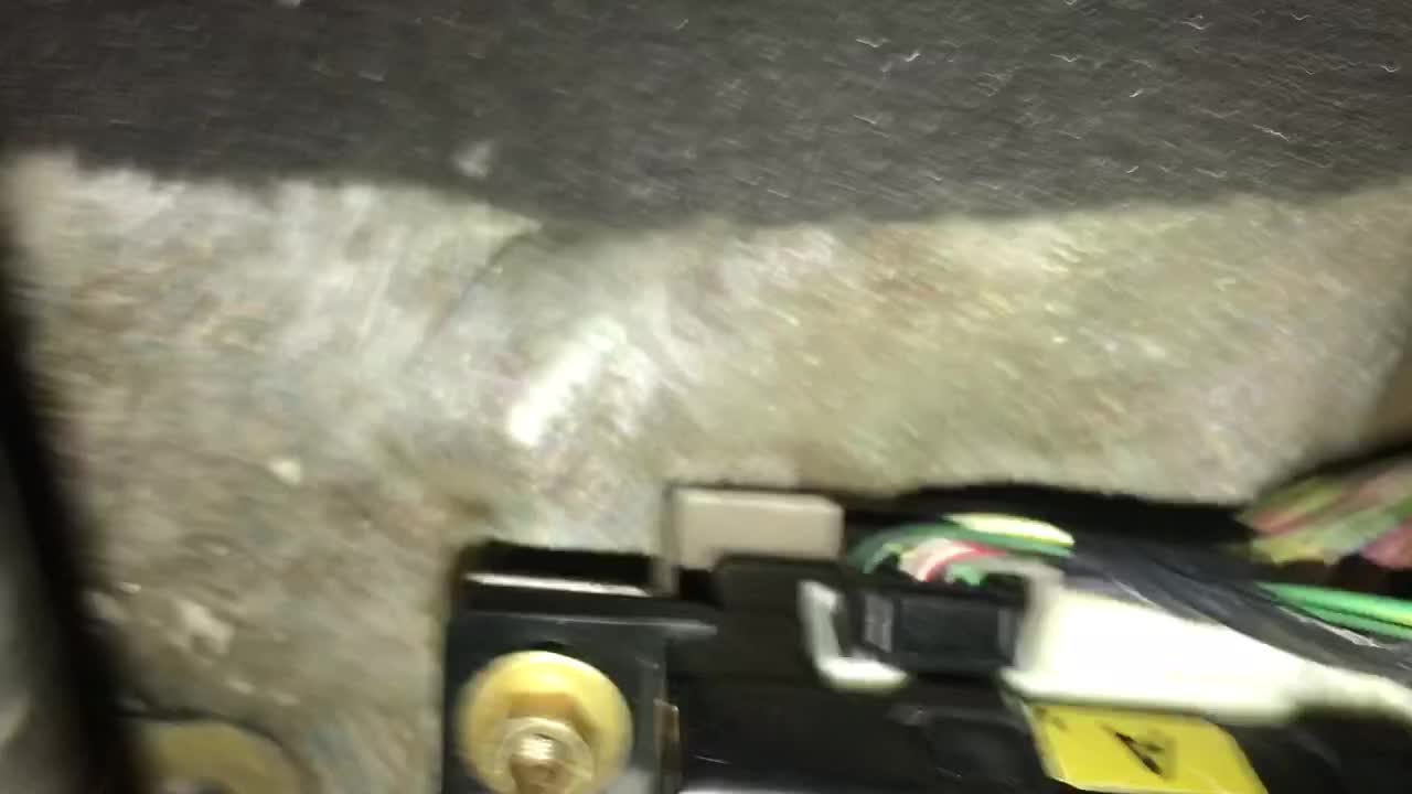

JGONZO2398
  • 409 POSTS
After I carefully inspected the connector going into the brake switch once I removed it, I noticed there was moisture on the connector and the two prongs from the switch in which it goes into, I am guessing that is the culprit?
JGONZO2398
  • 409 POSTS
This was my fault for lubricating the entire area under my steering wheel, the joints and the pedals I sprayed white lithium grease all over. I am guessing this is what ultimately ruined these switches, but! I made a discovery just a few minutes ago, the brakes completely stopped working and my car has not been shifting for the last twenty minutes that we have been talking about this. Now that it got a little darker, I can see if the rear brake light turns on or not from the rear view mirror, if I place my foot on the pedal even the slightest, the light switches on and I was able to shift to drive. Obviously something is wrong if the sensibility of the pedal/switch is this sensitive, literally just laying my foot on the pedal with minimum weight, the light comes on, if I press any harder, light will not come on at all. Is there any way I can adjust this or do I have to switch the entire brake switch and cable?

Also, what it this other black/blue-greenish switch next to the brake switch?

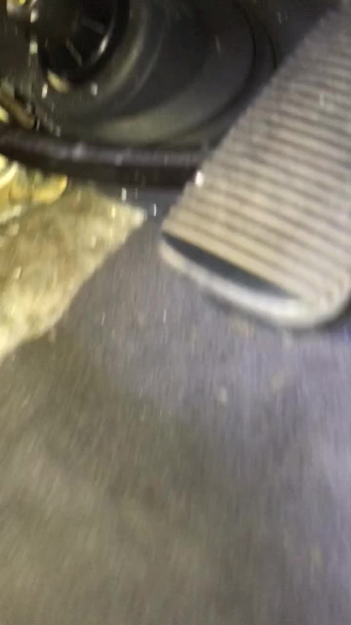

JGONZO2398
  • 409 POSTS
This is me slightly pressing the brake pedal, as soon as I push down hard, lights go off.
  • 110,192 POSTS
Hi again. I found it! I knew there was a recall on these vehicles for a faulty brake light switch and wiring. It has been so long, I just was not sure. However, I found it. You need to contact a Ford dealership and confirm that the recall procedures were never done to your vehicle. They will need your vehicle identification number (VIN). If was never done, repairs will be free of charge. Note: There are two separate recalls regarding this issue (from 2004 that is why I could not remember). Take a look through these recalls. I have attached both for you to review.

JGONZO2398
  • 409 POSTS
Fixed! It was the brake light switch.
JGONZO2398
  • 409 POSTS
Recall was not open according to the dealer so I did it myself.
