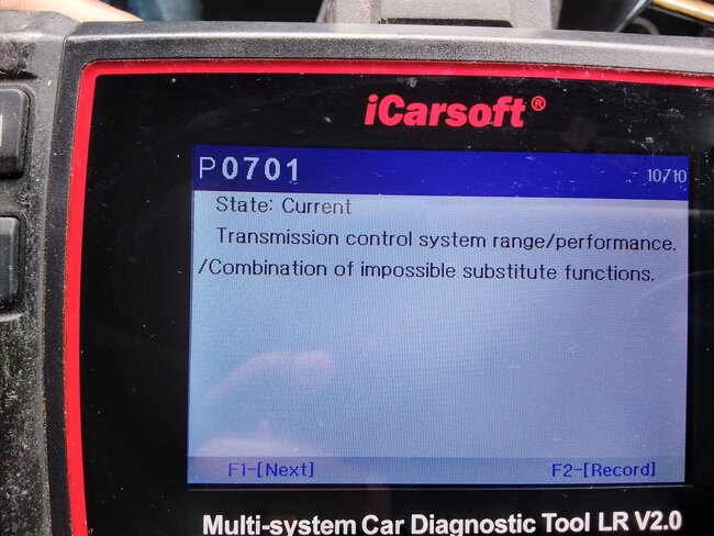

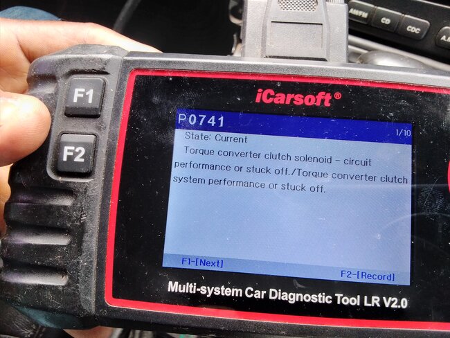

I recently changed the transmission filter and oil. I drove the car for 3 days but now the transmission is not selecting, and the car is not moving . Do you know what can cause this problem?

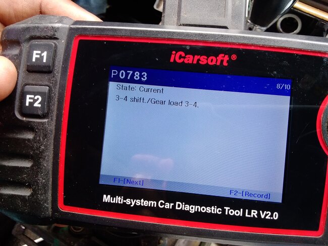

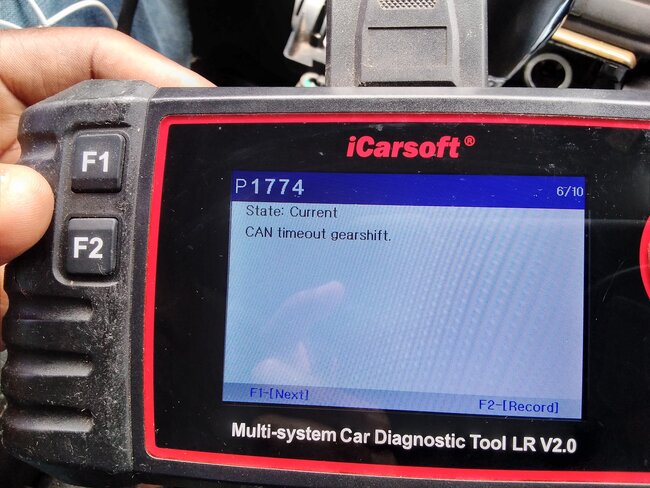

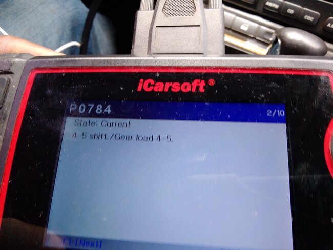

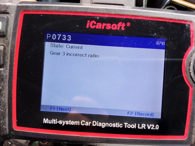

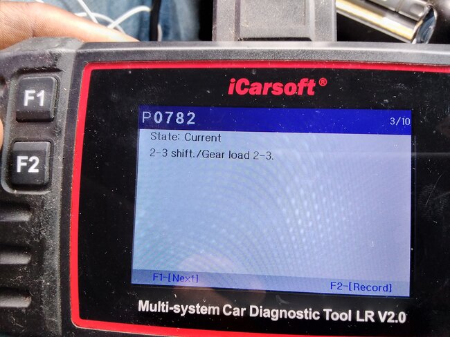

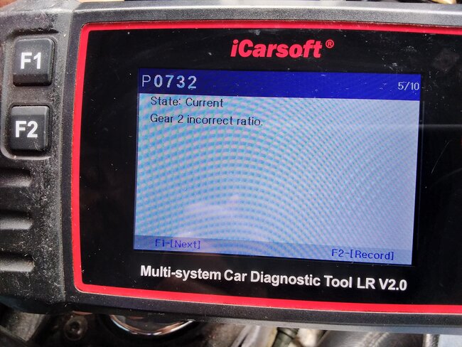

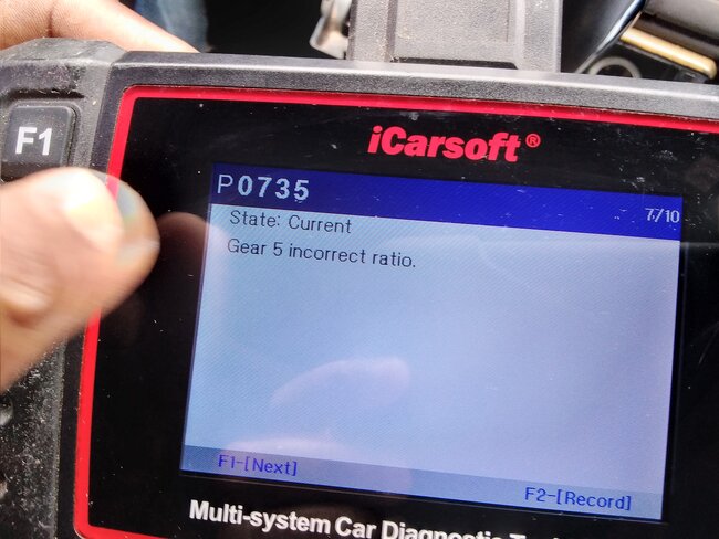

Hello, I also used a diagnostic computer on the car, and I found some codes that I don't understand. Can you please tell me what these codes mean? Please see images of codes below. Thank you for a speedy response.

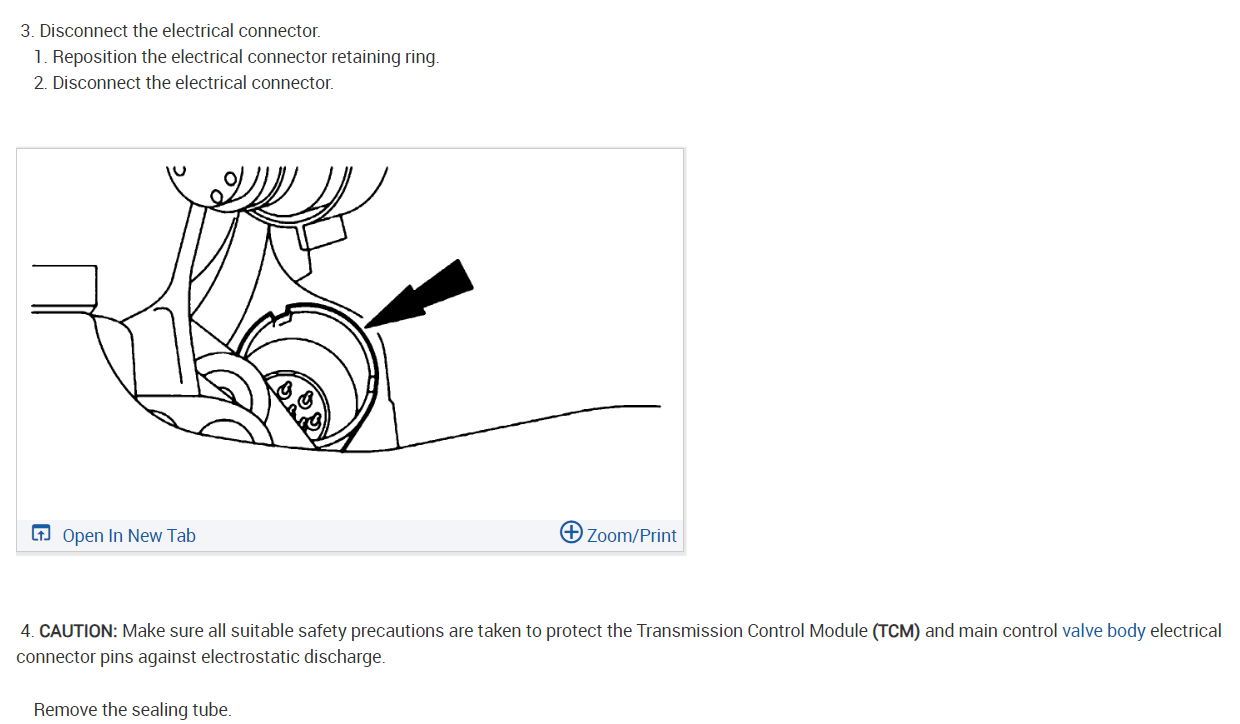

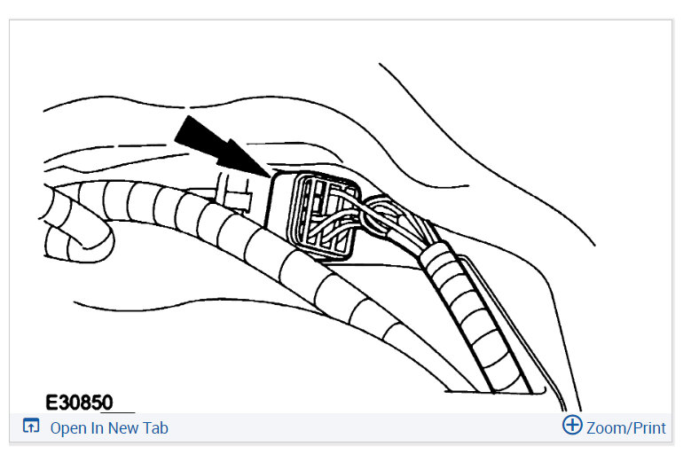

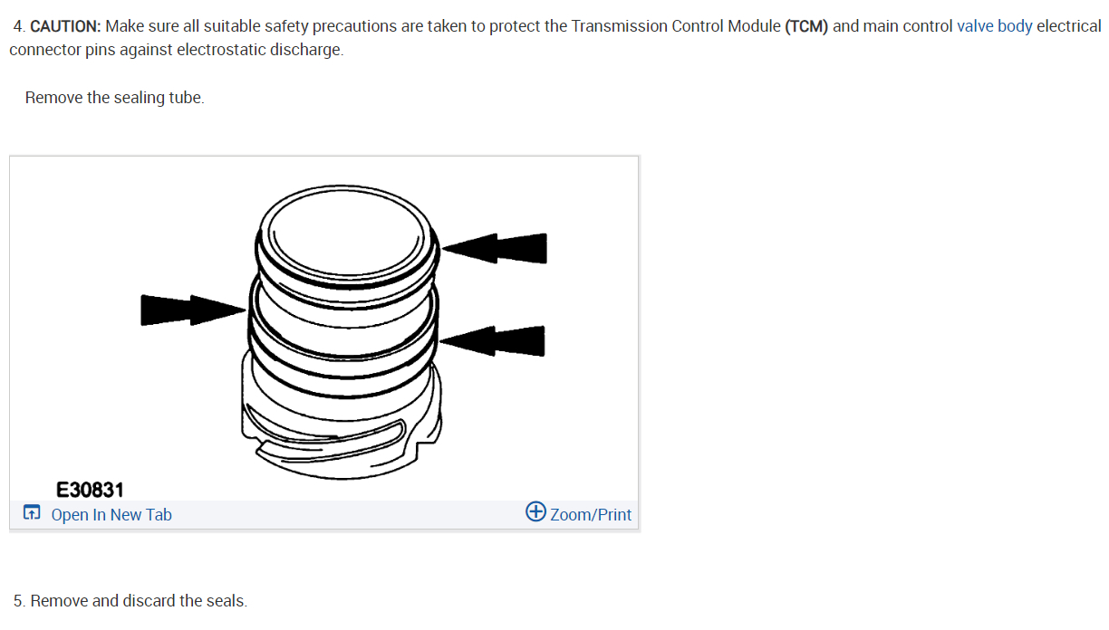

Yep, it looks like the electrical connector at the transmission must have gotten bumped or is not connected correctly during the transmission service. Here is the location so you can check it out. Clear the codes once the problem has been corrected. Check out the images (below). Let us know what you find.

Thank you for responding. Is this the answer to the first 2 questions about the codes I found as well?
Jul 29, 2024 at 3:58 AM
  • 55,433 POSTS
Yes, it will have all these codes at once because of the electrical connector.

Hello Ken, I checked the fuse, and I don't see anything wrong with them.
Can you please send a diagram showing where the electrical connector is connected to on the transmission?
Do you know where the torque converted clutch solenoid is located?
Thank you for assisting.
Jul 29, 2024 at 10:09 AM
  • 55,433 POSTS
That's all they show us, if you look at the transmission you should be able to see the wiring connector. Please start a new question for the torque converter clutch solenoid.

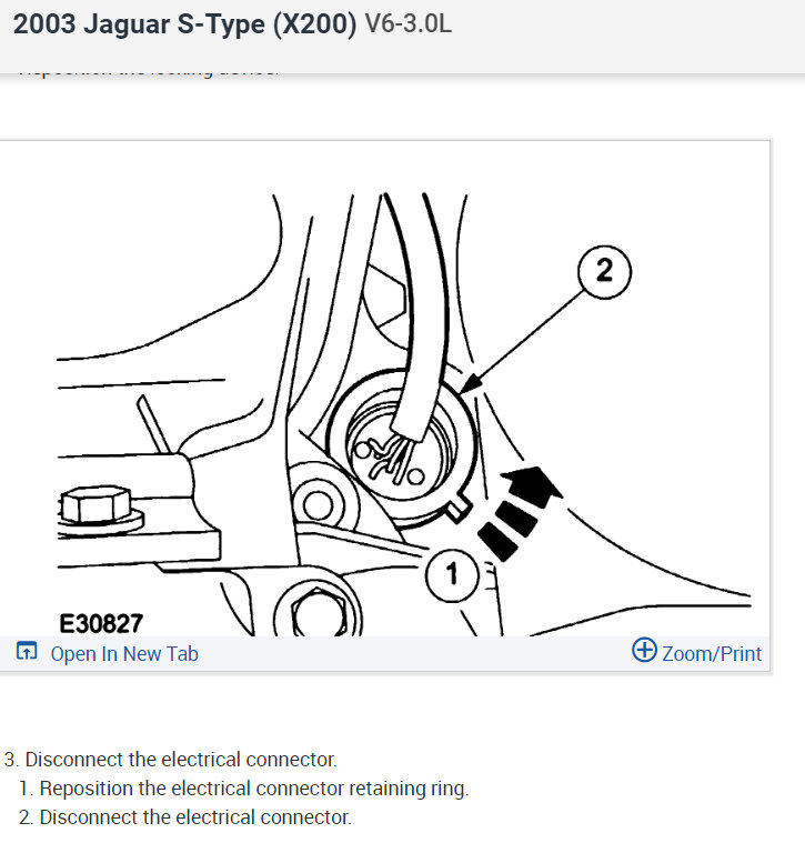

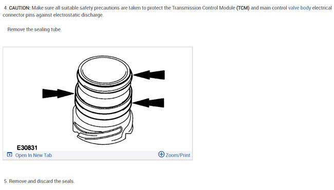

Here is a better shot of the electrical connector. Check out the images (below). Let us know what you find.
