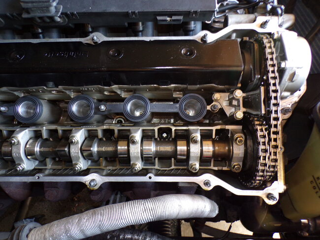

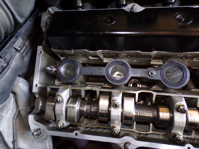

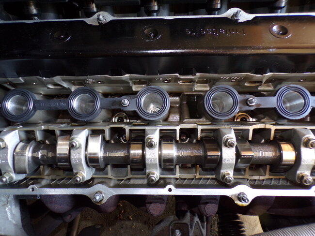

One of the steps that we discussed to do was to change the valve cover gasket. I did this today and boy was it clean inside where the cam was. Here are three images to show you. The old gasket was pretty hard and stiff. I also changed the gasket material where the spark plugs go. The clean lines is probably due to me using Auto-RX, a fluid patented by an American and designed to clean the varnish off of the metal within the engine.
Tuesday, October 11th, 2022 AT 6:20 PM
  • 110,192 POSTS
Wow! Everything looks new. I never heard of the product that you mentioned. I am going to look for it.
Tuesday, October 11th, 2022 AT 7:33 PM
CHRISTOPHER SA
  • 260 POSTS
Here is the website: https://auto-rx.com/
I purchased two bottles. When you read up on it, you'll see why. Brilliant product - but stick to their instructions!
