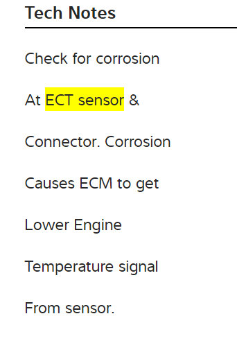

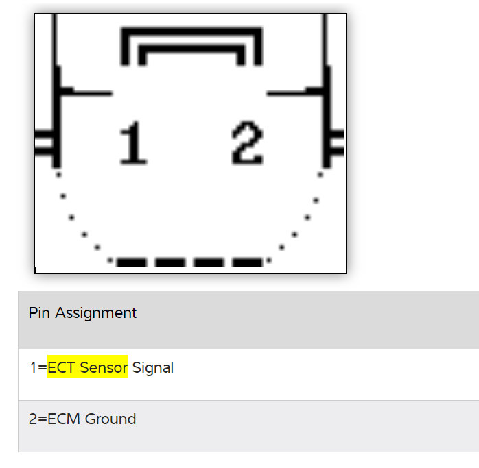

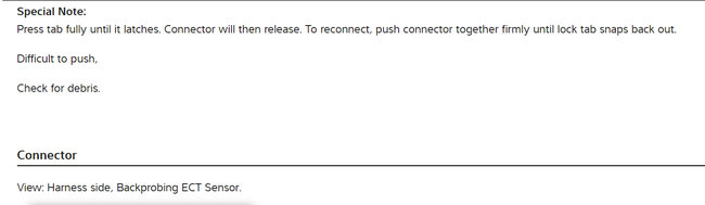

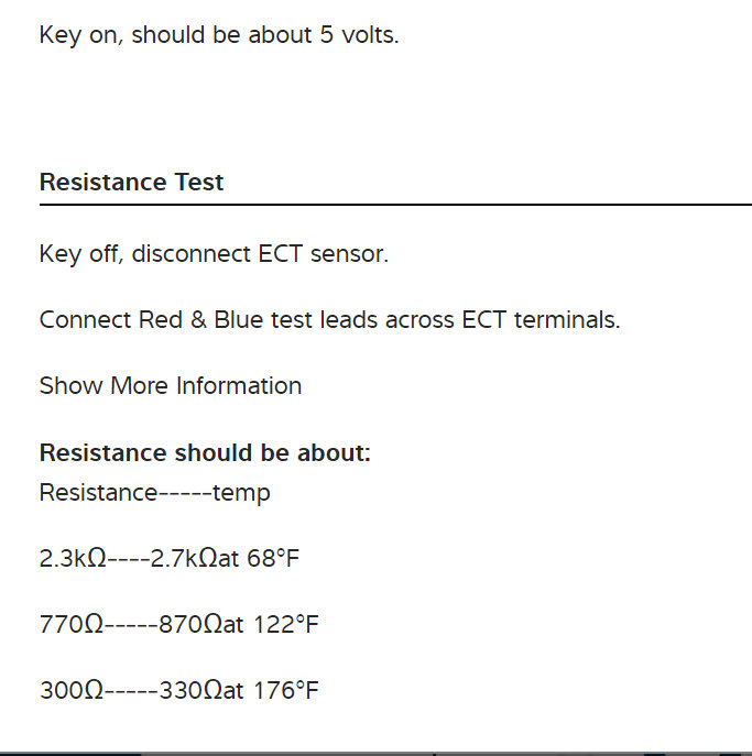

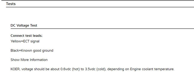

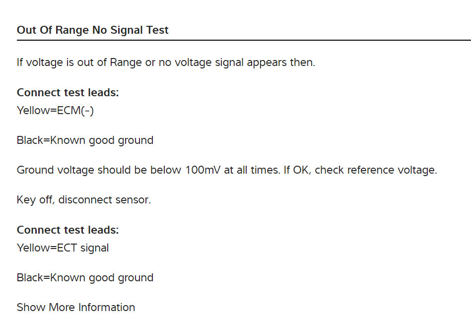

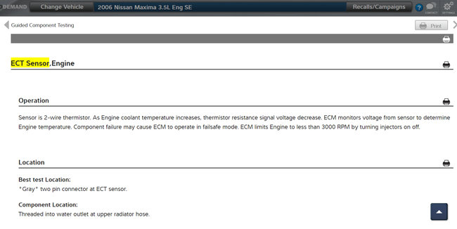

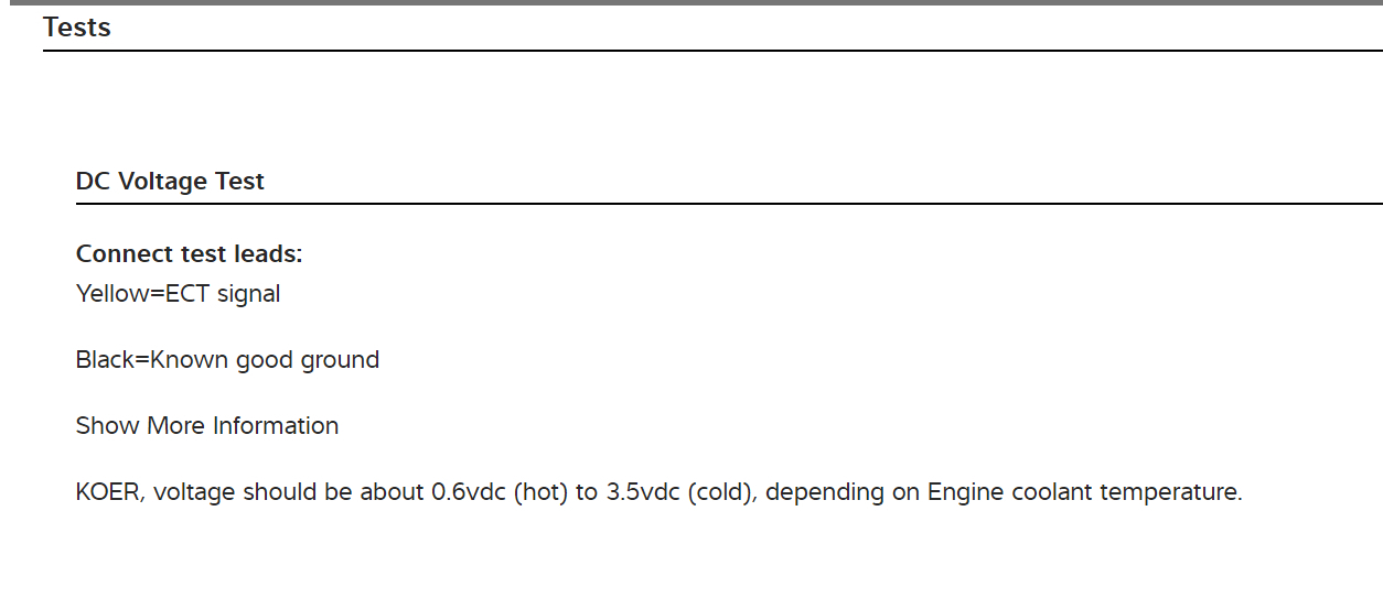

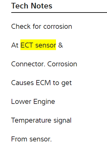

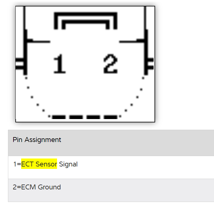

Have you tested the ECT sensor itself? I have included a step by step test for the ECT in the diagrams down below. Please go through it and get back to us with what you find out.

Friday, March 15th, 2019 AT 12:40 PM

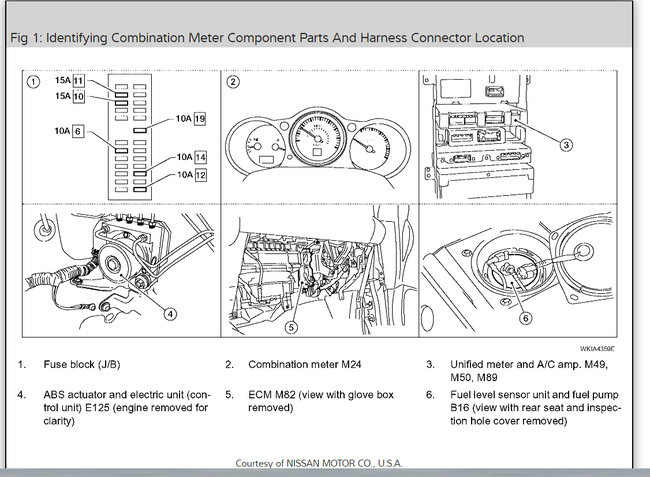

Went to repair shop try to find out why it’s running hot, but the mechanic said regardless of temperature gauge reading hot the engine bay is not hot. With 82 thermostat upper hose reading shoes 86dec and lower shower 78dec when the fan turn off. So it’s operating normal. After this what I have notice on highway running hot is when I punch on cluster twice gauge bounce up punch again bounce down to normal and and few second again gauge needle going to hot. The other things on cluster; fuel gauge, tachometer and speedometer when I punch near them they don’t bounce up or down. So now why only the temperature gauge bounce while punch?

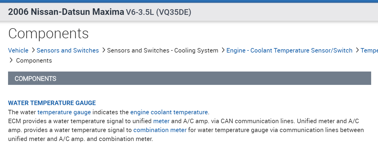

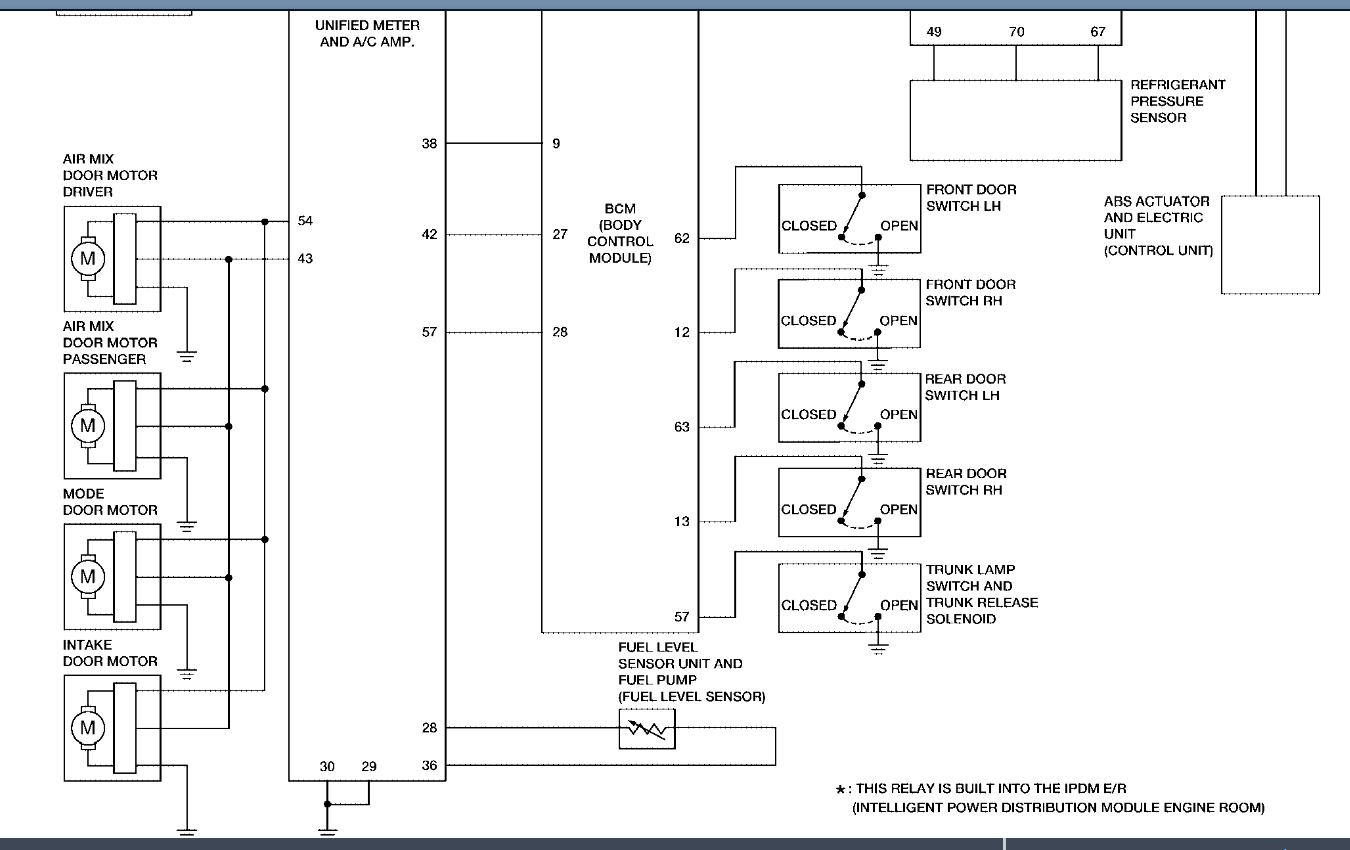

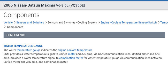

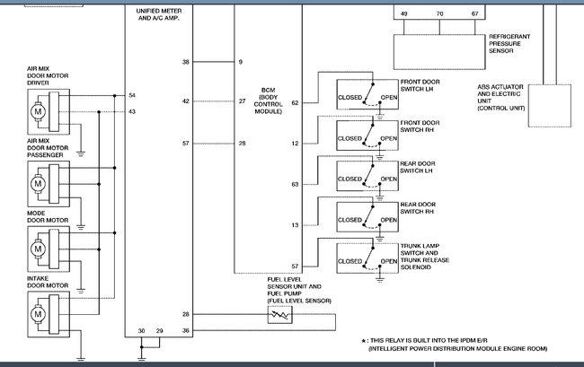

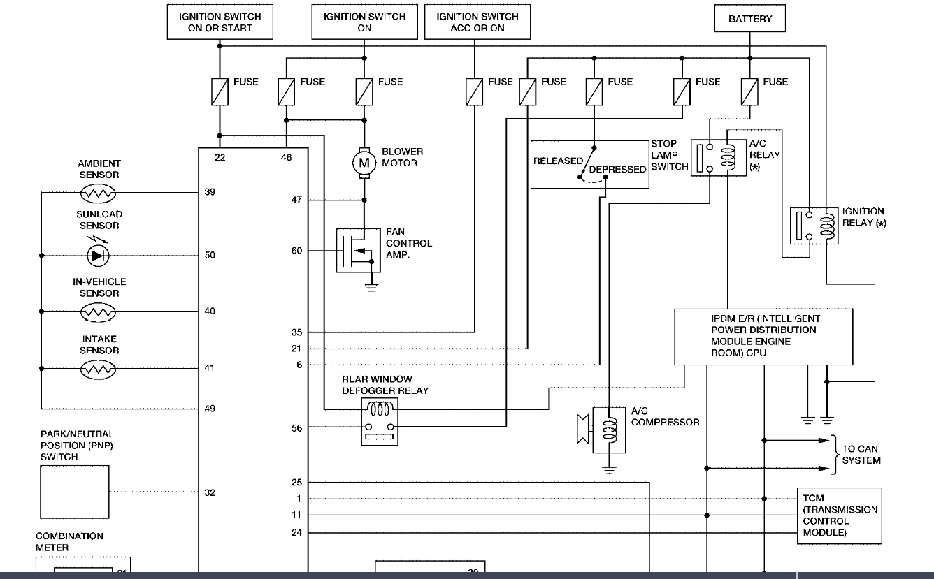

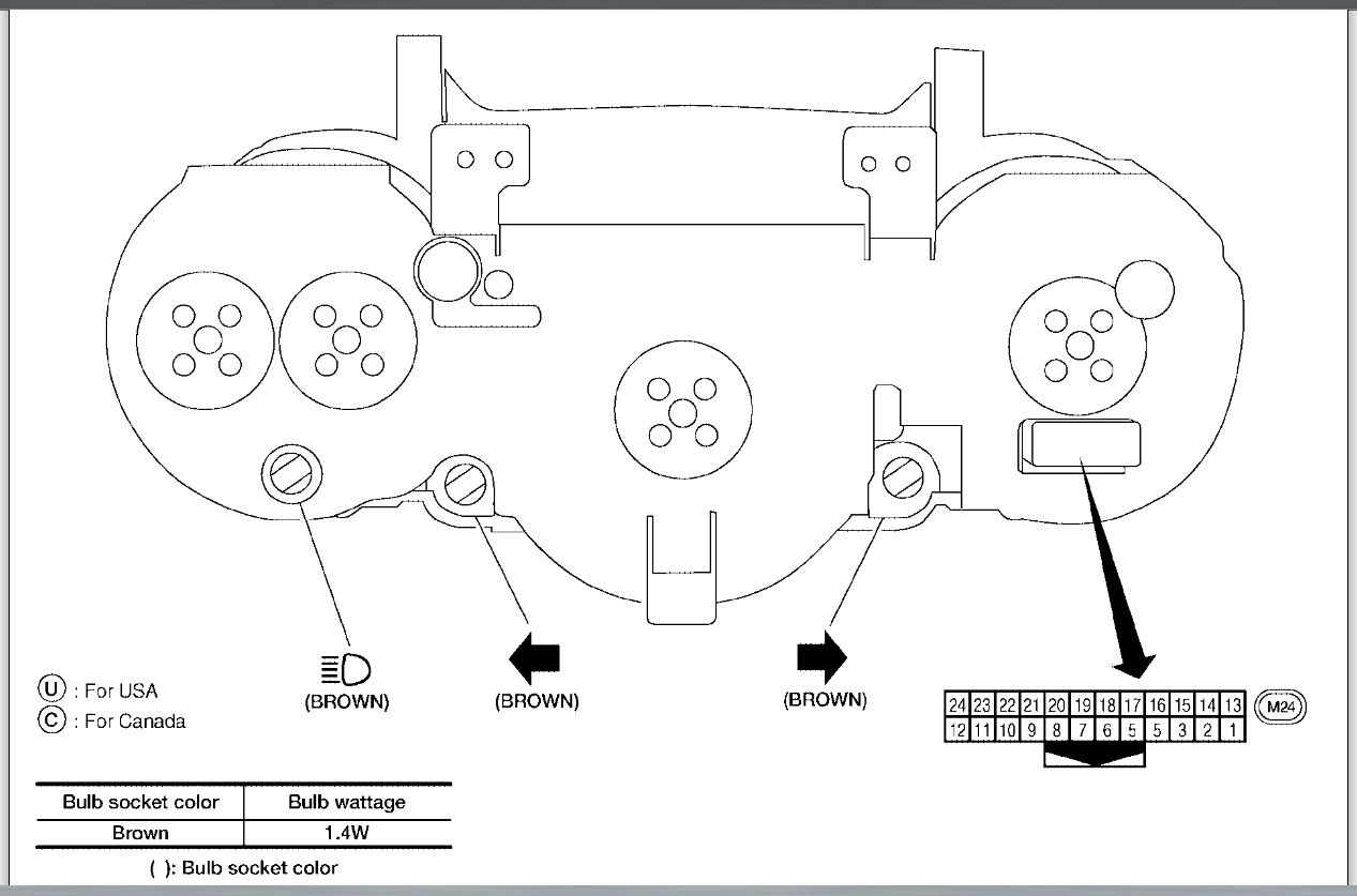

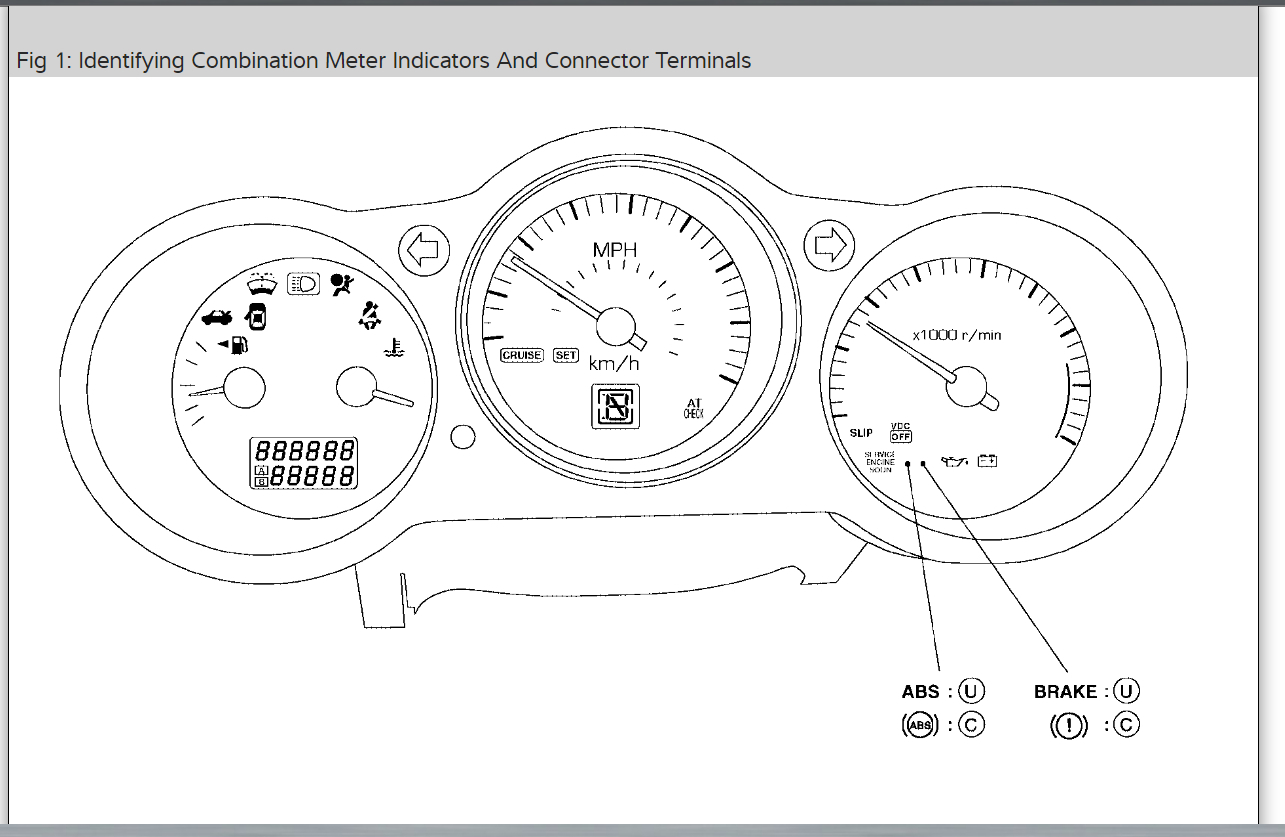

It sounds to me like the combination meter in your instrument might be going bad or you could have a loose wire or loose connector going the combination meter off of the BCAN. In the diagrams down below I have giving you all the information I could find on the temperature gauge for your vehicle. Please go through them and get back to us with you find out.

Yes, it’s a bad cluster. I noticed myself when I cold start and didn’t blink my eyes from temperature gauge. What I noticed just suddenly in second gauge bounce to full hot side and cold side. So either it’s a sensor or a cluster itself is bad. So I thing I want ask, on top coolant outlet hose there are two sensor one with two wires if I remove it the radiator fan start at full speed and then one sensor with only one wire on it which I can’t remove? It’s stuck what is that one wire sensor for?
And sorry the last pictures diagram you sent me is not for my car. Mine is different for Gulf spec compare to USA Canada or Japan.
Tuesday, March 19th, 2019 AT 8:42 AM
SCGRANTURISMO
  • 4,897 POSTS
Hello again,
The one with one wire is a sending unit going to the gauge in the dash. The one with two wires is a sensor going to the PCM. Let us know if we can help in any other way.
