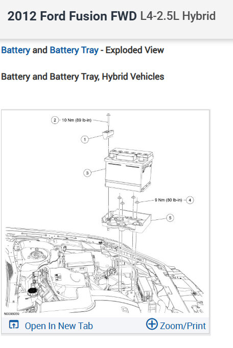

Everything comes on but turn the key and absolutely nothing happens.
Dec 12, 2024 at 2:56 PM
  • CAR REPAIR CONTRIBUTOR
  • 54,415 POSTS
Yep, this is common when the 12-volt battery goes dead. I would remove it and have the auto parts store load test it for you and get you a new one if needed. Here is how in the diagrams below. Make sure all switches are off before you begin. This guide can help walk you through the repair safely:
