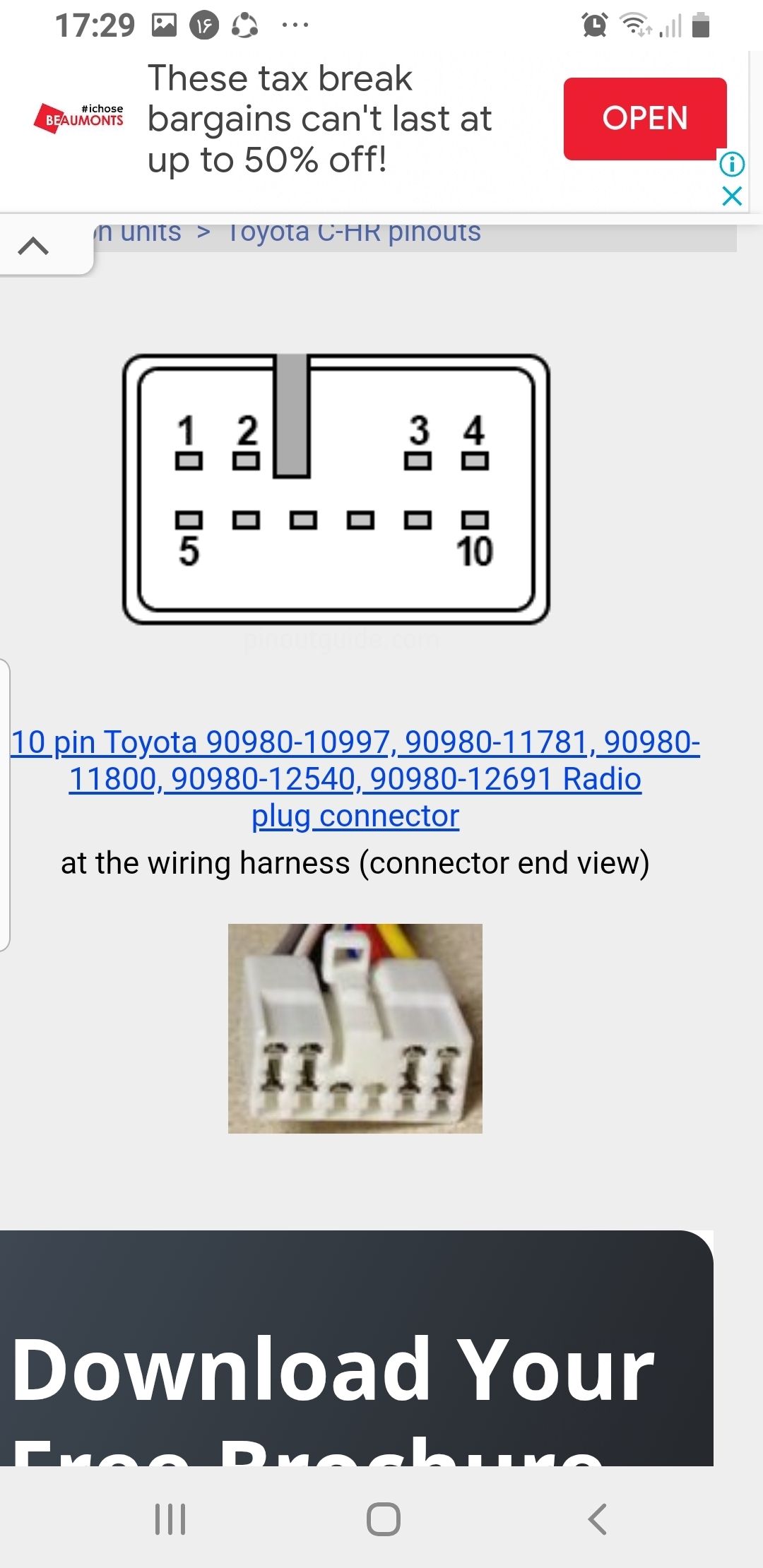

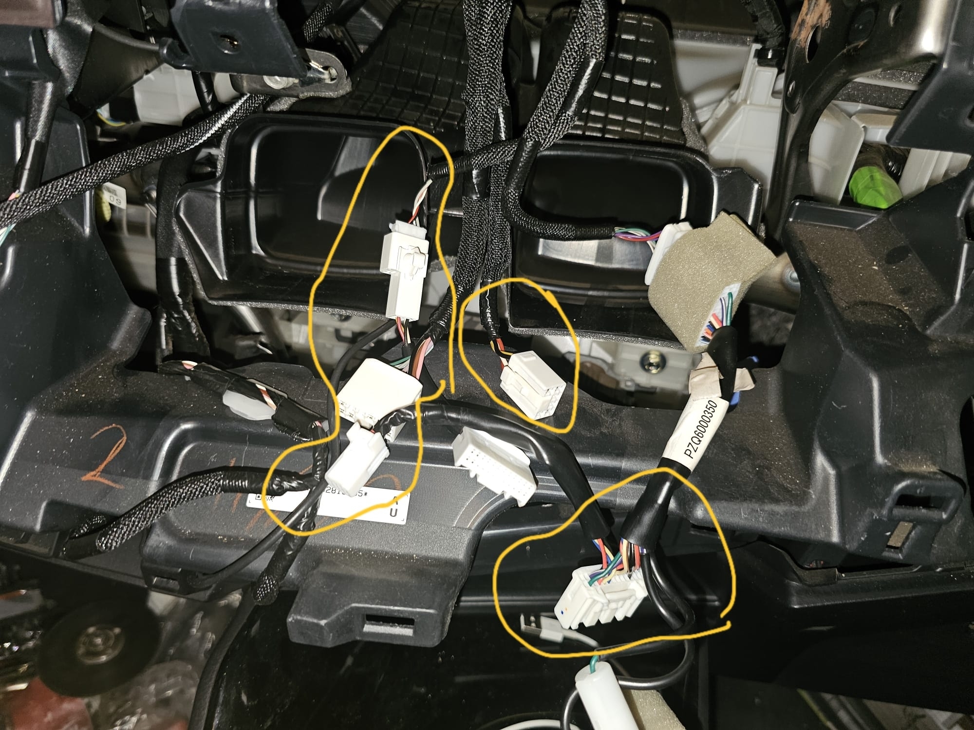

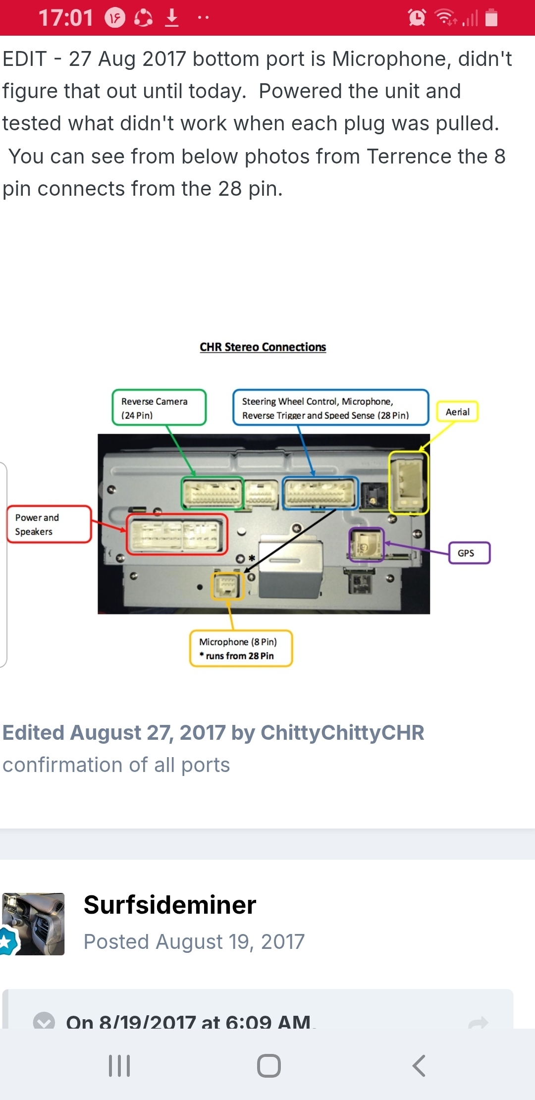

I am looking for a wiring diagram for a 2018 Toyota CHR. More specifically I need the one for the 10 pin and 6 pin connector that plugged into the back of the factory unit. I am looking for the wire diagram so I can properly connect my new navigation unit.

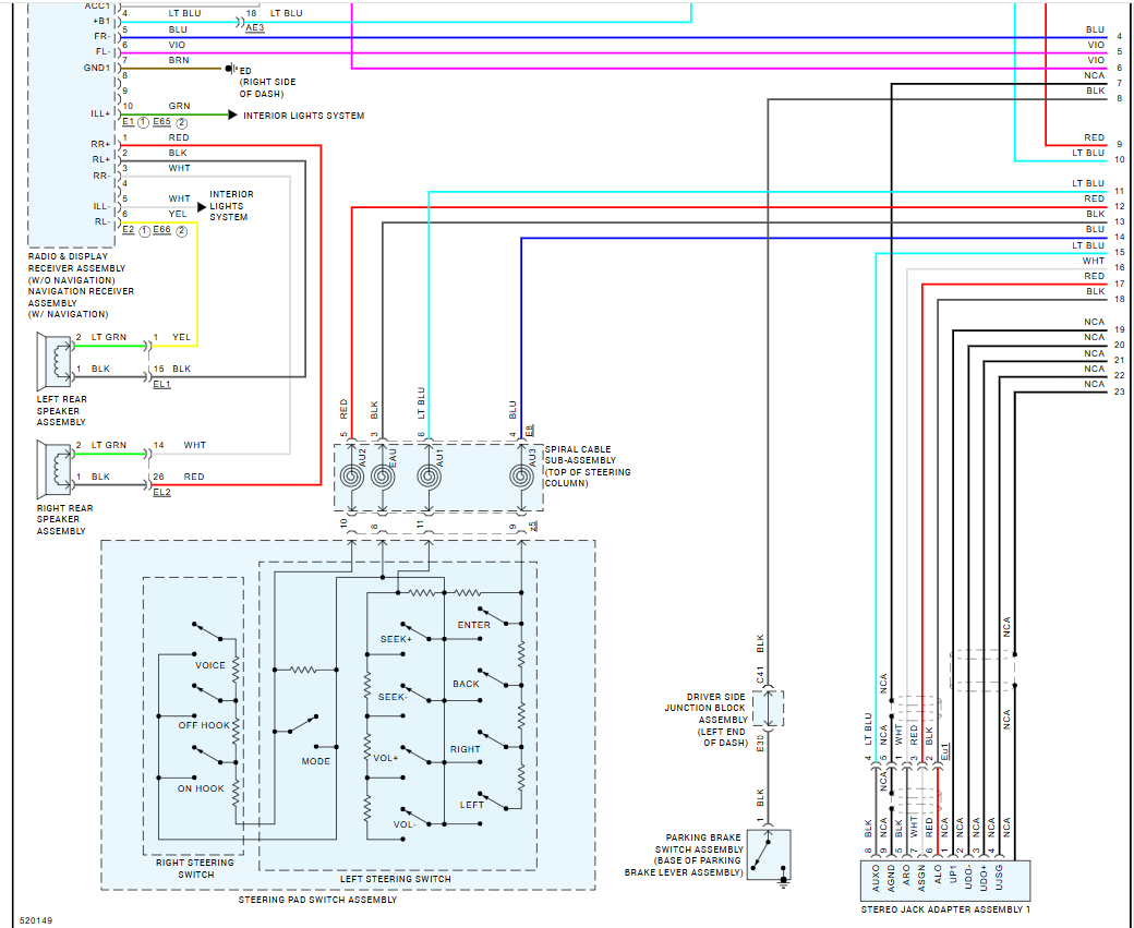

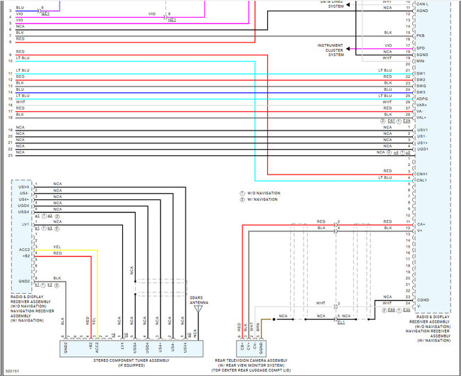

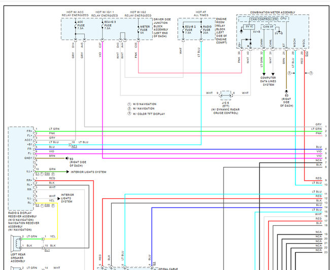

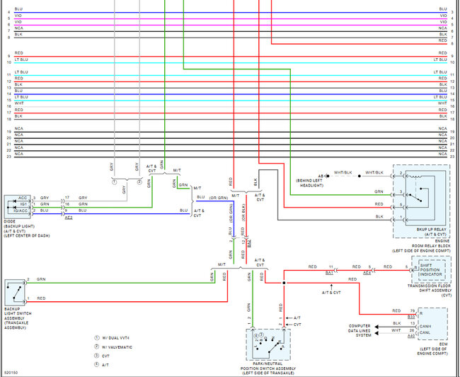

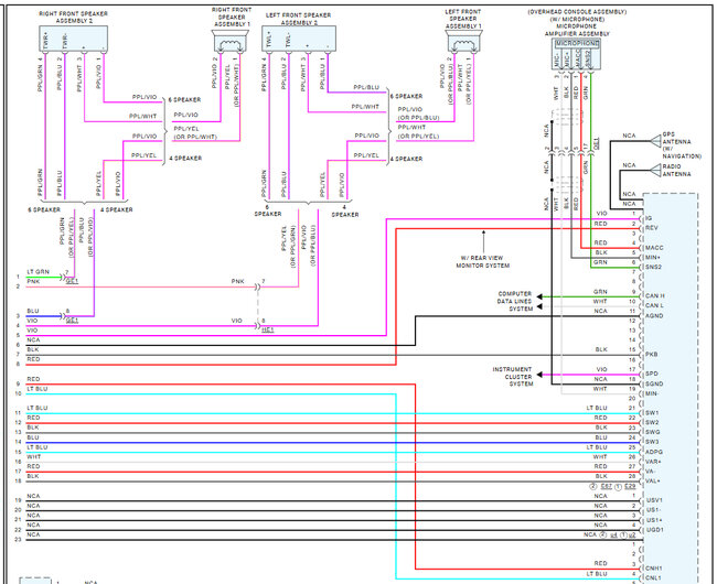

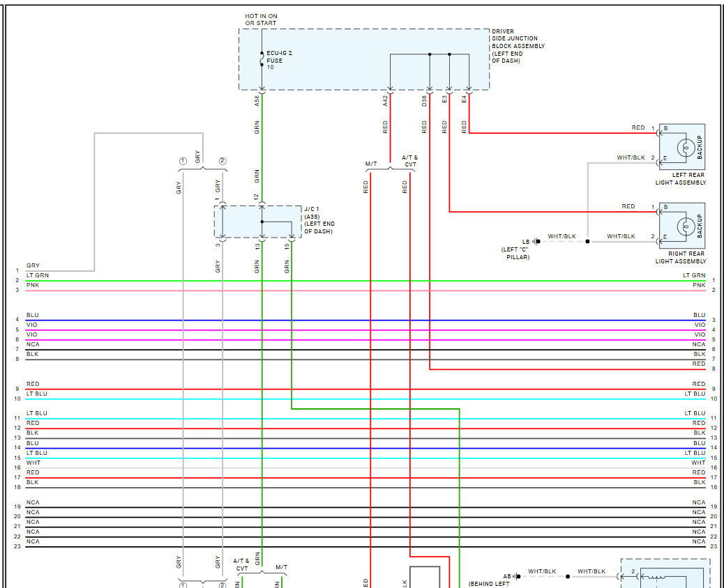

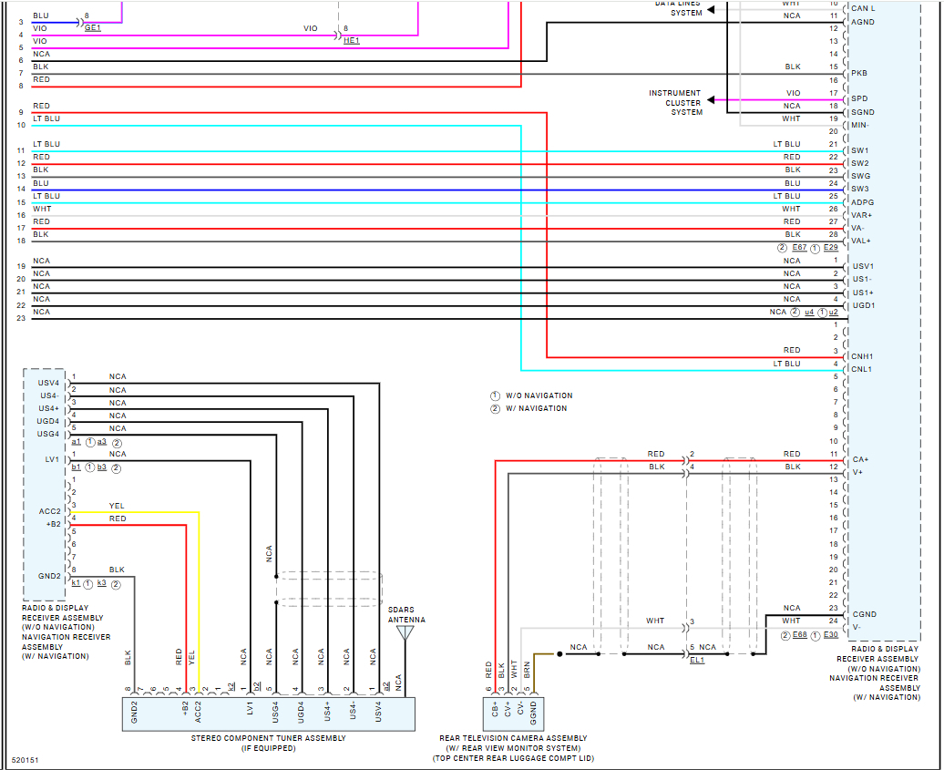

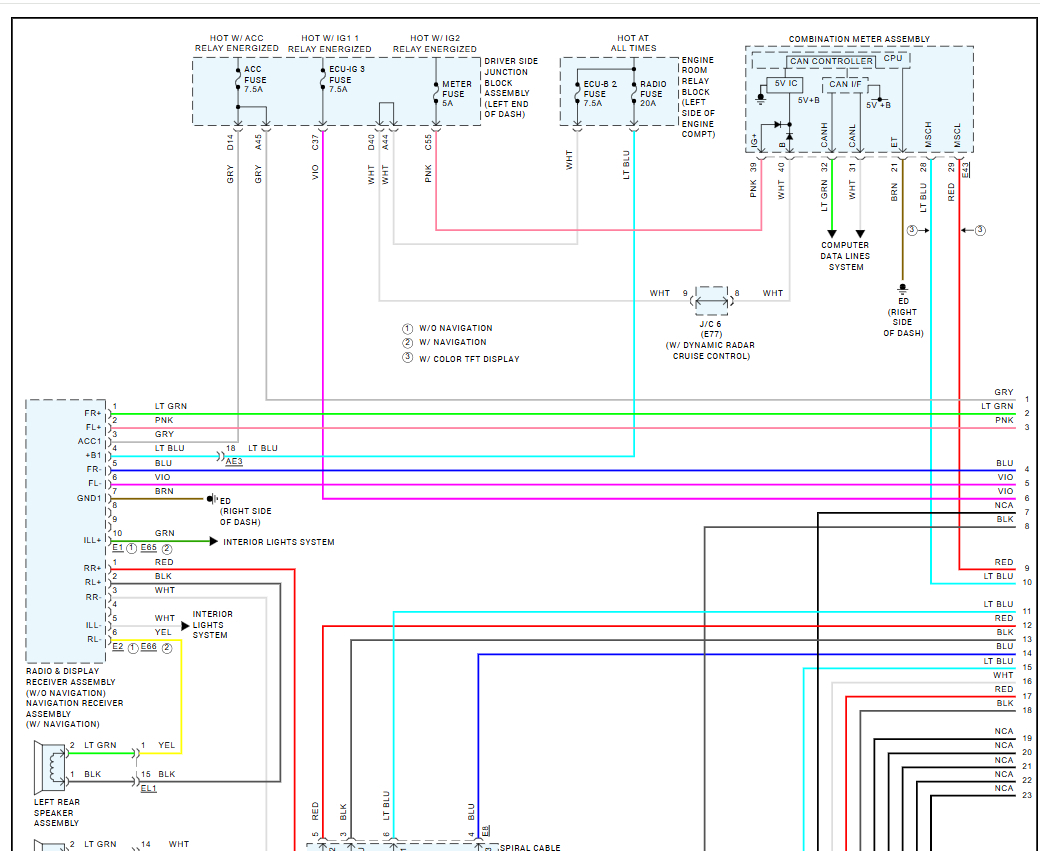

Here are the radio wiring diagrams as requested, check out the images (below). Let us know if you need anything else.

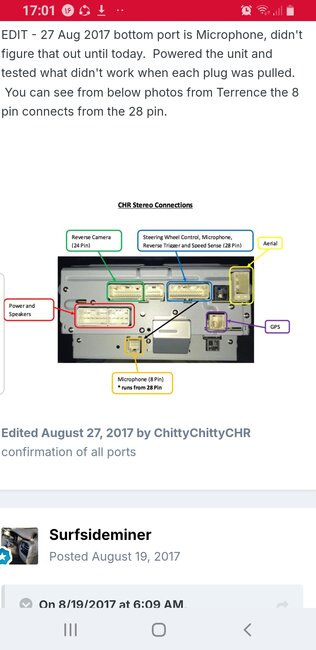

Thank you for replying to my enquiry.
I want to know what each of these colored wires are?

You will need to match the wiring to the diagrams above to see what each wire does. There are a few options as well so if some of the wires don't line up, I will look into other diagrams for you.
