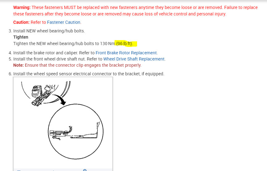

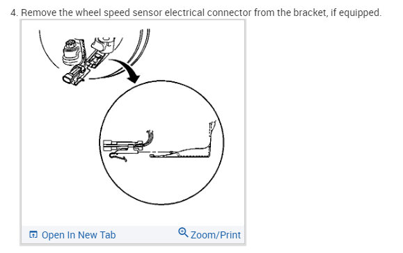

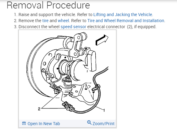

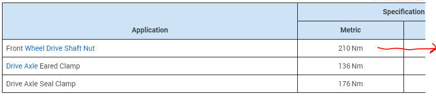

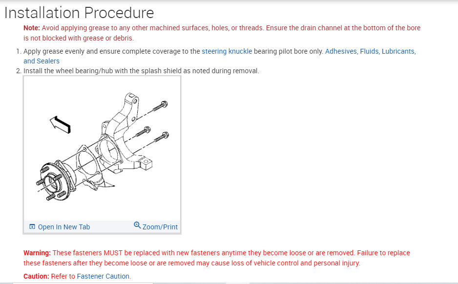

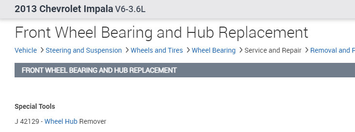

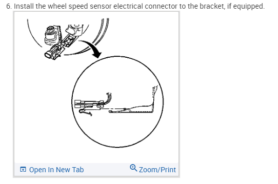

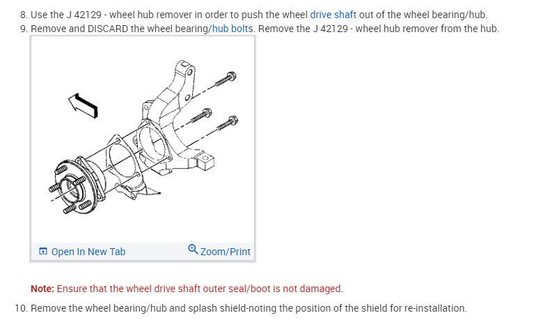

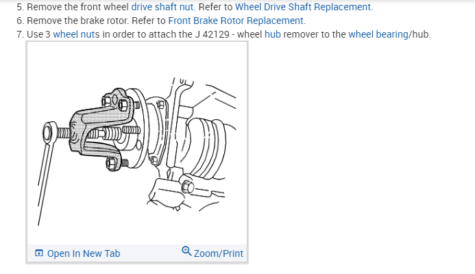

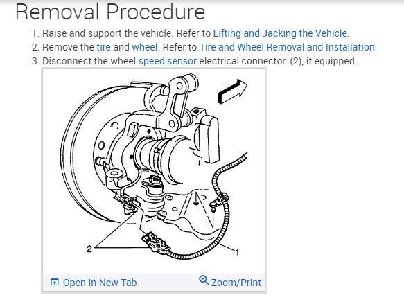

As far as the noise, did you properly torque the hub bearings and axle nut?

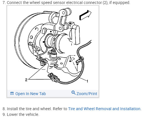

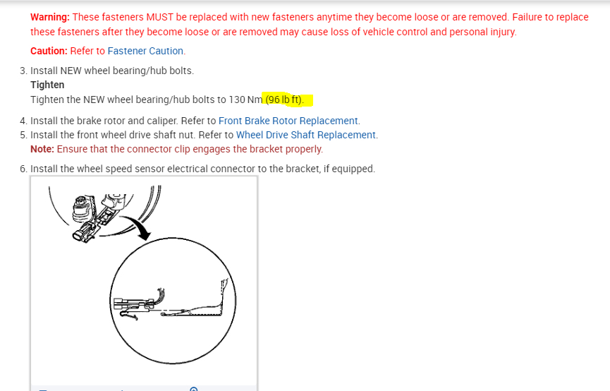

I attached the directions below along with the torque specifications. Take a look through them and let me know if anything was missed or if the torque specifications were not reached.

Mine didn't need the wheel hub assembly puller. It was a 34mm socket to take the nut off then 3 bolts in the back. Or am I misreading but I didn't use a torque wrench heck could barely get anything on the bolt.

If they all came on at the same time, chances are there is an issue with one of the wheel speed sensors. That would cause all of the mentioned lights to turn on.
So, we need to figure out what is causing it. The new bearings would have come with new wheel speed sensors. Therefore, something is likely loose and may have damaged the sensor.
Where did you have a hard time getting a wrench? When you had the axle out to replace the hub assembly, you should have had plenty of room to tighten the bolts onto the steering knuckle. As far as the axle nut is concerned, that is easily accessible as well. Also, the axle nut's torque is substantial. You really need a torque wrench to tighten it. I've seen people use impact wrenches, but the vehicles were usually back within a month with issues.
What I recommend is to check with a local parts store for tool rental. Most will lend a tool at no charge. Get your hands on a torque wrench and make sure what you have done is tight enough. Please keep in mind, the sensor portion of the assembly, which is integral to the hub bearing assembly, may be damaged and need to be replaced again. In most cases, the parts store will cover it under warranty.

The bolts in the back of the knuckle. I have to use a socket and extension but the socket won't quite slide all the way down the bolt head so felt like wanted to slip. The socket off the bolt head that is. I'll check with parts store about torque wrench. When the lights went off the brakes made a horrible noise sounds like there was no brake pad. That's just what it sounded like. I'm going out to take apart now. I'll let you know thanks.

Lost a steering knuckle bolt. Auto parts stores don't come up when I search for them. Do you know the size of the bolt so I might get it from hardware store? Or should I get the actual part? Thanks

Do you mean the hub bolt fell out prior to you checking it?
Tuesday, November 14th, 2023 AT 2:57 PM
DAVENOOB
  • 312 POSTS
I just took the tire and calipers off and saw the missing bolt. Will have 3 new bolts Thursday and will get a new speed sensor tomorrow.

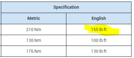

So, it is a real pain to try and read the schematics on my phone. What are the hub bolts supposed to be torqued to what PSI?

I just bought a torque wrench that doesn't go high enough. Is there anything I can do besides return it? I'm going to borrow one from AutoZone but a torque wrench that values are too low is useless to me.
Thursday, November 16th, 2023 AT 3:26 PM
  • 110,192 POSTS

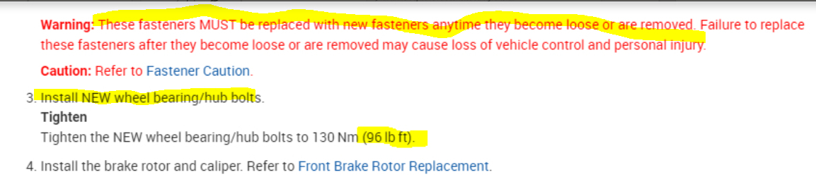

If the torque wrench doesn't go high enough, which isn't a surprise, return it. For this job, the axle nut needs to be tightened to 155 ft/lbs. I suspect the torque wrench goes to 150 ft/lbs. If that is the case, take it that far and give it an additional 1/8 of a turn and you should be fine.
As far as the hub bolts are concerned, they need to be replaced and the new ones torqued to 96 ft/lbs.
