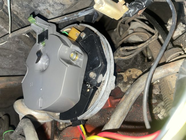

I have a 1980 GMC Caballero with a 5.7 Chevy 350 small block swapped in it. So, it's pretty much an El Camino. I'm having trouble with getting it started. So far, I have replaced the distributor cap, ignition coil, rotor, Ignition Control Module, and the capacitor and connector part that leads from the ICM to the ignition coil.
I don't believe the engine is getting any spark. I have replaced all of the spark plugs, but I neglected to gap them to spec, so I have to go back and do that. However, I have tested for spark with both a tester and by setting an old plug on the side of the engine and cranking it up to no avail.
Any suggestions would be helpful, I'd really like to get this truck back on the road. I'll attach some pictures and videos of the work I've done and my problem. Thanks!

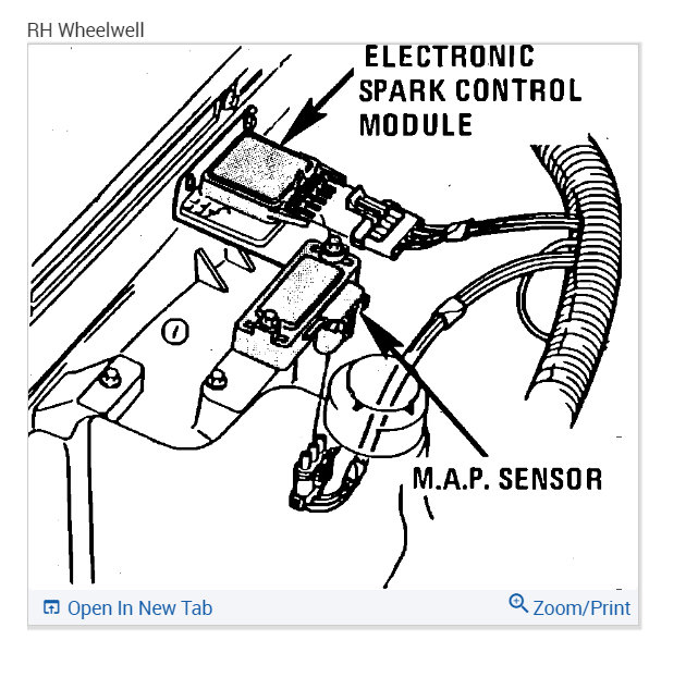

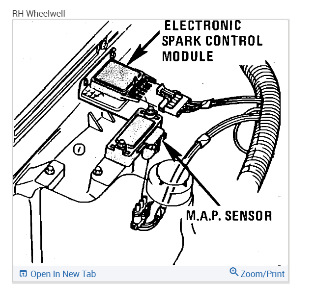

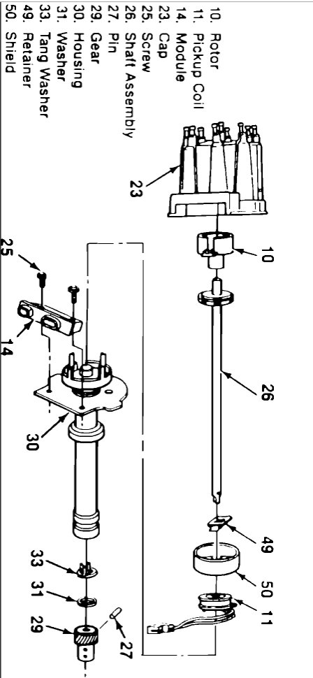

When you turn the key to the on position do you have power at the red wire going into the distributor? This guide can show you how to check for power. Also, there is a ground strap inside the distributor cap that needs to be there, it goes to where the ignition coil is. In the diagrams below it show the spark control module, can you please confirm this is the part you replaced?

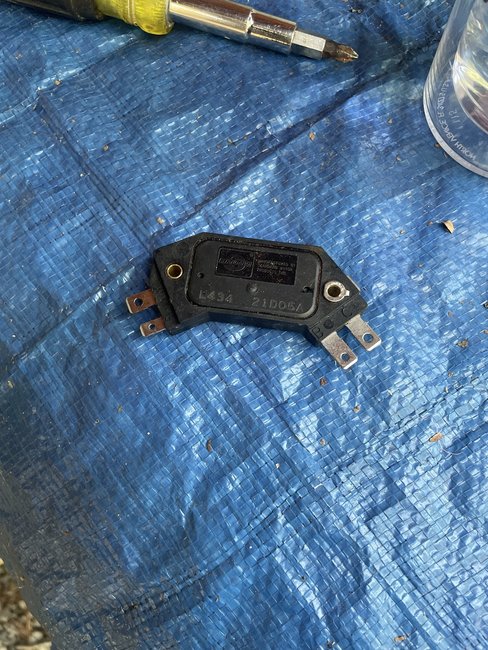

I will attach a picture of the Ignition control module I replaced. It doesn’t look like the diagram I see there, but I could be wrong.

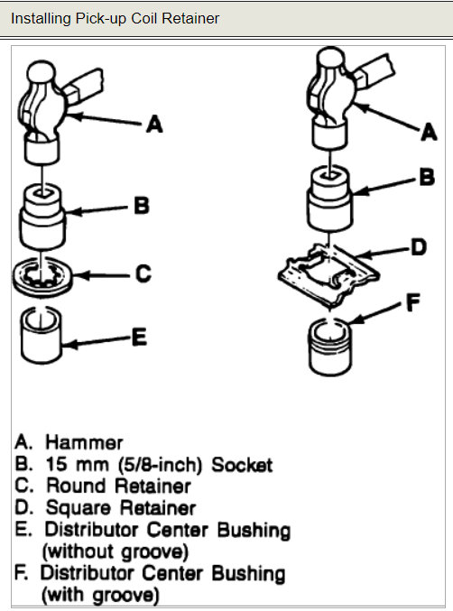

The distributor is rotated mechanically by the camshaft, but it does hurt to have a helper crank the engine over to make sure it turns. Also have you replaced the pickup coil? Here is how.

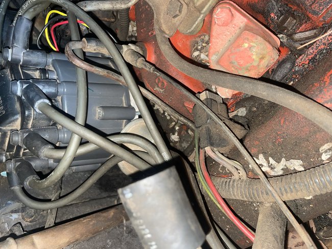

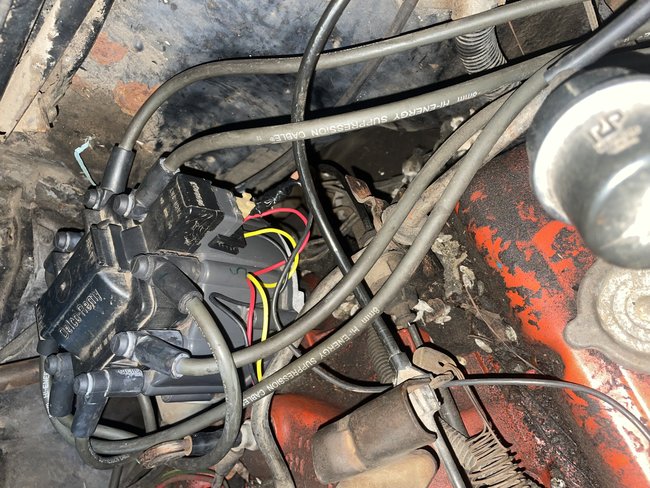

When it comes to testing power, I’m not sure which red wire leading into the distributor you are talking about. I will attach some pictures of the distributor so that maybe you can point me in the right direction.

The red wire should have 12 volts with the key on.
