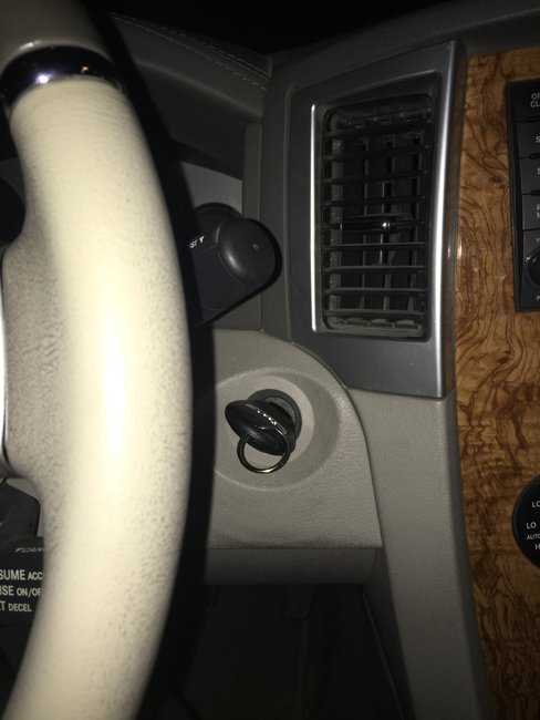

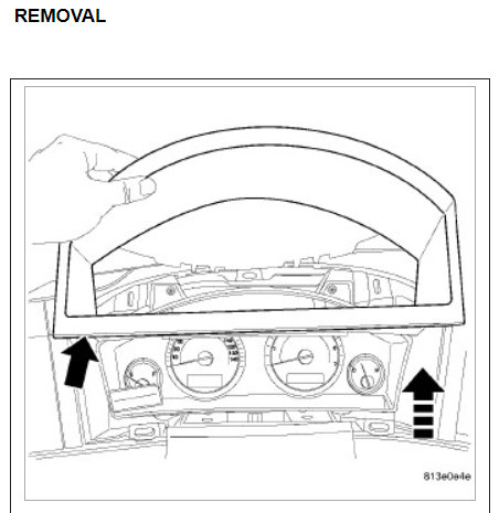

Hi, I have put the key into the vehicle but it will not start the car and now the key is stuck and will not come out. I tried turning the wheel and getting the key out but that will not work either. The vehicle has no signs or lights of it working and the key is not working. What should I do?

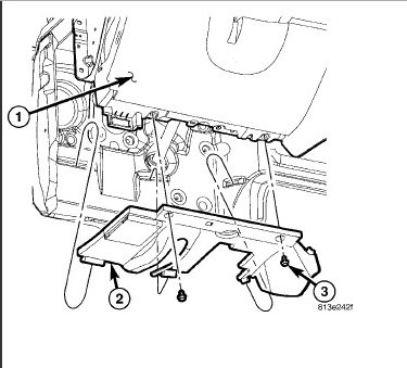

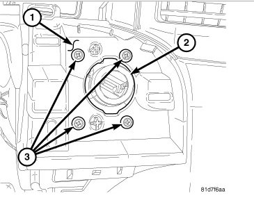

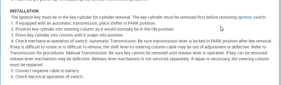

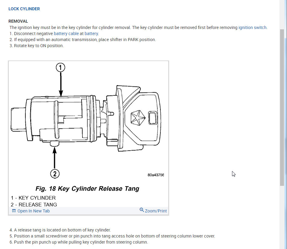

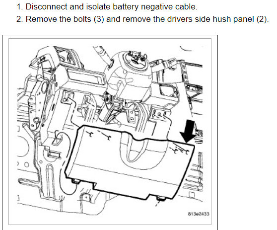

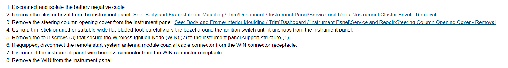

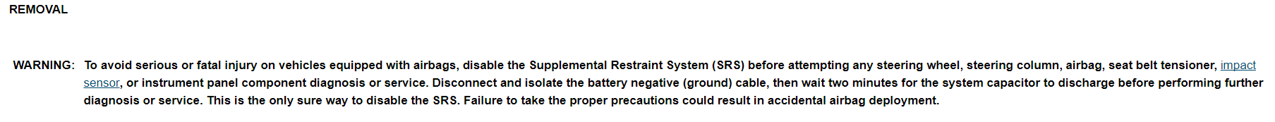

What happens in the lock gets jammed up which sometime you cannot get to come loose. I would try some WD40 in the lock and let it sit then work the key up and down back and forth to see if it will come out. If so see how the key works now that it has lube on it. If the key seems too far gone you will need to replace the ignition tumbler and switch. I do not think those cars have a chip in the key if it does the dealer will need to program it for you. Below are diagrams of the how the job is done.
This guide can help as well:
