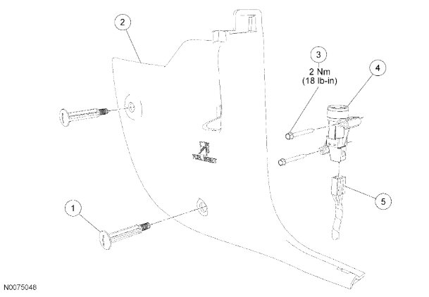

my 2008 ford focus was starting and running fine but it is stuck in either 3rd or 4th gear it is a manual and also now it is turning over but it's not starting and I am about at my whits end on what else to try with it
Aug 13, 2025 at 8:17 PM
  • 54,494 POSTS
Hi Jennie,

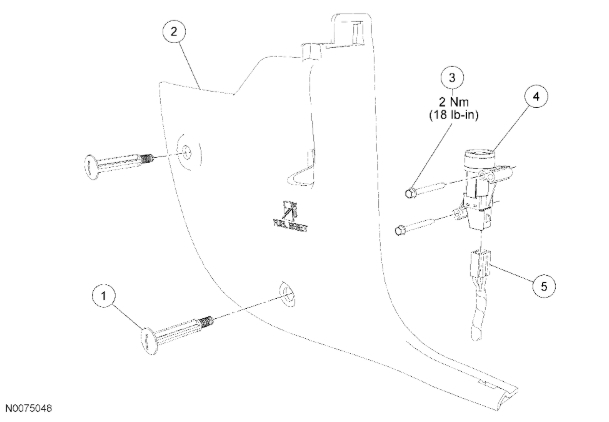

So we only handle one problem per thread, we will fix the not starting problem on this thread. Please start a new thread for the "stuck in gear" issue. Can a ask if it will run on starting fluid, if so the fuel pump could have gone out or the inertia switch got tripped. I would check that first. Here is a video and the switch location so you can see if the it needs to be reset. Please what this video as well
