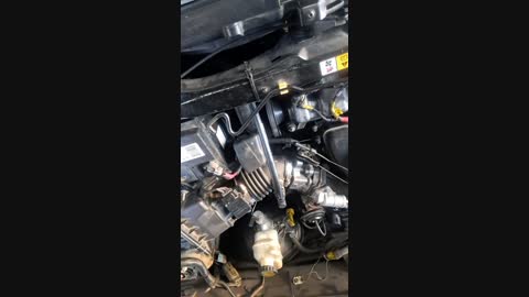

After someone did 6 sparkplugs, on my V6 3.0L it's making a clicking/knocking sound. A 3 party said his diagnostic tester says Bank 1 and 2.
Where exactly are these located and other than putting eyes on it and checking they're fine damage wise, how else can we know if they're good?
Is this fuel and O2 sensors? Ect?
Could it just be a hose or hoses?
What do we need to do so that we're not stranded?
Thank you!

Bank 1 and bank 2 are both sides of the engine so it does tell us much. Do you have a check engine light on? If so, this can tell us which cylinders are having the issue. It sounds like something may have dropped down into the engine or one of the spark plugs is loose. Can you please shoot a quick video with your phone so I can hear the noise? That way I can tell for sure what's going on.
Here is a guide to help get the codes:
Please go over this guide and get back to us.

If I can hear the noise while cranking I can tell you if the engine is hurt or not? If you have an exhaust leak it will give you oxygen sensor codes. Please check out this guide for more info:
https://www.2carpros.com/articles/repair-lean-mixture-codes-p0171-or-p0174-on-some-manufacturers
Please upload pictures or videos in your response of any problems so we can see what to help you with.

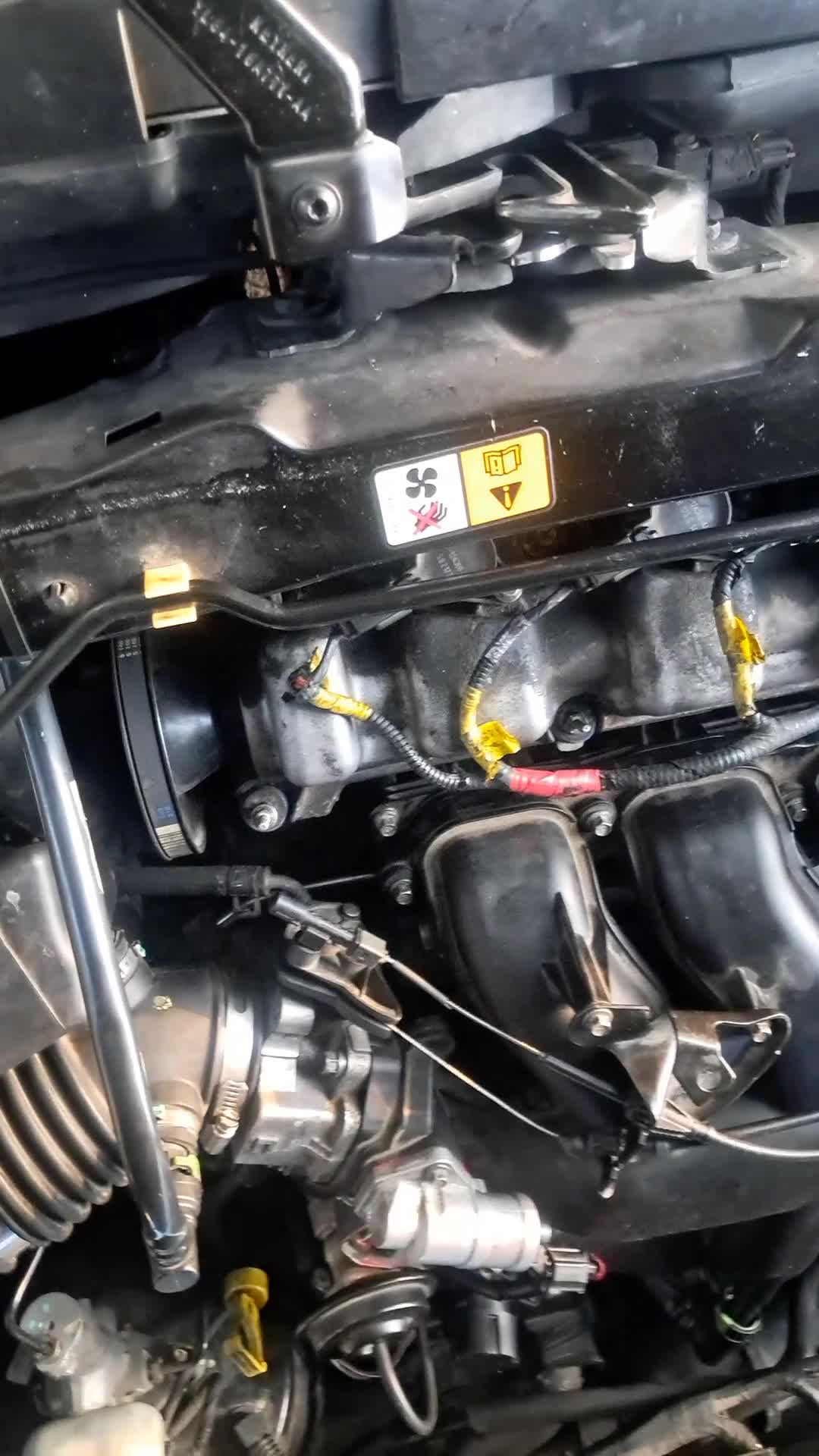

After he messed with the vacuum hose it does this. Battery is 1yr old. But they kept draining it connecting a light (called POWER INVERTER) a friend jumped my battery.
FYI, New parts:
Fuel rail sensor wire
Spark plugs
Starter
Vacuum sensor (both)
ERG vacuum solenoid
Valve cover
Intake gasket
Tensioner pulling
Idler pulley
Fuel filter
Oil pressure sensor and plug
All the vacuum hoses
idk if I need Mazda for:
ECM control module I don't know if it has to be programmed by dealership
My car,
Mazda tribute 06 3L V6 Front wheel drive
Monday, September 30th, 2024 AT 6:38 AM

It sounds like the engine still has compression, which is good, but now this post has turned into a different problem. Can you please upload this video into a new post that the engine will not start after the battery was jumped backwards?
Tuesday, October 1st, 2024 AT 9:42 AM

Mazda tribute 06 3L V6 FWD
Vehicle won't start after vacuum hoses where re-checked. Before hand, the engine would turn on but try and die, but continued to stay on if you have it some gas when it was about to die. I'll post a video with the sound it now does.

The sound I'm getting rn
