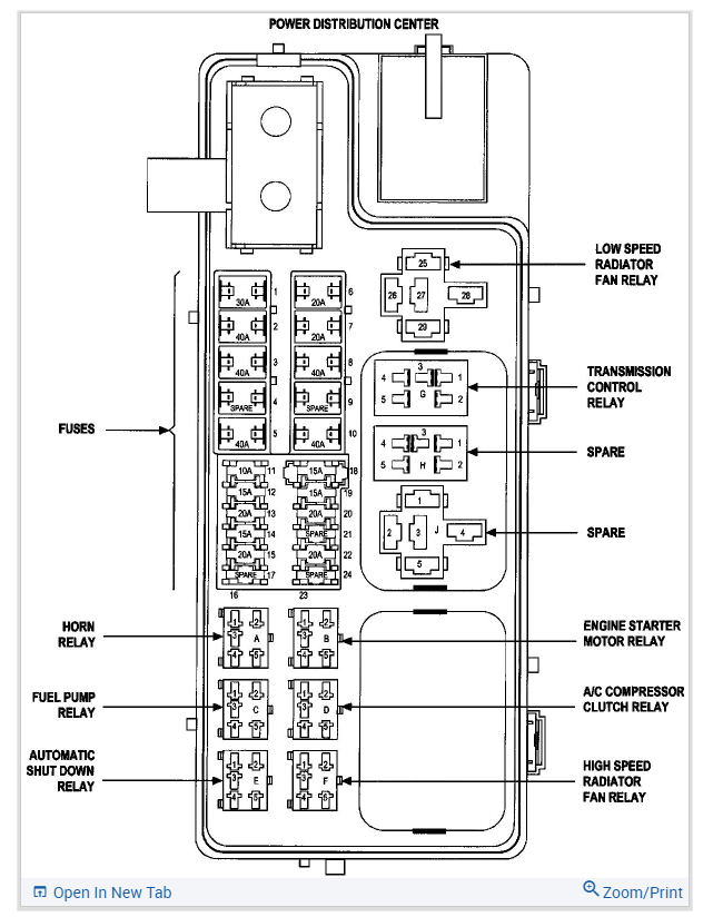

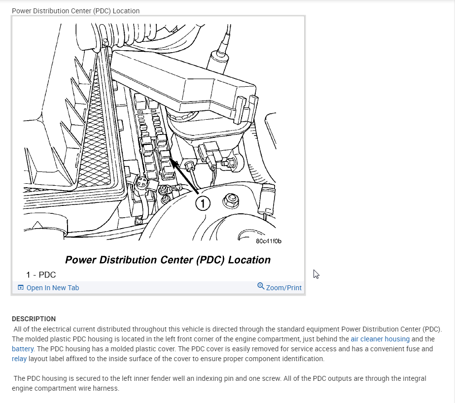

It is unlikely that the low oil level caused the engine to stall and not power back up. This is more than likely an issue in the PDC or with power to the PCM. The fact that the lights and radio worked makes me think the PCM just lost its power or ground. Unfortunately I have seen this a few times on this vehicle. You can replace the PCM and that may solve it but it could also be a wiring issue.
If this is currently no starting then we need to hook up a scan tool to the vehicle and see if the PCM is saying it is in Park or Neutral. If the PCM is not showing P or N then it will not allow it to start. Also, the Auto shut down relay will prevent this from starting as will the transmission range sensor.
However, I assume it is operating properly which is typical of this issue.
Unfortunately there are many causes to this and we need to start eliminating them and I would suggest with hooking up a scan tool checking for codes and then seeing if it is in P or N when this issue is happening.

Okay, so my son came over today instead. All fuses in both boxes are good. All connections and ground wires to the under the hood fuse box is good. Battery was tested and low and at the end of warranty so we replaced it. No change. The inside fuse box we don't know about wiring and his scanner wouldn't turn on when he plugged it in under there. One other thing he noticed is my coolant color is rusty. Coolant was changed last winter by a mechanic. We discovered an oil spot on my garage floor. Son says it's motor oil, which explains the low amount (which I replaced). No oil spots under the car on the driveway where it has been sitting since last Thursday. For background I had wiring replaced in the steering column that had something to do with electrical in 2017, and an electrical harness of some sort in 2016. You still have to jiggle the ignition key to get the radio to come on, even after all of that. The car is always kept in an insulated but not heated garage. I drive about a 1,500 miles per year. It has 85,000 miles.

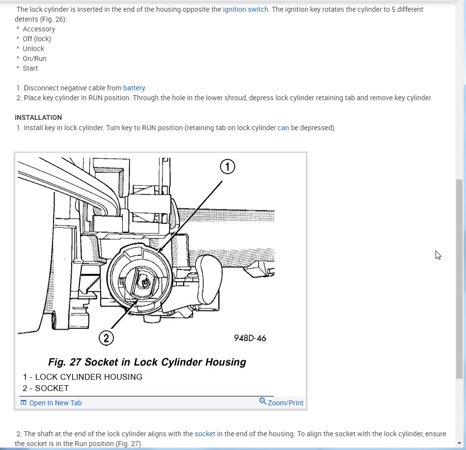

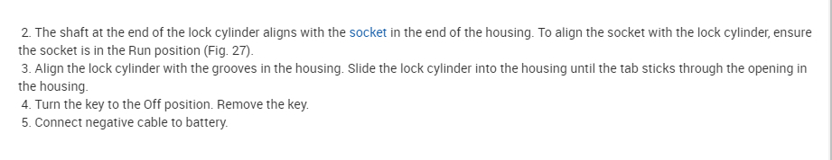

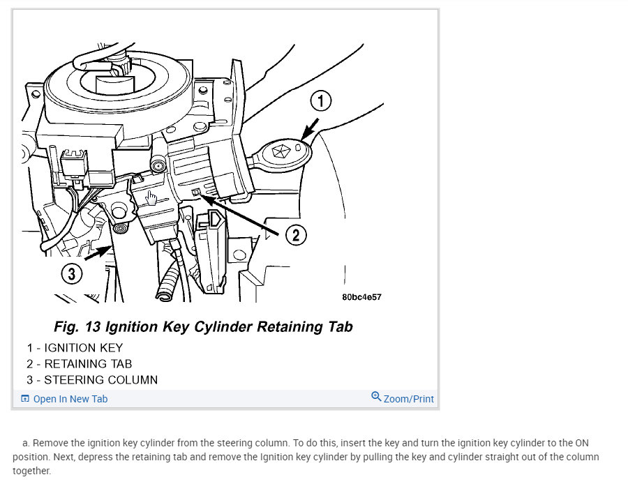

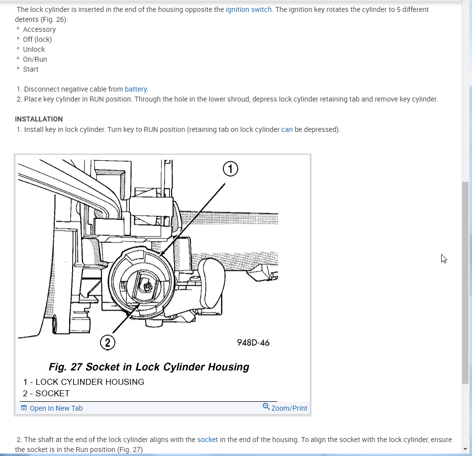

Okay. If the lights and accessories still come as you stated before, I suspect the ignition switch is the most likely cause.
This was also pretty common on these vehicles. In fact, here are a couple videos of someone with the same issue.
https://youtu.be/k25RvIl-8Dg
https://youtu.be/P_A7X1Ra6MA
If it were me, I would suggest replacing the switch and going from there. The fact that it worked once with no issue and then stopped points to an electrical issue and since you are getting nothing out of the ignition switch, I suspect that is where your issue is.

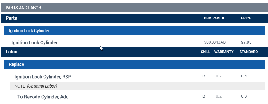

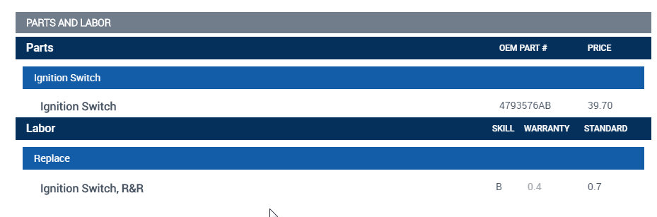

Haha. There are some good ones out there. Here are the OEM parts and labor times for the switch and cylinder. You may need both but again they can check this out.
The way you get a rough estimate is to take the standard labor time and multiply that by the shops door rate. Then add the part price. Clearly you would use a different part price if they don't use the OEM part.
Also, they will need to diagnose this themselves because they are not going to take our word for it unless you just tell them to replace it. If they are going to be responsible then they are going to want to confirm what we are saying and that will be a charge as well.
By the looks of it, you should be around $250.00 all in. If it is much more then you can just ask them to break it down to labor hours, part price and the door rate and you can compare it these times. Just remember, everything is negotiable.

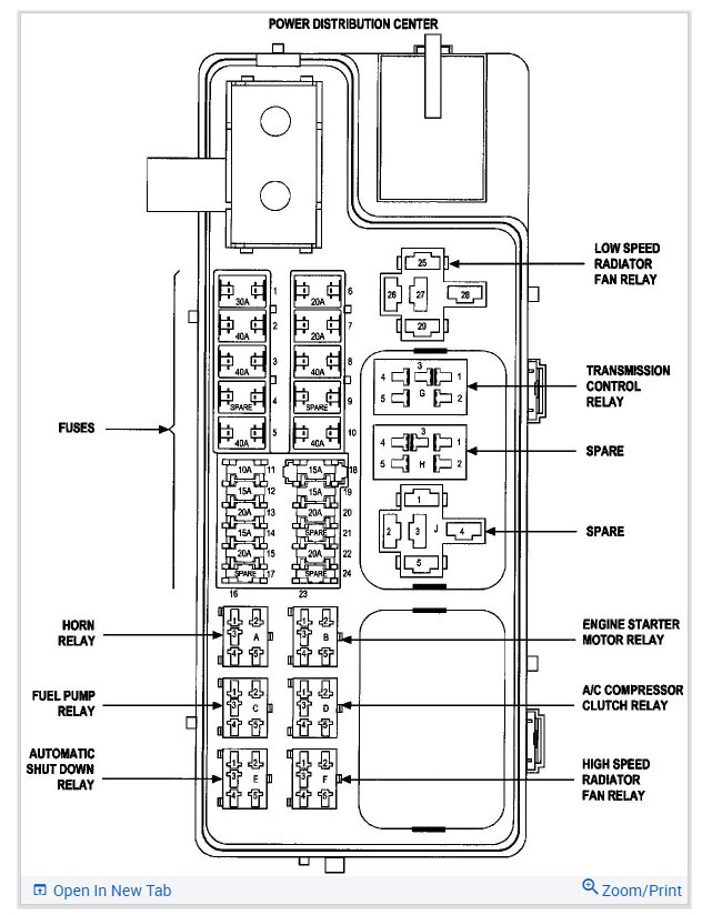

Just to wrap this up, it ended up being Fuse #13. Before I bought an ignition switch I found out about the key dance, and tried it and got nothing, not even "done." I got on the PT Cruiser forum and searched "security light on, no scan, no key dance, no turn over" and it said to try that. Even though my son checked the fuses, he missed this one. So $6.00 later I am back on the road. Thank you for all of your help!
