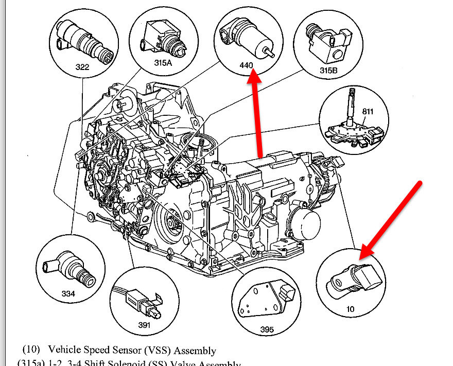

I press the accelerator but rpm does not goes beyond 3000. Even when I press the power shift it does not move.
i asked one local mechanic to check with diagnostic computer he told me the error was P0717 input/turbine speed sensor a circuit no signal.
also, there is check power train error whenever I start the engine.
kindly help me what is the problem and how to rectify it.

It means that a signal is not being sent to TCM/PCM so will not shift right. The sensor could be bad or disconnected or poor contact. See picture, it is marked 440 in picture. Other one marked 10 is vehicle speed sensor.

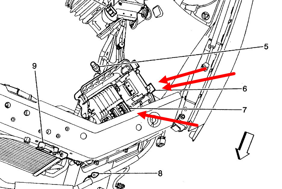

Mechanics here are not able to diagnose the problem please can you show me a picture of TCm/Pcm it would mean alot if with exact location I really appreciate your help
As per I understand this is more like an electrical work rather than mechanical right? So should I go for car electrician?
What about the price of the module?
Saturday, June 17th, 2017 AT 7:58 AM
HMAC300
  • 48,601 POSTS
Mosudles can be bought new or rebuilt but have to be programmed to your car. A mechanic with a pro scanner should be able to fix this. It may not be the pcm also check battery for condition as a low batter will throw multiple codes. Both tcm and pcm are inside air cleaner double arrow in pic is tcm
