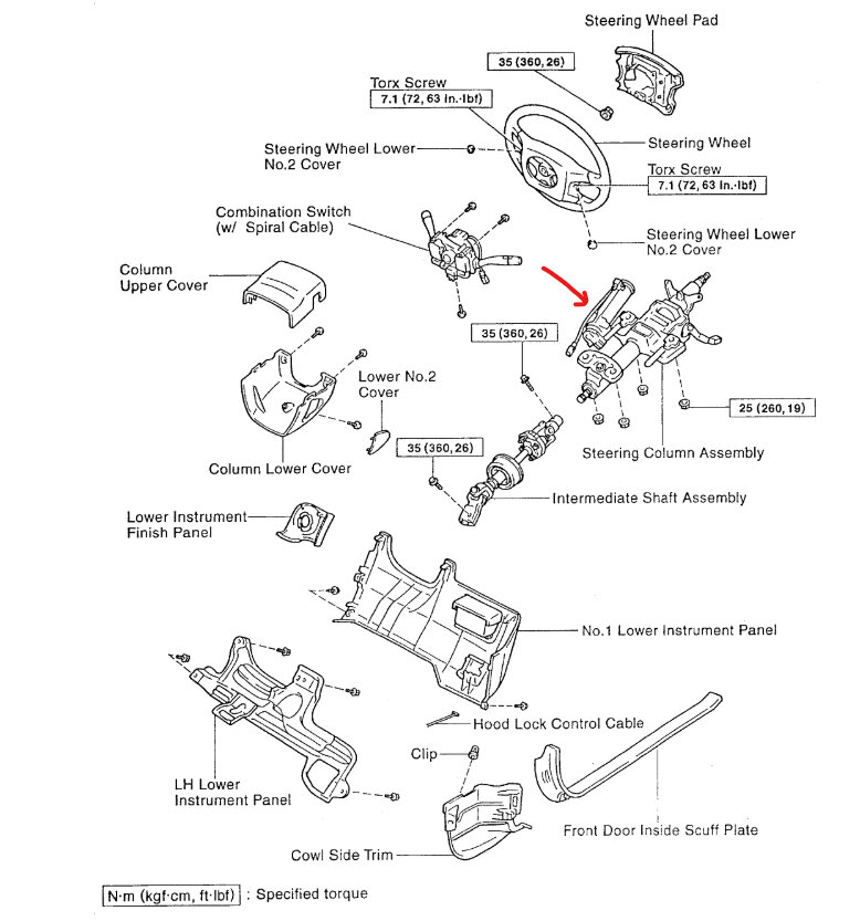

I have an electrical problem with the car listed above as follows: the car starts fine but within a minute or so the dash lights, gauges go out and simultaneously the engine quits running. After a very short period of time, it will start again with the same outcome. What can it be?
Feb 24, 2025 at 5:55 PM
  • 54,503 POSTS

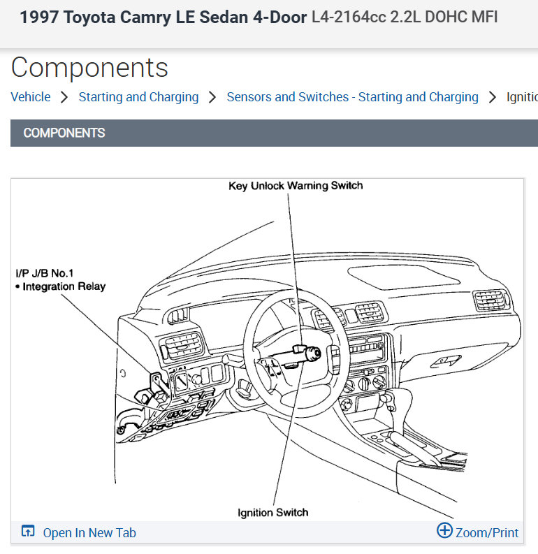

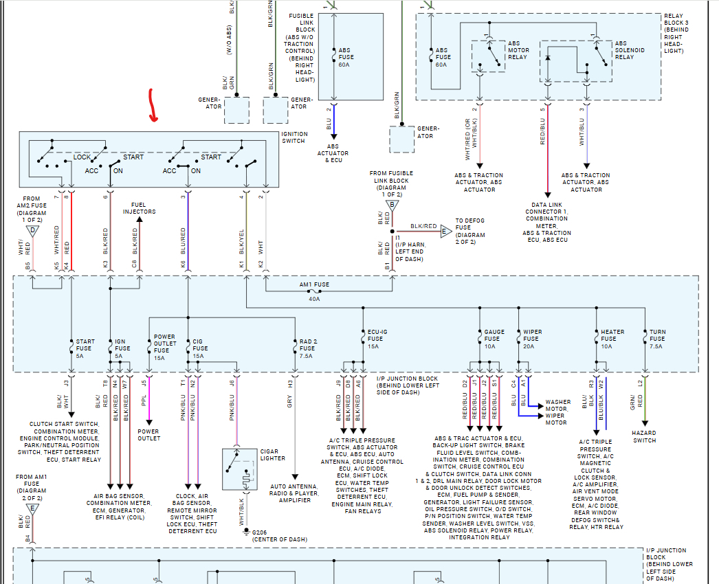

This is common when the ignition switch goes bad and needs to be replaced, to be sure here is a guide to test for power through the switch.
This guide can help:
Here is the ignition switch wiring diagrams so you can see how it works and which wires to test. Check out the images (below). Please let us know what happens.
