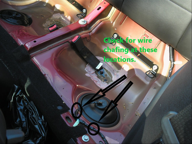

A broken catalytic converter, failing fuel pump, or various electrical issues can cause similar symptoms. Have the codes been retrieved? I have also had problems with the wiring under the rear seat on the driver side, wires get chafed against a sharp edge on the body, the wires go to the fuel pump. I've illustrated a picture of the areas that you should pay close attention to.

On my way home from work that day I stopped by O'Reilly to have the codes checked. Only thing that came up was a lean condition which leads me to believe it's a fuel delivery problem. I checked the wires under the seat. Mine are on the underside and they're fine. I changed the fuel filter and swapped the fuel pump relay with another relay. So far driving to work yesterday and today, I haven't had any problems. The car has 200,000 miles on it and I don't know the previous owner's maintenance records so it could have just been a clogged filter.

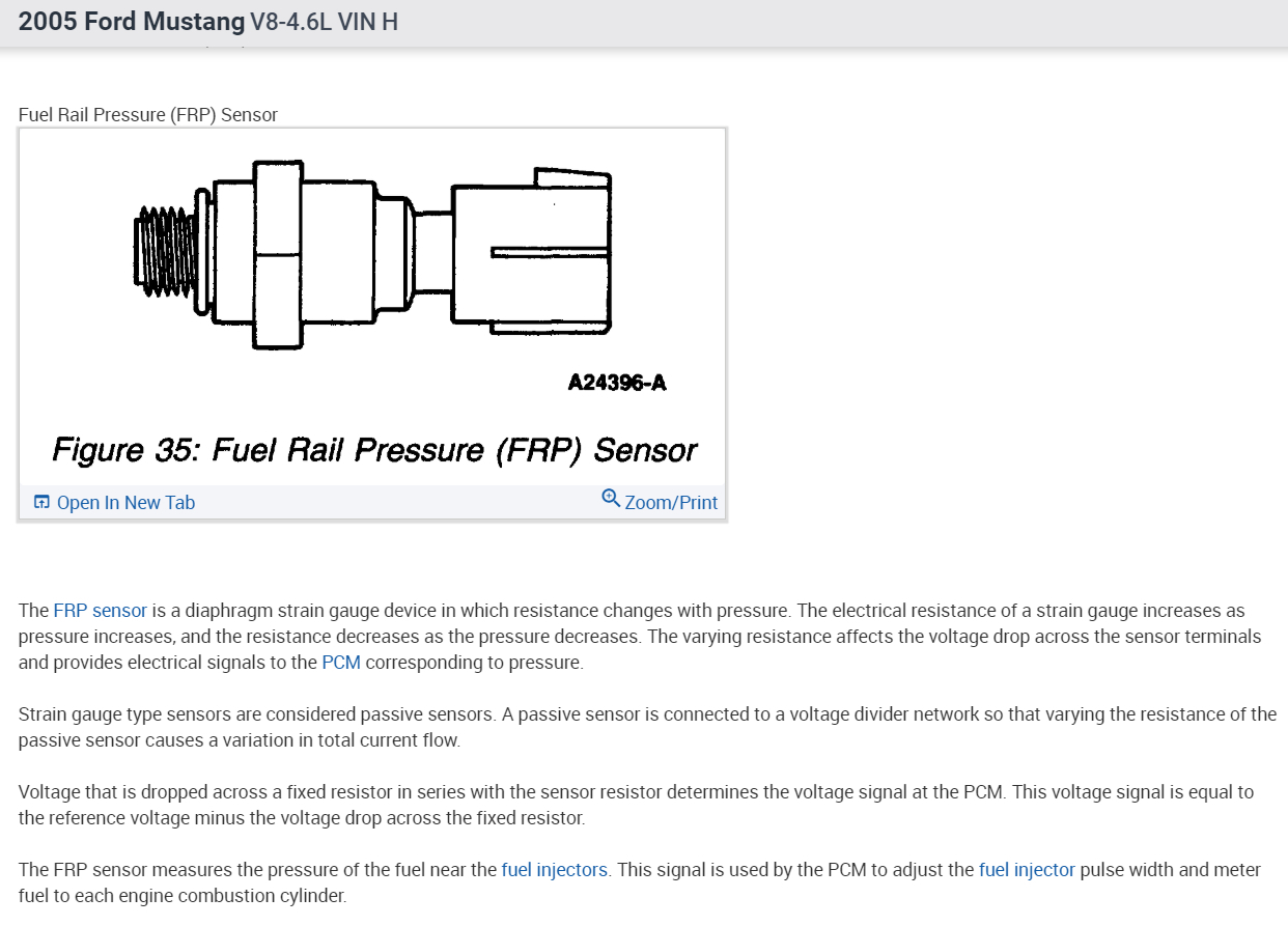

I tried cleaning out the throttle body and it did seem to improve. Unfortunately the problem came back. I was having new codes come up on the computer. P0193 Fuel pressure Sensor High. I researched this and the 2 possible causes for this code are either a clogged return line or a bad fuel pressure regulator. I found a good price online so I went ahead and bought one since I have 200,000 miles, I'm sure it's due for replacement. I changed it yesterday and reset the codes. So far the engine light hasn't come on and I haven't had any stumbling issues. Hopefully this fixed the problem.

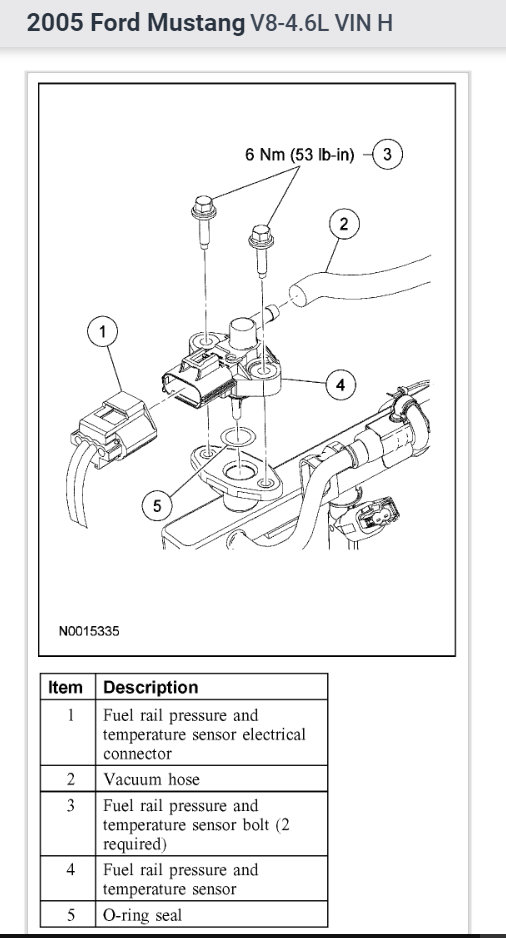

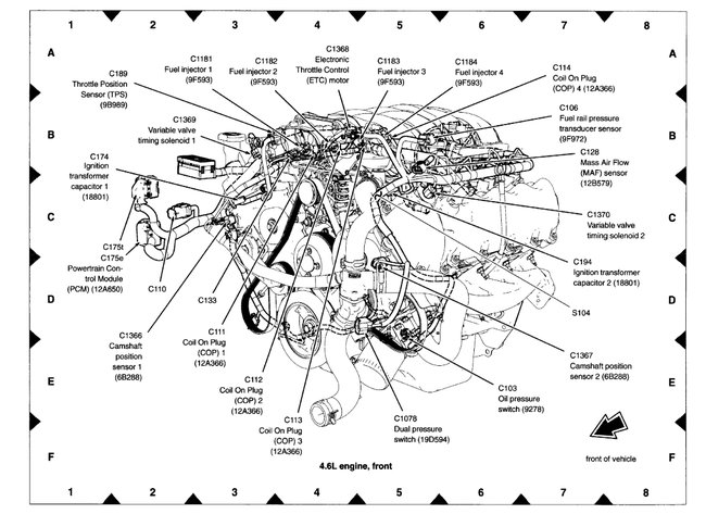

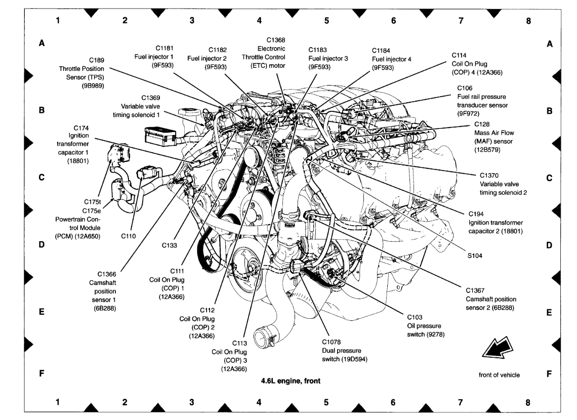

I have seen the fuel pressure sensors go bad on these cars. Here is the location in case the cods comes back. Check out the diagrams (below). Please let us know what happens.

Yes fuel rail pressure sensors go bad all the time on these, but I would verify fuel pressure with a manual gauge as well.
