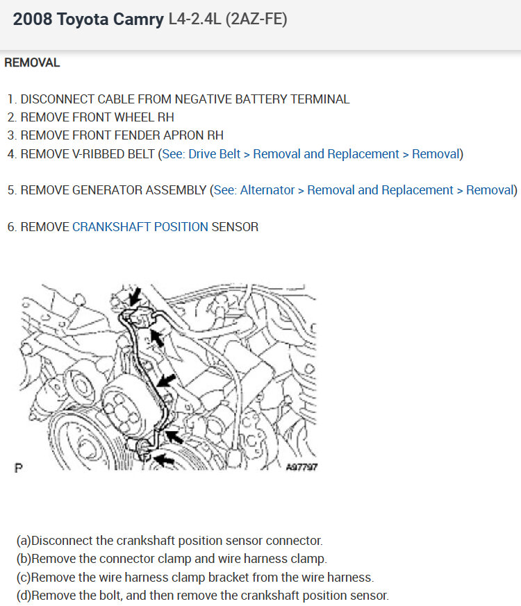

So, when the engine will not start does it have spark? If not, I have seen the crankshaft angle sensor go out, here is the location so you can change it out. Also, have you re-run the codes to see if any other codes have come up? Check out the images (below). Please upload pictures or videos in your response of any problems so we can see what to help you with.
