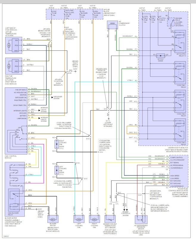

My car air conditioner runs on high with the car turned off and keys out of ignition. From research I found it is likely the blower motor or blower motor resistor. I was going to take out a fuse to the high blower to stop it temporarily, but that same fuse controls my brake lights so I cannot. So I have searched online for videos and pictures and apparently my blower motor is supposed to be under my glove department, but what is under there does not at all match any of the videos I saw. Where is my blower motor and how can I unplug it to stop it from running? I cannot afford to replace it right now, I just need to unplug it so it stops killing my car battery. I need the transportation more than I need the air conditioner right now.

The problem is the speed control itself, when they short out the blower motor stays on high. Here is a diagram.
Here is a diagram with the locations of each
Sunday, July 17th, 2016 AT 8:47 AM

He said he does not have auto temp control. There shouldn't be a speed controller, just a resister.

Yep, my blower motor has a resistor. I did try to unplug that but it's really hard to get at, so I just took out fuse to the high blower.

The resister is likely the problem with the blower as the relay is incorporated into it. As for the battery, yes, running it that low can ruin it. Try giving it a long slow charge. Do not use jumper cables as that can ruin your alternator.
