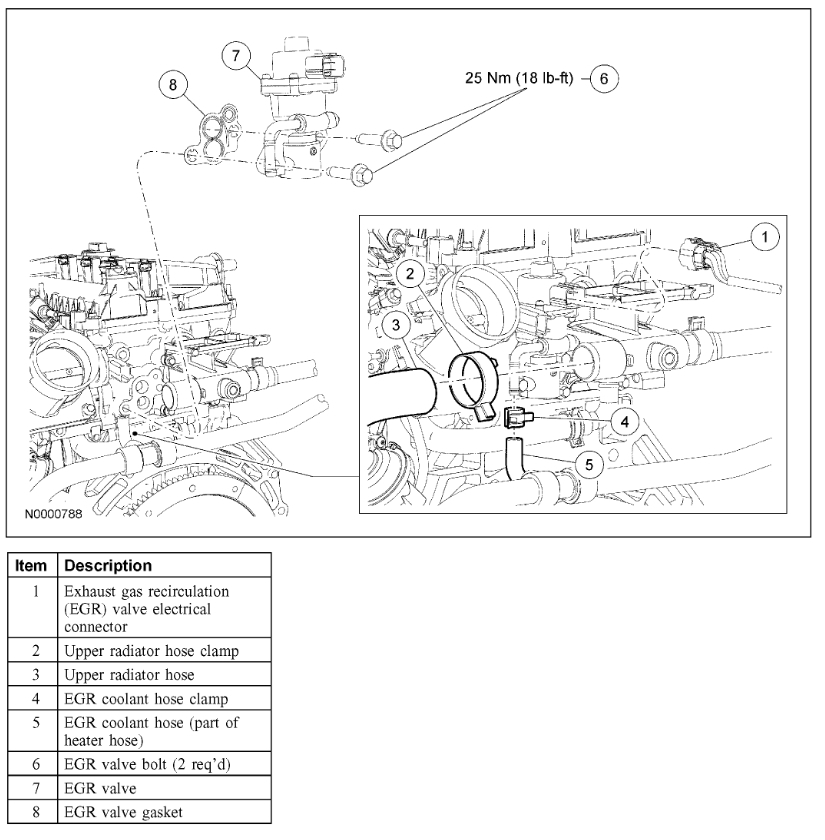

I have seen a sticking EGR valve cause this problem. If this valve sticks open it will cause an internal vacuum leak. Here is the location of the valve and a video to show you how to check it.
https://www.youtube.com/watch?v=DqUCbbKdWf4&t
This guide can help with stalling at idle as well:
Check out the images (below). Let us know what you find.
