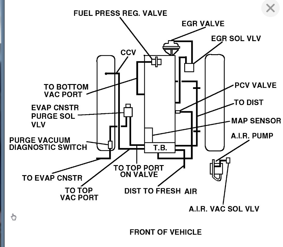

Diagram of the vacuum hoses and how to properly connect to the purge canister and solenoid
1996 CHEVROLET CORVETTE
50,000 MILES • 5.7L • V8 • 2WD • AUTOMATIC
MARCLINY
I am disabled due to diabetic foot pressure ulcers and I am trying to reconnect the vacuum hoses and and I cannot remember how the hoses connect to the purge canister and solenoid as well as a fuel hose that connects near the coolant fill canister which hose I need and where it goes to. I’m learning how to do the work so I can pay attention to detail and clean /detail the areas around where I am working and inspect other wiring and hoses and change the parts necessary for keeping the car running as great as it can. Besides the diabetic issues as a former Marine I am very obsessive compulsive about the projects I cannot afford to pay ridiculous rates when they have manuals but are extremely rare but I don’t give up. I really appreciate any help to get the codes that seem to mostly be from the emissions, Thank you!

Totally understand. Check out this diagram. I think that will get you everything you need. Let us know if you need more info. Thanks and thanks for your service to our country.
