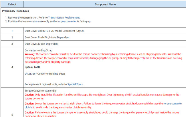

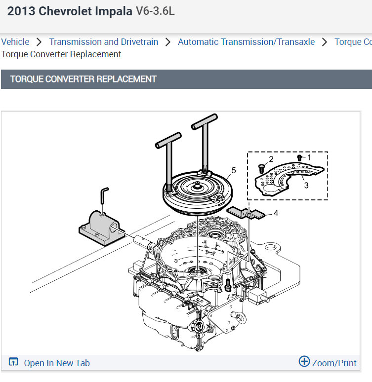

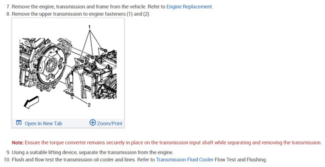

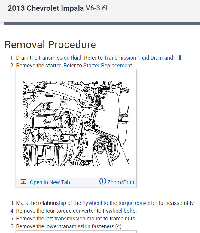

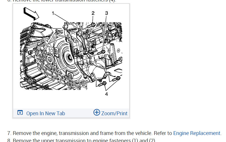

You will need to judge that for yourself, to change the torque converter the transmission will need to be removed.
Here are the instructions and a video that will help you with the job:
https://www.youtube.com/watch?v=ZC7xHVMKLRw
You will need to disconnect the battery and drain the coolant, then you will need an engine cradle to hold the engine up inside the car when the subframe is removed. Check out the images (below). Please upload pictures or videos in your response of any problems so we can see what to help you with.
