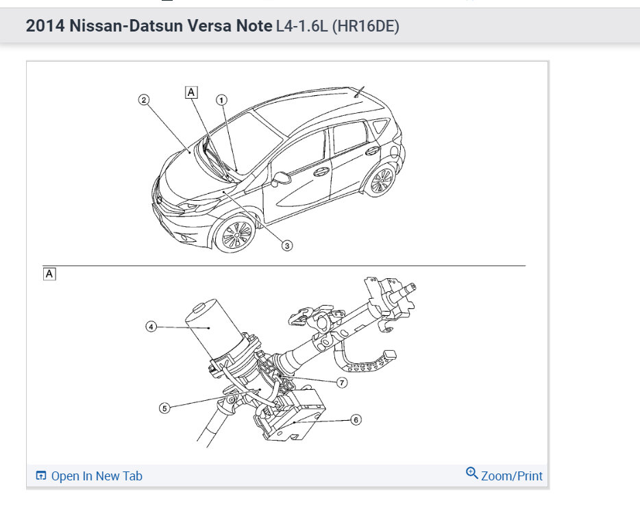

Hi, thank you for answering my engine questions today about our 2014 Nissan Versa SV engine, I found out that our 2014 Nissan Versa SV is equipped with an electric power steering and thank heaven I won't have to worry about power steering hoses leaking power steering fluid but I am wondering can electric power steering fail and make the steering wheel very hard to turn and which parts does electric power steering consist of? I have heard that electric power steering has an electric motor on the steering wheel and a steering wheel position sensor? is that it? does it have a rack and pinion steering gear unit and tie rod ends? can it fail and how much does it cost to replace a complete electric power steering unit on a 2014 Nissan Versa SV? thank you in advance for your valuable information on electric power steering and for earlier information you supplied on our engine, our CVT transmission, and on our serpentine drive belt, your information is very useful and helpful to me

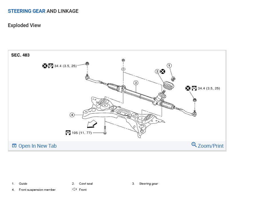

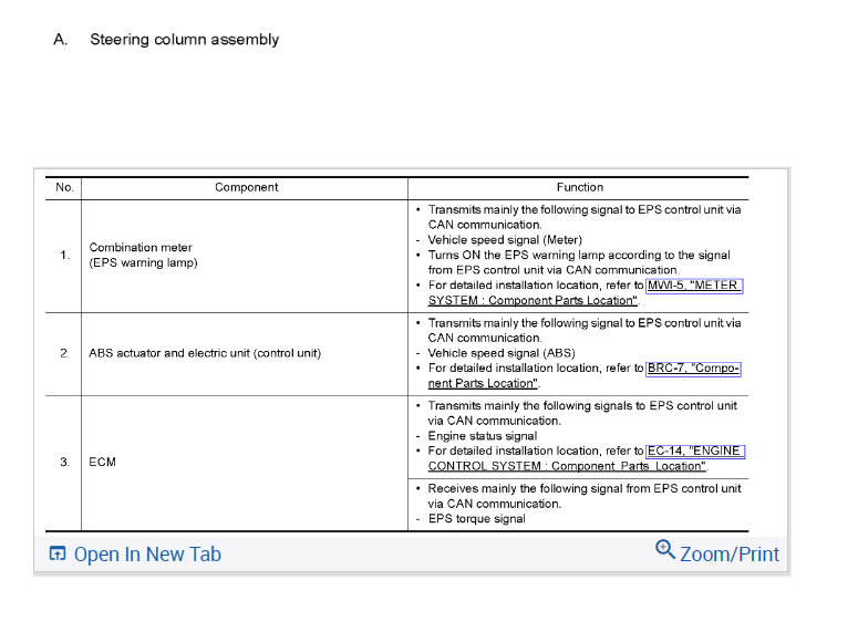

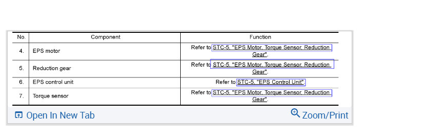

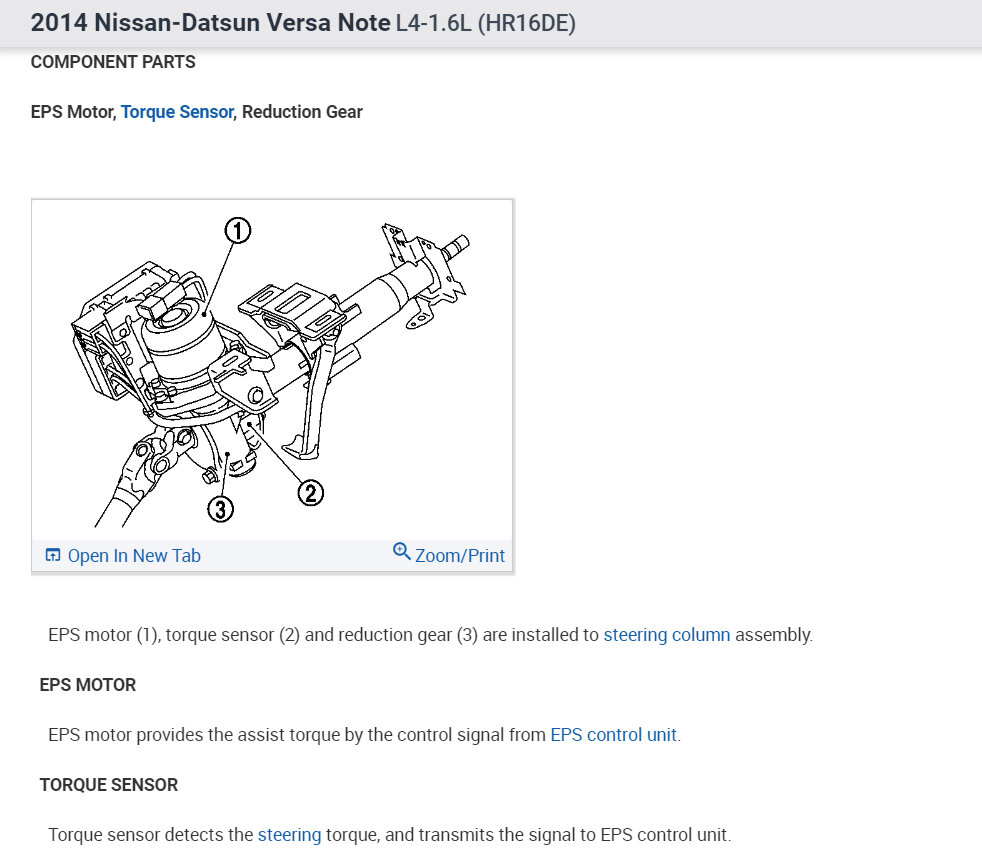

Yes, the car has a steering rack with tie rods and an electric motor to assist the steering system. please check out the images below to glean more information and understanding of the system.
4 - Steering Gear 480019MD0A 1083.30
Steering Gear, R&R 2.7 hours@ shop rate
Check out the images (below). Please let us know if you need anything else to get the problem fixed.
