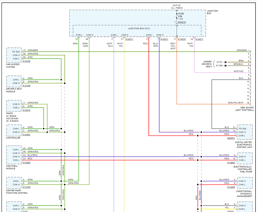

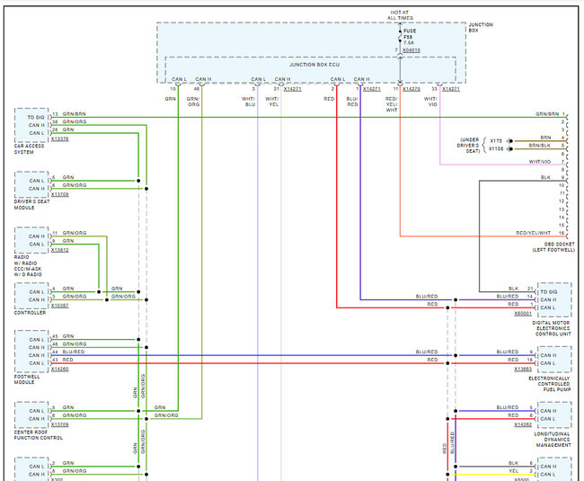

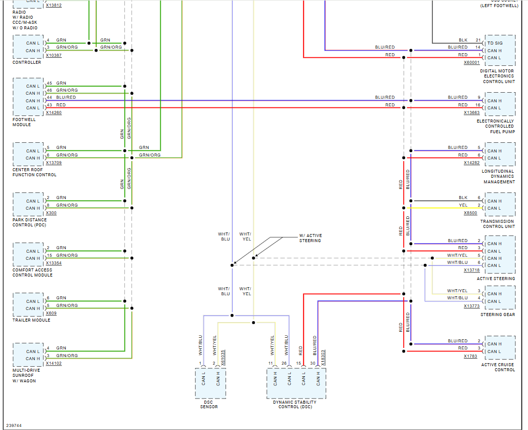

Hi Ken, I have this BMW with no communication on either module, a network can bus diagram will be a wonderful solution for me to further understand what has short the network down.
A diagram on this gate way network system will be a huge breakthrough for me.

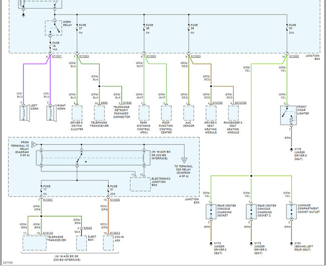

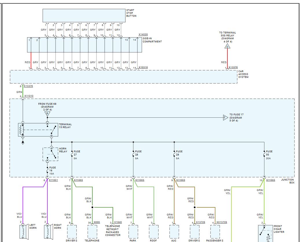

Is this a euro car? The VIN didn't work but here are the CAN bus wiring diagrams with the data connector so you can see how the system works. Check out the images (below). Let us know if you need anything else.

Diagram is on point Ken, I truly appreciate, I am replacing the Gate way module. Thank you so much, this means all.

I don't see the gateway module in the CAN system?

It use the Lin network system not the Can, the gate way is same as the Junction box, after replacing it, the car could start freely, and the board opens at all times.

You sent two diagrams, the first diagram shows the gateway module as the junction box, this is a Europe made, so am use to solving this, with the diagram you sent made it even more easy for my son to solve without me being present.

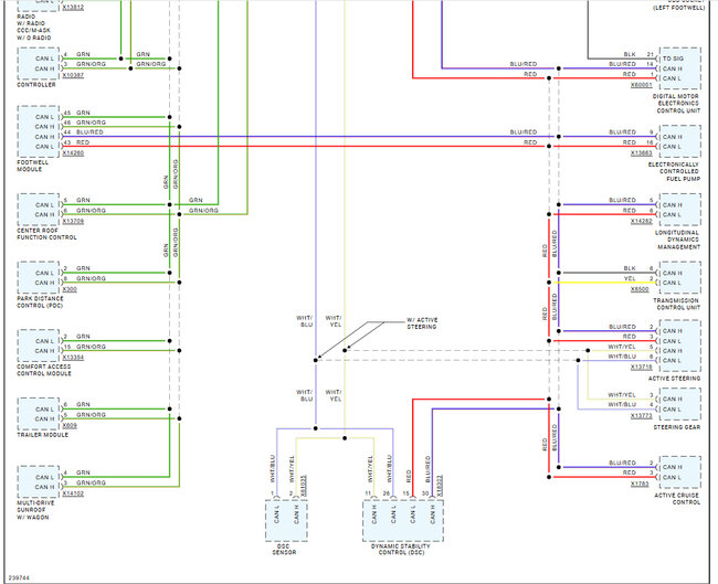

ANDRIN ATEM
  • 420 POSTS
Please can I have an active steering lock diagram for the above and the location of the steering column module for the e90 320i BMW 2006.
Recently noticed the steering lock does not release, sometimes it does and most times it does not.
Wednesday, January 15th, 2025 AT 1:06 AM

I think this is what you need, check out the images (below). Please upload pictures or videos in your response of any problems so we can see what to help you with.

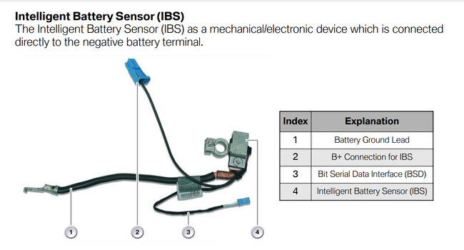

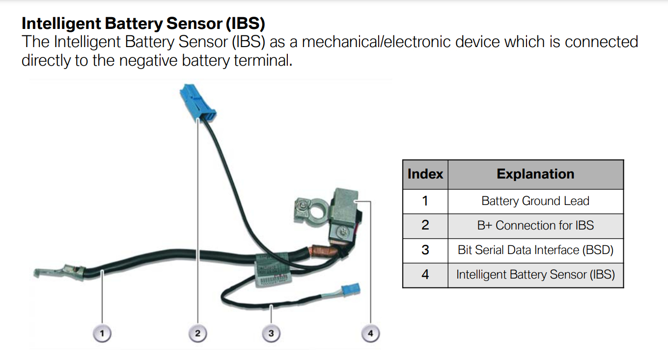

Hi Ken, I found the problem and everything is okay. The main problem was a cable that leaves the battery sensor, it had some kind of a short I can’t really tell for now, but as I unplugged it, that car starts every minute and every second of the day. Thanks very much for all efforts and diagrams you provided.
Thursday, January 16th, 2025 AT 7:58 AM
ANDRIN ATEM
  • 420 POSTS
This is the image, the bit serial data interface was what caused the car not to start.
