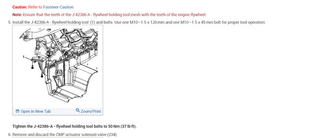

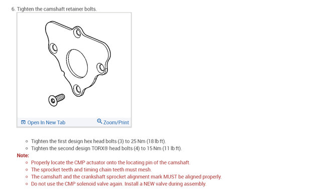

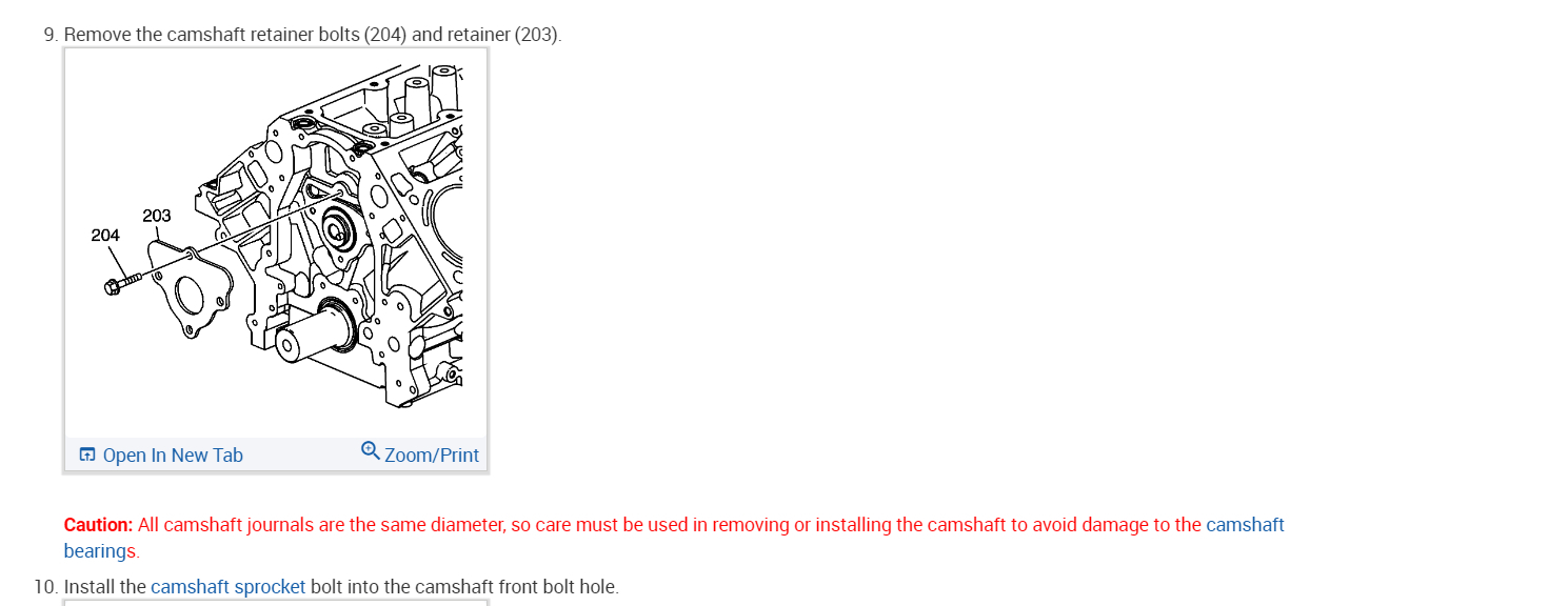

I need a diagram to remove the camshaft bracket. I have removed the 2 bolts but can not find what else to remove to be accessible to the sensor.
May 30, 2023 at 9:54 AM
  • CAR REPAIR CONTRIBUTOR
  • 54,434 POSTS

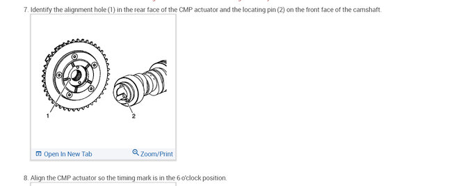

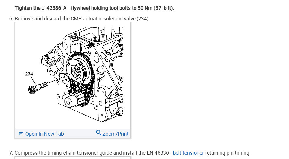

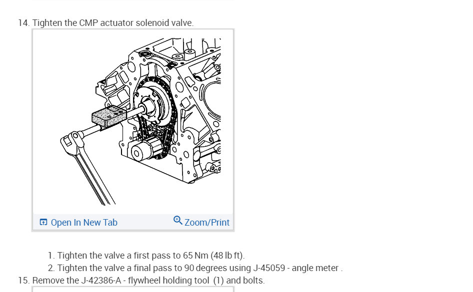

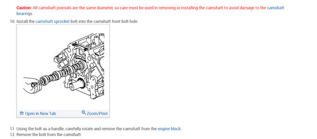

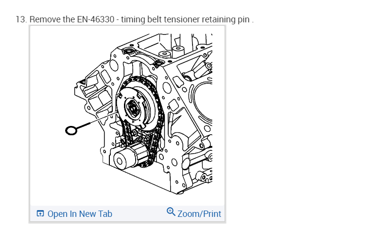

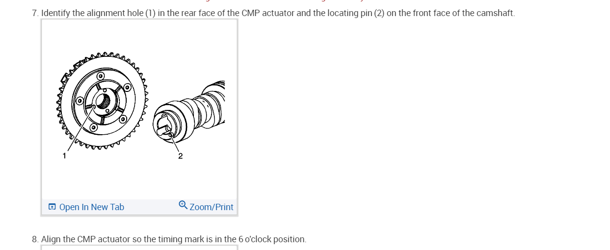

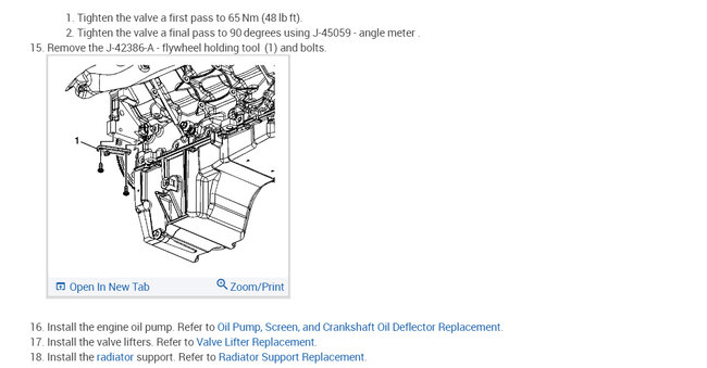

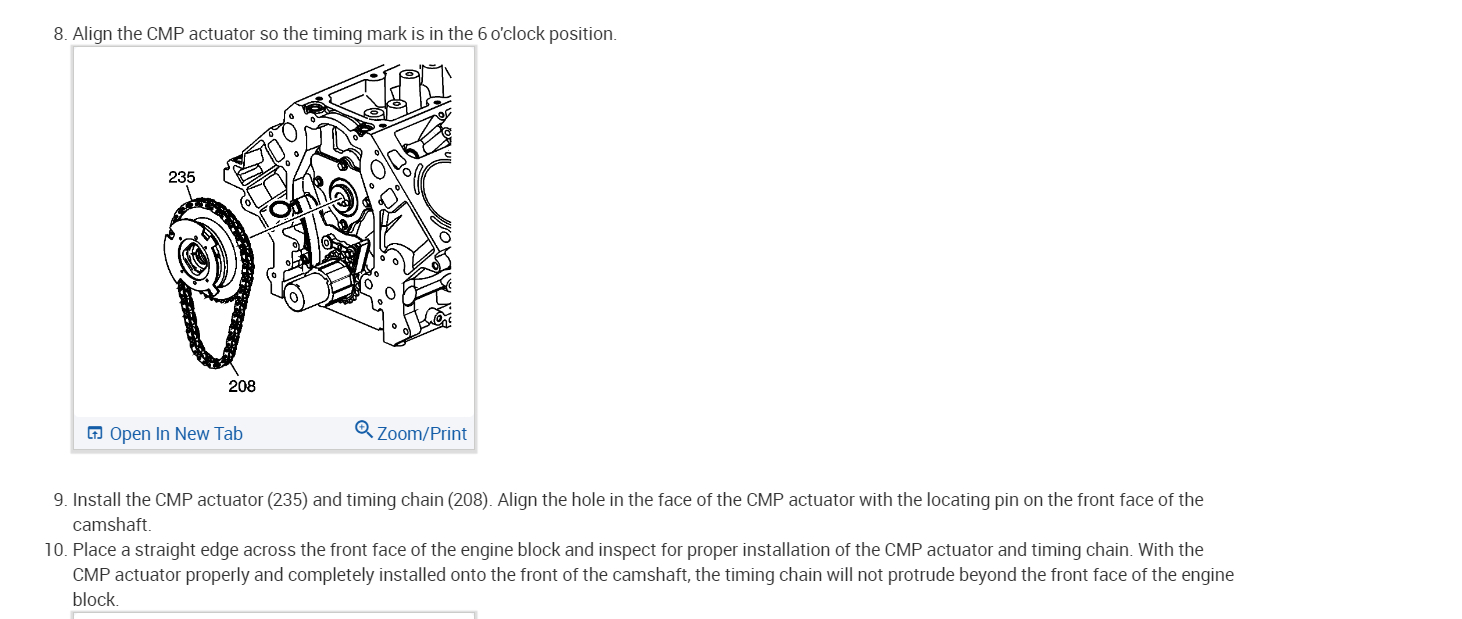

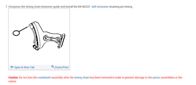

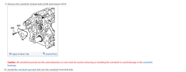

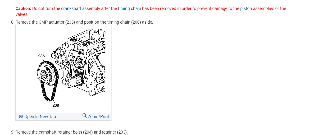

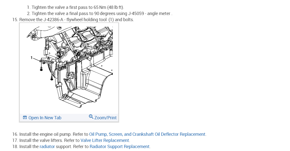

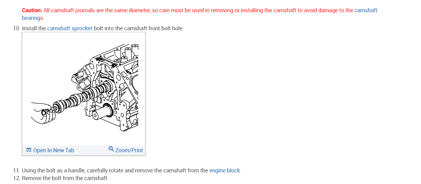

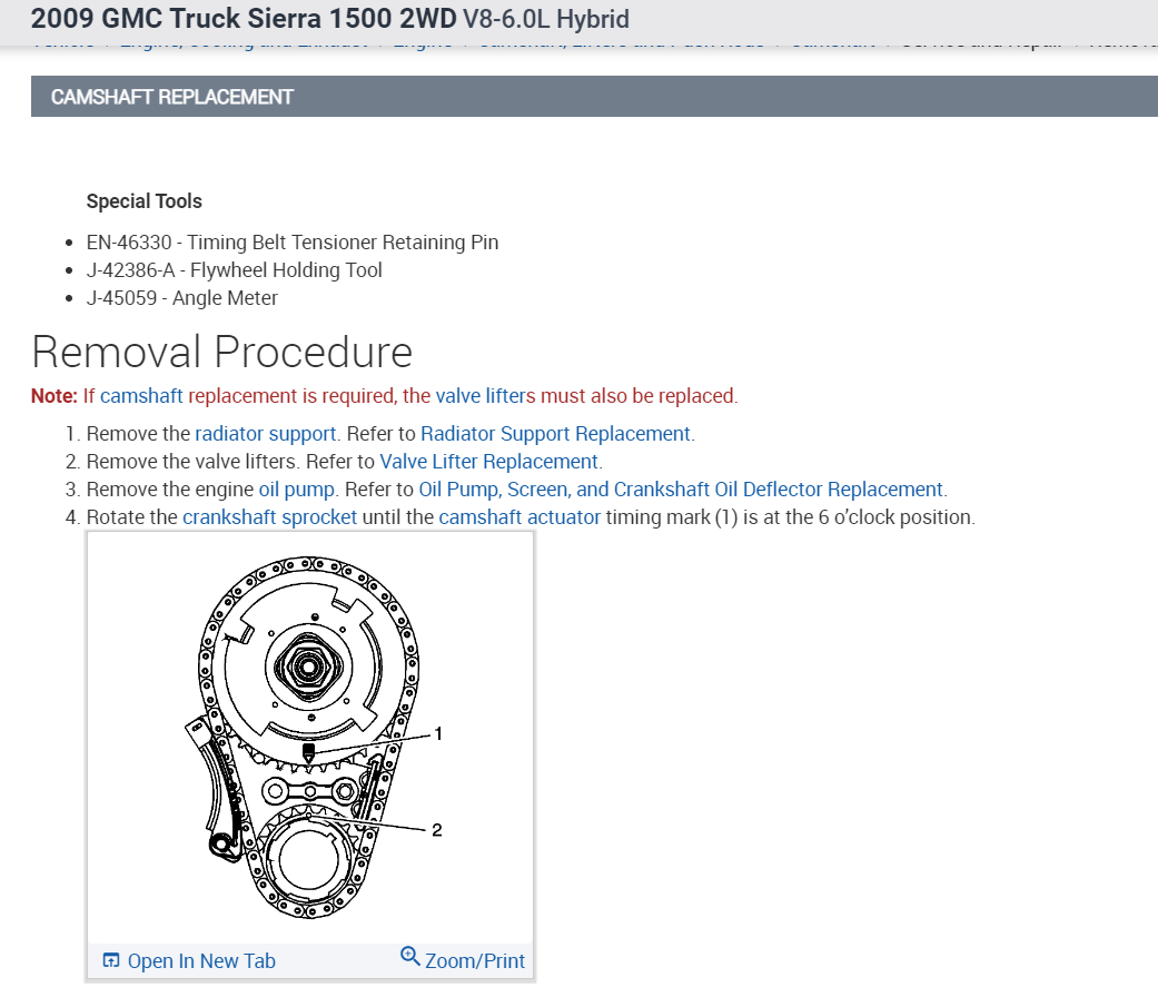

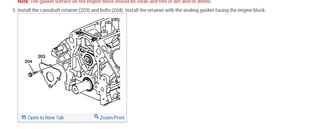

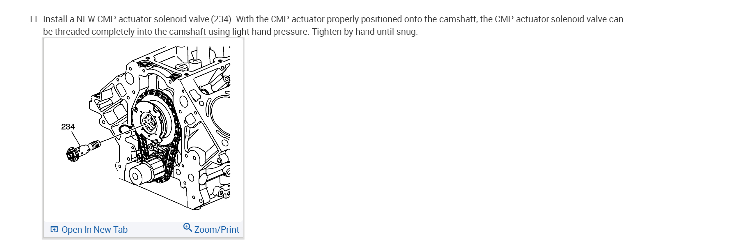

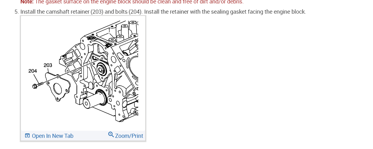

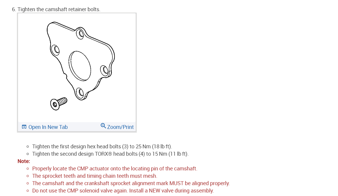

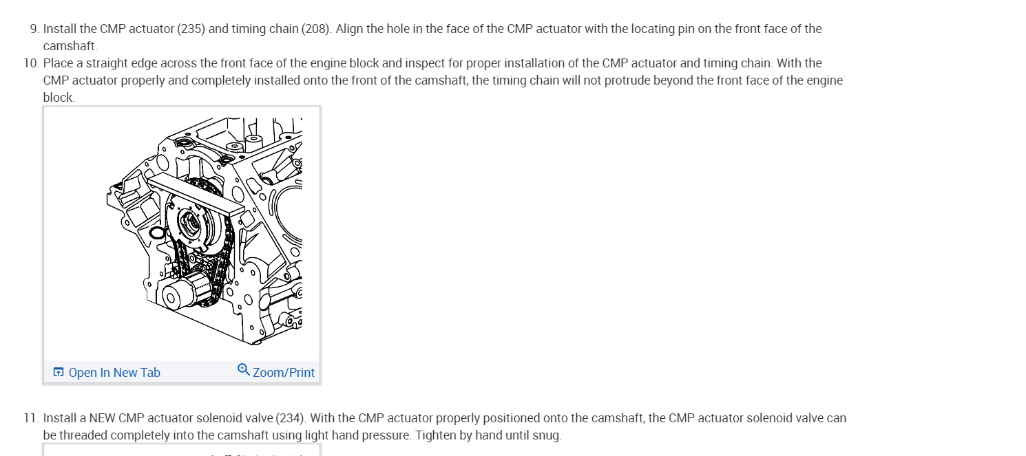

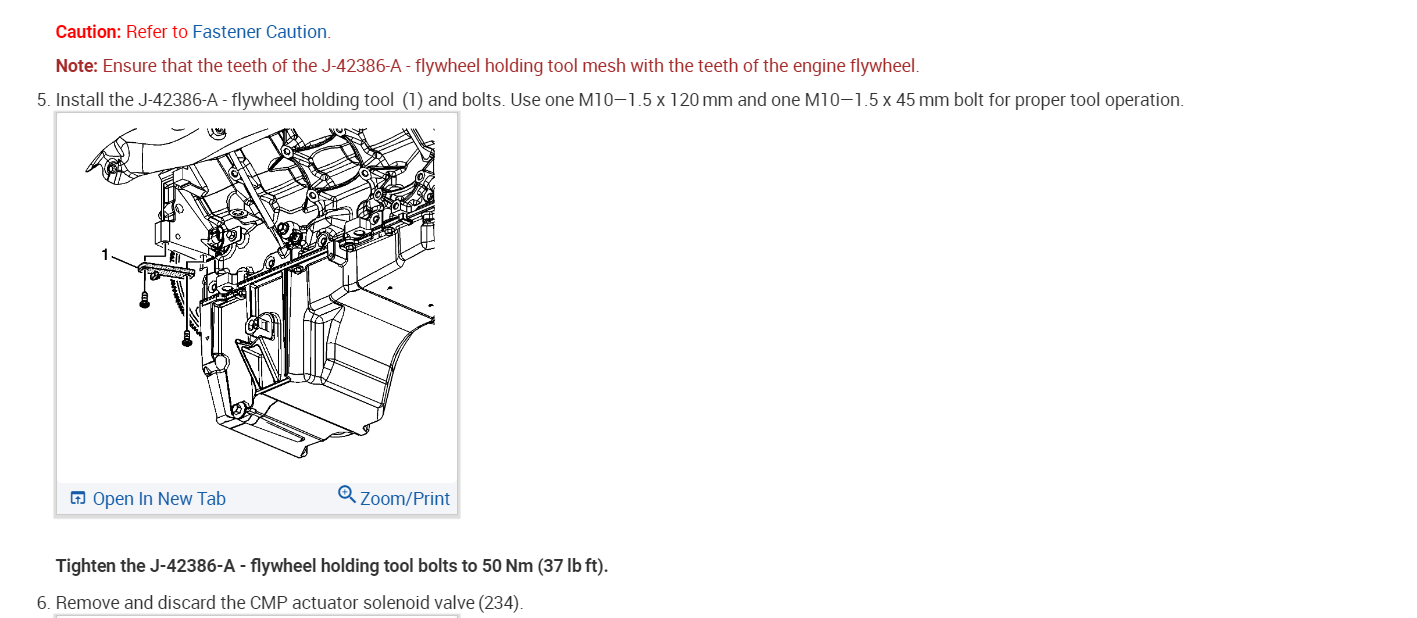

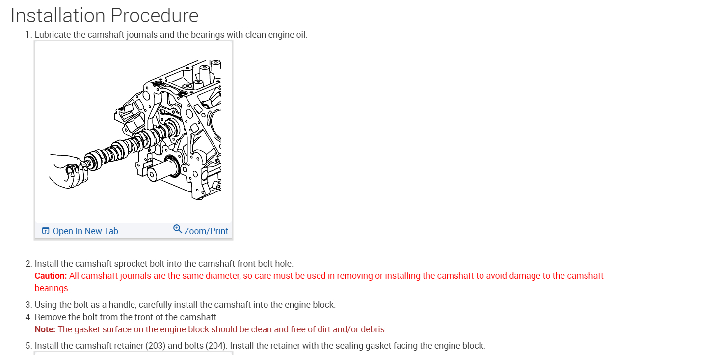

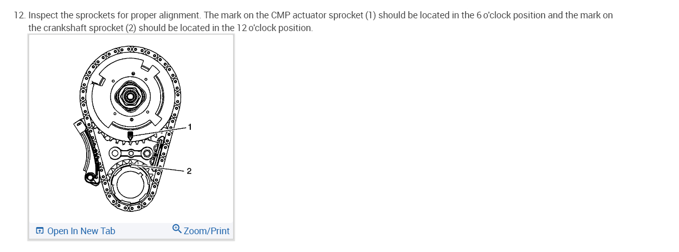

I am not sure about the bracket you speak of, can you upload an image or short video? Here are the instructions on how to change out the camshaft but you will need to remove the cylinder heads first. Check out the images (below). Let us know what happens and please upload pictures or videos of the problem so we can see what's going on.
