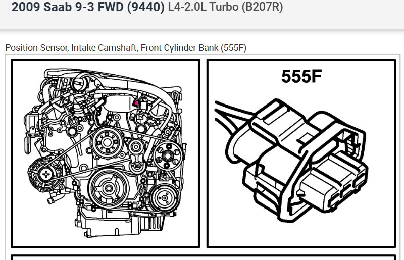

I need to find the camshaft position sensor in my car be code p0340 popped up.

Just to let you know most of the time the sensor will not fix this problem, this code appears when the timing chain, guide or camshaft position actuator, oil control valve is having an issue. Does the engine make a slight rattling sound when idling? If so, this can be the problem, if you upload a short video of the engine idling, I can tell for sure.
P0340 - Camshaft Position Sensor "A" Circuit Malfunction (Bank 1)
Here is the location of the camshaft sensor in case you want to try it. Check out the images (below). Please let us know what happens.
