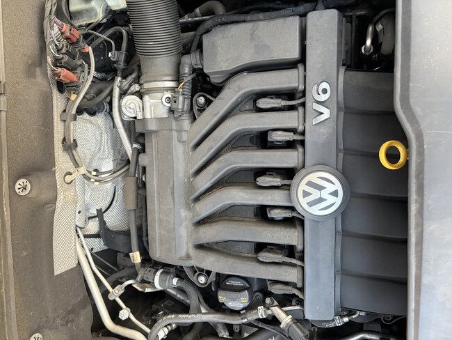

Please help me locate the camshaft position sensor bank 1

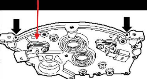

The camshaft sensor bank 1 is on the left rear of the cylinder head, but if you are getting a code for this it might be the timing chain system is having an issue, does the engine make a slight rattle noise when at idle when the engine is cold? If so this can be an issue. Can I ask which code you are getting? Check out the images (below). Please let us know what happens.

The code I am getting is P0366, but I can’t find anything online point out the sensor so I can change it. I found 2 sensors on the driver side of the engine but I believe should be a total of 4. I need to change bank 1 and from any sources I see online that should be on the passenger side but there just isn’t much information I find on my specific vehicle. And it isn’t starting due to I’m hoping that sensor.

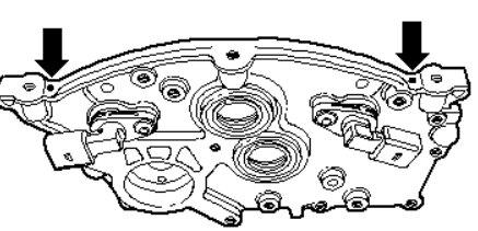

So this engine is a strange one, it says v6 but there is only one cylinder head and 2 camshafts. so the two positions I sent you are the only ones on the engine.
So the code P0366, the code definition is Camshaft Position Sensor “B” Circuit Range/Performance, Bank 1.
So sensor B would be on the left side of the plate while facing it. Does the engine have a rattle noise at idle cold? Check out the images (below). Please let us know what happens.

I put the new sensor in that spot (tried both actually) and the car still didn’t start. Do I need to clear the code with OBD to reset it with the new sensor installed? The car doesn’t start now so can’t say if has a rattle but I didn’t notice any unusual noises when it was working.
