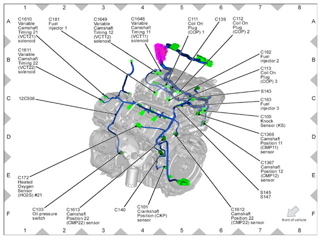

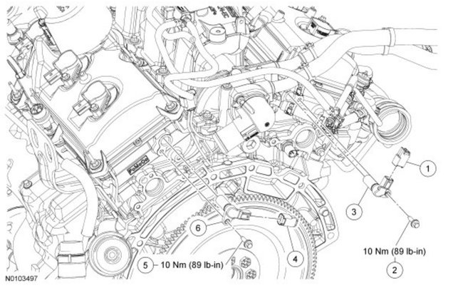

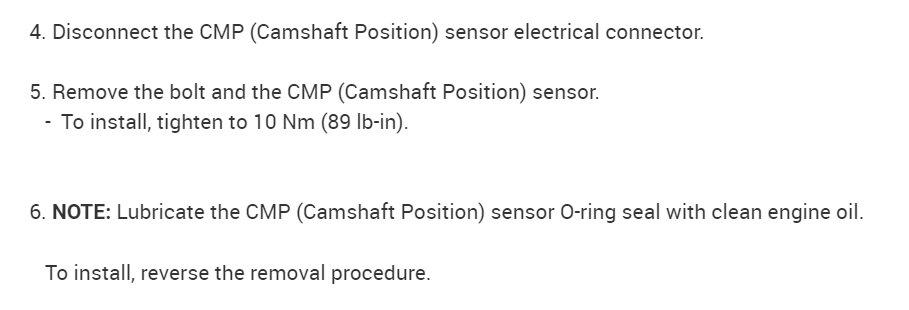

No real symptoms yet other than check engine light comes on then a few days later goes off. Back on, and off for last month. I get code p0016 Crankshaft Position, Camshaft Position, Correlation Bank 1, Sensor A. If I can find the sensor to replace, I figure it is a cheap fix even if it turns out to be wrong as the diagnostics to be more specific is a lot more money. But I don't know where the sensor(s) are? Not all Ford 3.5Ls seem to be the same, especially the F150. Mine is a 2013 MKT ecoboost.

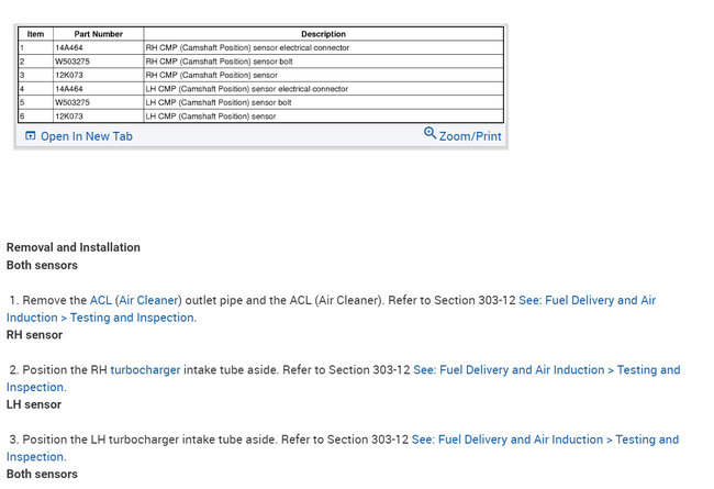

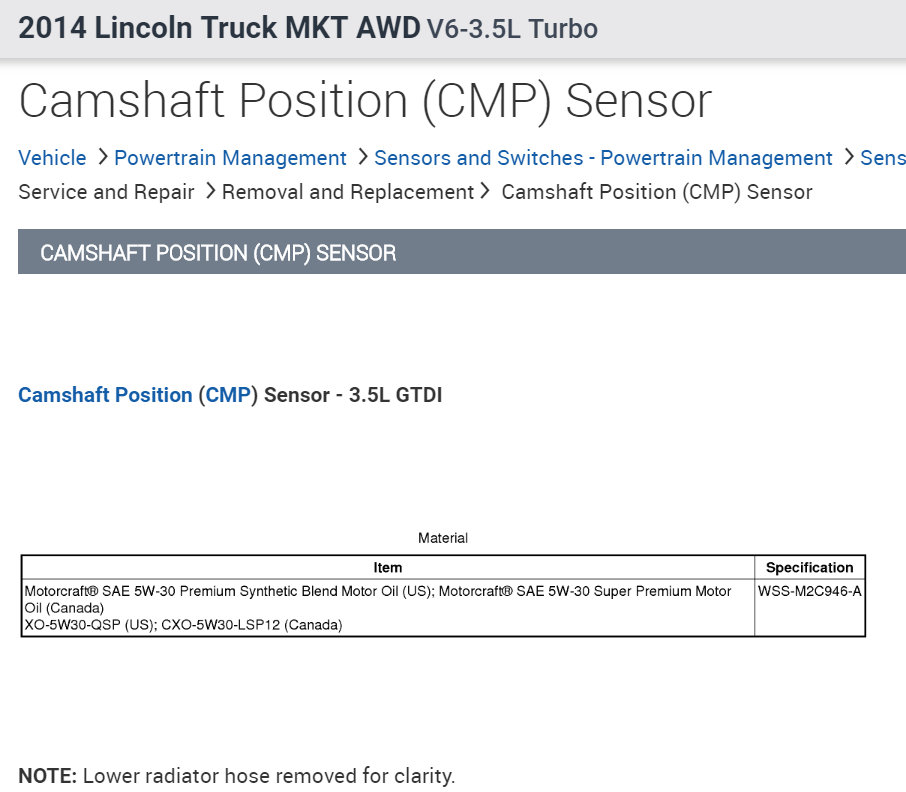

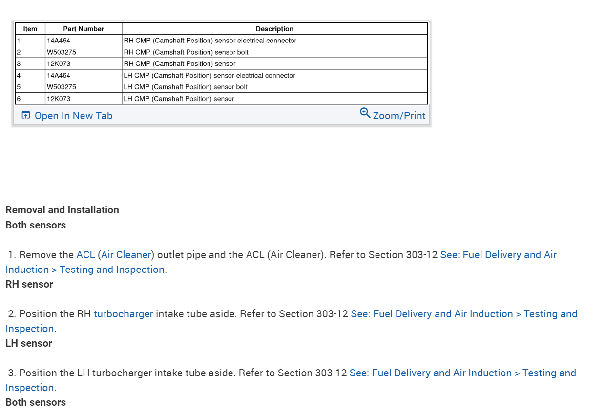

I have included both a diagram and removal and installation instructions for your vehicles Camshaft Position Sensors(CMP) in the diagrams down below. I hope this helps, and let us know if there is anything else we can do for you.

MKT
  • 9 POSTS
One question, which sensor is indicated as bad or do I need to replace both? Correlation Bank 1, Sensor A is not referenced on the image or elsewhere. This is very much appreciated.

Hello again,

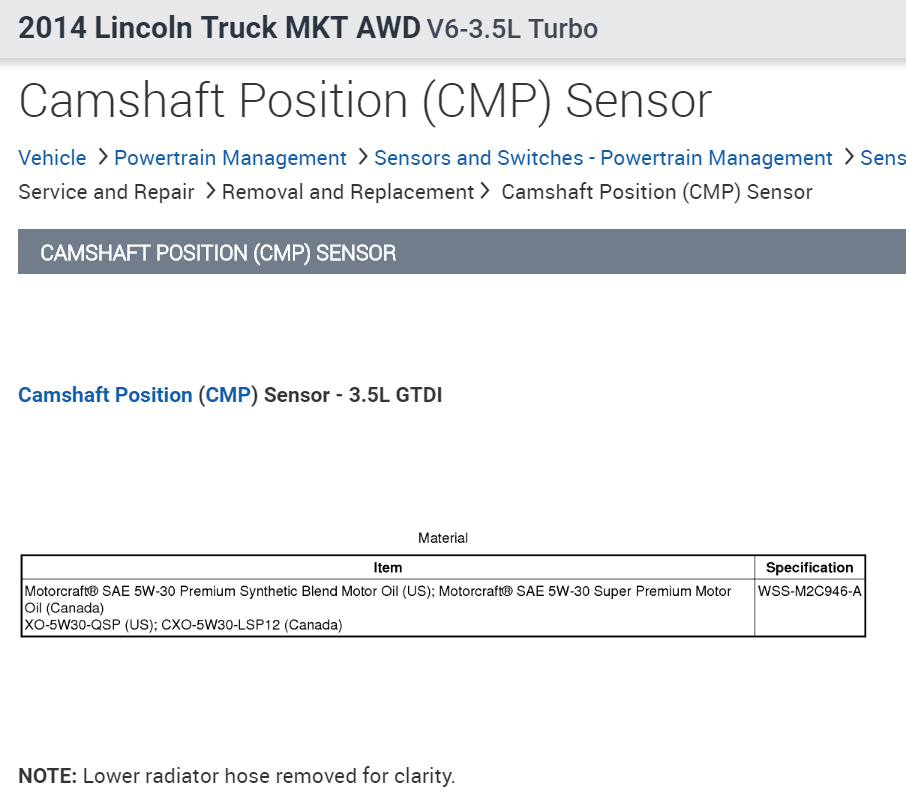

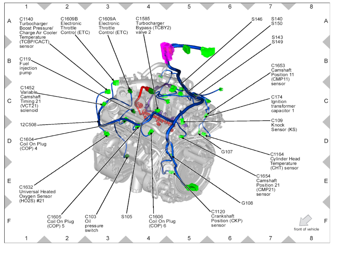

I have included the camshaft position sensor locations in the diagrams below. I hope this helps.

MKT
  • 9 POSTS
These images together show even more camshaft position sensors, now 4 instead of 2. And none correspond to the reading I provided. I'm more confused than ever.

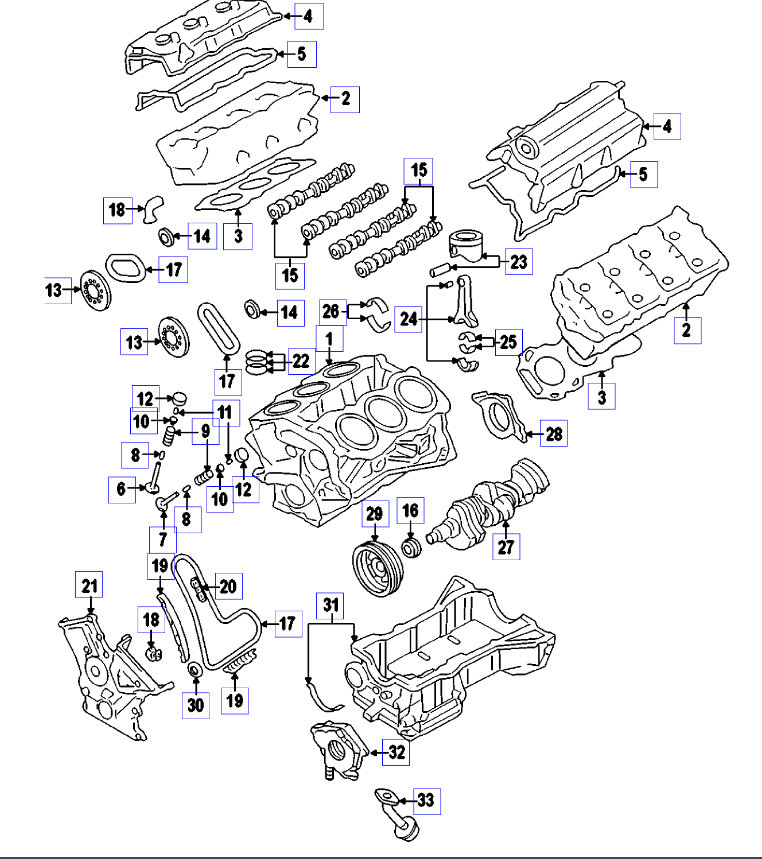

SCGRANTURISMO
  • 4,897 POSTS
Hello again,
There are four camshaft position sensor. Your engine is a Dual Overhead Cam (DOHC) 24 Valve engine (4 valves per cylinder. In this arrangement you a have two cylinder banks, each cylinder has two intake valves(1 camshaft) and two exhaust valves(1 camshaft). Camshaft 1, 1 would be bank 1(Intake), camshaft 1, 2 would be bank 1(exhaust). Bank 2 would be 2, 1 and 2, 2 respectively. I have included an exploded engine diagram to help illustrate in the diagrams below.

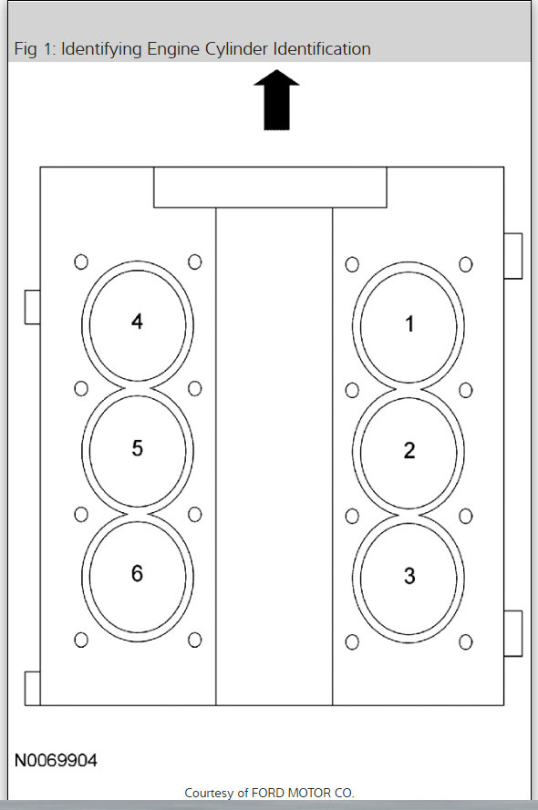

MKT
  • 9 POSTS
I guess I'm not making myself clear. Comments are very frustrating since no immediate feedback to each other orally and in the sense that no diagram and no cross reference so far indicates which side of the engine is bank 1, i.E, camshaft 1. Once I have a point of reference, your previous comments should help me identify which specific sensor is causing the bad reading. It is my understanding that cylinder #1 is on bank 1. As I sit in the driver's seat, is MY left side Bank 1? I am speculating that cylinder #1 is closest to the fan blade and on the right side and that would also be in bank #1. If that is the case, then the sensor is also on the right side. Now I have to figure out which one on the right side is Sensor A. Exhaust or intake doesn't = Sensor A.
Am I correct on the location of bank#1?
If so, which of the two sensors is Sensor A using the same point of reference as I sit as the driver seat?

MKT
  • 9 POSTS
Oops, I meant right side as I sit in the driver's seat is where I would find bank 1.

SCGRANTURISMO
  • 4,897 POSTS
Hello again,
Okay I have included a cylinder arrangement diagram in the diagrams below.

I have tried every way I know to ask you and you don't answer the question. Which of the two sensors on bank 1 is A? You continue to avoid that question. Don't get me wrong, I appreciate it but I asked the same question over and over and I'm very close, you never answer it. How do I identify the specific location of that sensor?

"Code P0016 indicates that a discrepancy has been detected between the timing of the crankshaft and the intake camshaft sensor (of engine bank 1) that exceeds 10-degrees at idle. Note: The “A” identifies the intake camshaft, which is located to the intake side of the cylinder head. “Bank 1” denotes the engine bank that contains the number one cylinder." Okay I have a link from Sensor A to the intake camshaft. And you did state it was the intake camshaft. I can't tell from the images you sent which is intake and which is exhaust. I'll presume that that intake camshaft for cylinder #1 (sensor A) would be located to the far right and the exhaust camshaft (sensor B) would be just to left of that but still on the right side of the engine. Is that correct?

If I can put my 2 cents, sensor A is on the same side as cylinder 1. But the P0016 can be caused by low or dirty engine oil which does not allow the camshaft actuators to work correctly causing the code.

Sensor A is closest to the intake manifold.
