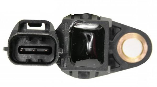

Camshaft position pigtail
CARLOS DEHERRERA
  • 2002 HYUNDAI SONATA
  • 2.4L
  • 4 CYL
  • 2WD
  • 200,000 MILES
Sensor was broken, bought replacement sensor connector, but arrived with three white wires. Figured out that orange wire (from engine) goes to three position on sensor. I know that one black wire is ground and the other black is signal (i think the voltage to this wire should be at five volts. If I use volt meter, and I put one lead on negative at battery and the other lead to black wire I should get at five volts. When key is on. Is this that correct? The other black wire if I put one lead on positive (battery) and touch the black wire (voltmeter on Ohms) is this correct? Help!
Wednesday, September 13th, 2017 AT 2:03 PM

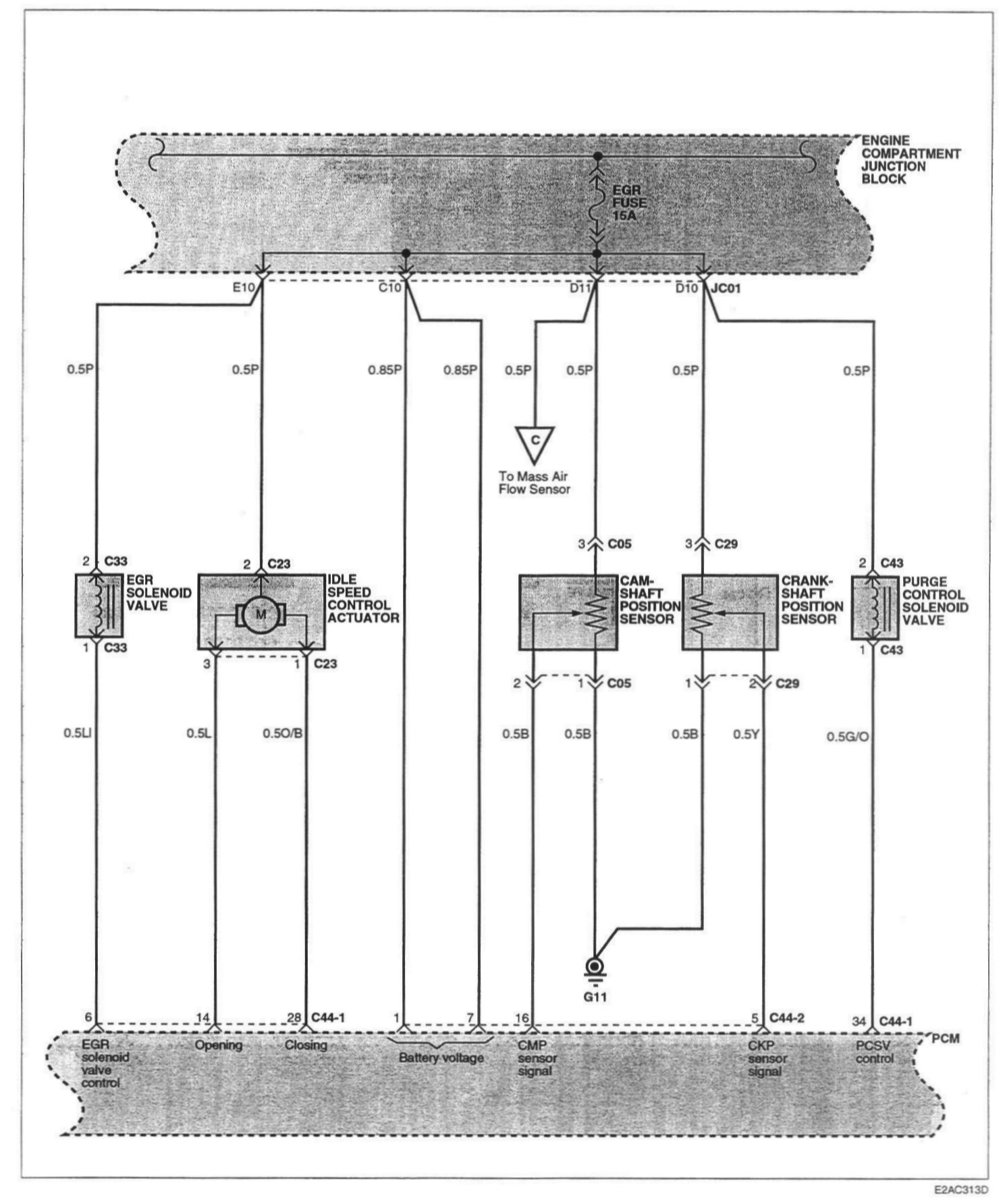

Okay, the wiring diagram I have shows pin 2 (center) as the signal lead with a black wire.
Pin 1 is a black wire going to ground and shares that ground with the crank sensor. Pin 3 shows as pink wire that is battery voltage from the EGR fuse.
It is connector C05 top right.
