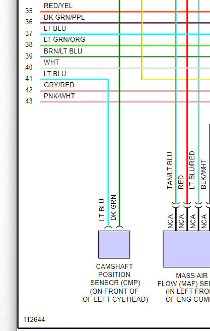

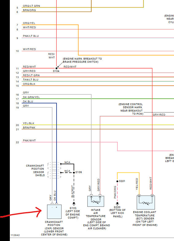

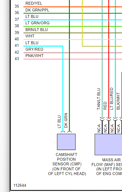

Can I get the Camshaft position sensor wiring diagram, please?
1999 FORD F-350
169,660 MILES • 6.8L • V10 • 2WD • AUTOMATIC
TOBEYCOMEAU
Which wire wires go to each; I have two wires off vehicle and a black and white on the pigtail I just bought can I get them backwards.
Feb 5, 2023 at 7:05 AM
  • 54,494 POSTS
Yes, I believe it does matter which wire goes to wear. Here are how the wires go in the diagrams below. Check out the images (below). Let us know if you need anything else.
