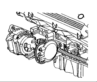

hi i am working on a 98 cadillac SLS and i am trying to figure out how to get the alternator out i am having problems getting the 2 front bolts all the other bolts are out but the 2 front and i dont know once i get those bolts out i dont see a way to get the alternator out there is no room can you help me with the problem and if possible send me a layout of the area and parts to be removed if at all possible

REMOVAL PROCEDURE
https://images.2carpros.com/forum/automotive_pictures/12900_a_1.gif
Disconnect the negative battery cable. Remove the accessory drive belt. Remove the radiator. Remove the air conditioning condenser. Raise and suitably support the vehicle. Disconnect the coolant outlet hose (1) from the generator.

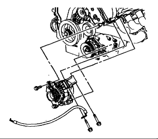

https://images.2carpros.com/forum/automotive_pictures/12900_a1_3.gif
Disconnect the coolant inlet hose (1) from the generator.

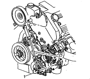

https://images.2carpros.com/forum/automotive_pictures/12900_a2_3.gif
Disconnect the following electrical connections from the generator: *Regulator *Battery output *Heated windshield (if equipped).
https://images.2carpros.com/forum/automotive_pictures/12900_a3_3.gif
Remove the generator fasteners from the generator. Remove the generator from the vehicle. INSTALLATION PROCEDURE
