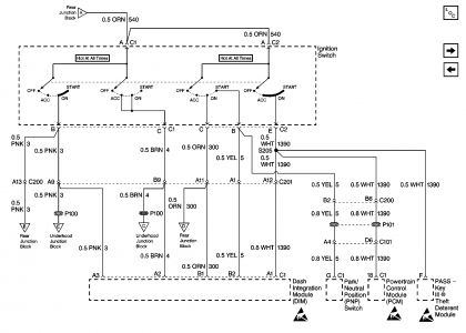

Sorry it took me so long to get back, was having computer issues. In order to enter diagnostics, and it is limited to trouble codes/clearing trouble codes, you use the info button and the on/off button. Press and hold info up, and on/off until all the segments illuminate, and then release. The drivers info message will read ALL? Just for simplicity, we will use ALL, so press on/off again and it will change to ALL CODES?. If you press on/off again, it will start displaying codes(if any) from all modules, in alphabetical order. If there are no codes in a module, it will say NO XXX CODES, and if there is no data it should say NO XXX DATA. This no data isn't always the case, if there is a module that is not communicating at all on the buss, it may not even show up. There should be upwards of 22 modules at least, I think about 24 to be exact. You can do this procedure with key on, or key on-running. The only time it won't work is if there is another scanner plugged in the DLC. It looks like your code scout is just a code reader. If that is the case, those are usually limited to emissions related codes, powertrain and maybe transmission.
If your test light is unpowered, it has a single lead that can either be grounded or powered. In checking a fuse, or if a fused circuit is powered, attach the lead to a good ground, and touch the metal tabs on the back of the fuses(each side of the amp rating), and it will light if a circuit is powered, and light on both sides if a fuse is good. Like I say, when the vehicle is acting up, check as many if not all, of the fused circuits to determine if any are missing power. From there we may be able to isolate a common power source that may be failing(relay, switch, fuse block, etc...)

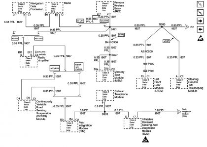

Here are the codes:
C-Current H-History
ABS: C1252-C C-1253-C C1298-C U1255-C P-ID-7208
AMP: U1255-H U1128-H U1064-H
U1016-H P-ID-836B
DDM: U1064-H U1065-H U1066-H
P-ID-6214
DIM: U1300-H U1255-H P-ID-8270
IPC: U1160-H U1064-H U1065-H
U1066-H U1088-H U1040-H U1255-H U1300-H U1301-H P-ID-807A
IPM: U1255-H U1064-H U1066-H
IRC: U1129-H U1064-H U1065-H
U1160-H U1016-H P-ID-F895
PCM: P1602-H P1611-H P1612-H P1614-H P1652-C
RIM: U1255-C 1065-H U1160-H
U1064-H U1016-H U1096-H
SDM: B1147-H B1148-H B1159-H
B1160-H B1163-H U1301-H U1096-H U1064-H U1255-H B1327-H
P-ID-8960
The problem clears up as the engine is warmed up. There are alot of fuses, which ones should I try 1st while the problem isstill happening, and should I be testing the fuses under the hood or just the fuses under the back seat ?

Was that all the modules that displayed, or just the ones that had codes? Initially, all the codes that had a U prefix, are communications fault codes. None of them suggest a common source of the fault, which would lead me more to thinking you have a module power fault. After having them recorded, I would recommend clearing them all. Run the vehicle until it exhibits failure and then run the diagnostics again and see which codes have returned. If you are having dashes display, and having the data reset after a fault, I would look at fuses that supply power to those modules, things labeled as HVAC, AMP(AUDIO), IGN 1, IGN 3. This type of problem may occur with a loss of power supply, a poor ground that fails under load, or even a class 2 communications fault(short to ground/power, open circuit). The fact that it occurs only when running, leads me to a power supply, but I have never experienced a fault of this nature. Keep in mind that with the airbag light, theft warning, and the low coolant message, it may have some other issues that are coincidental

Just the 10 modules that had codes, I'll clear the codes and test again. But there were not that many that showed no codes or no data. That's far short of the 22-24 modules that you said there are. What does that mean ?
The only way I was able to write down the codes for each module was to go through the list of modules 1 at a time, not the whole modules list at one time. Aren't all of the modules listed in the 1 at a at a time way too ?
I'll check it all out again.

I continued the test by going to the fuse box under the hood. The only fuses that didn't have power were the 3 or 4 fuses that were all listed as being related to the headlights-front-lights-etc.
When the car was acting up and there were no head-front-lights, there was no power to those 3-4 fuses, when the headlights would come on again the 3-4 fuses were recieving and sending full power.
When the lights were not working, it seemed like 1 or 2 of those fuses were recieving some voltage, between 0-1 volt.
I switched the ign-1 and ign-3 in the back-seat fuse box, as you told me to, no change.

Really very frustrated after spending the last half hour composing an e-mail, only to have the system drop out and lose everything. I suspect you have a communications fault. The nature will need to be determined through diagnosis. It can be a circuit wiring problem(open/short), a certain module corrupting or shorting the system, or power/grounding of a module. With the bizarre symptoms, I would suspect a fault in a module, or a short to ground in the communications circuit. With all of the U codes that return current, that is what I base my speculation on. The modules that show no data, are all powered from the rear fuse block, and you said all the fuses in the block had power, so we can only assume that power is at the modules listed. The statement of it being a relay or something simple, I don't feel applies. It is possible that the modules acn be disconnected, one at a time, and process of elimination may lead to the corrupted one. Circuit checks from module to module could be carried out when all of the connectors and modules can be accessed. It would be best to have a manual with electrical schematics on hand. The way the online service information is layed out, it would encompass several pages of schematics, component locations, connector end views, and also component R&R procedures. I will give you the ignition switch schematic, as well as the class 2 to illustrate. The ignition switch plays a common role in supplying power to the DIM, as well as receives power from, and delivers to, the rear fuse block.
https://images.2carpros.com/forum/automotive_pictures/309872_144162_2.jpg
https://images.2carpros.com/forum/automotive_pictures/309872_154569_2.jpg

Ideally, you are going to want a scan tool to connect and validate that a class 2 device, or the class 2 system can not be communicated with. There is no one ground that is common with the modules on the buss, and they are located throughout the vehicle. The only possibility, is determining if there has been anything done to the vehicle that may play a part in causing a fault. Body repair, aftermarket stuff removed or installed(I know you said there was none),major repairs that could have left wiring susceptible to heat or other damage, could name a few. In looking at your list of codes, the only thing remotely synonimous is that most control units(the ones that use info from) set faults with the modules that show no data. The U1300 code, is class 2 short to ground, and a few modules had reported it. The IPC even reported a U1301 which is a short to voltage. Shorts to voltage are more rare, because they have to be more specific in nature. A short to ground can occur anywhere. The fault chart for Scan tool does not communicate with class 2 is lengthy, because there is no sure shot way to track down a fault. I have included that for your reference. Basically, it has you do what I have stated, and that is disconnect the modules one at a time, until communication is restored.

Reconnect the IPM.
Disconnect the DIM.
Attempt to establish communications with the IPM.
Does the scan tool communicate with the vehicle?
Go to Step 67
Go to Step 69
67
Inspect CKT 1807 (PPL) for a short to ground or battery positive voltage (B+) between the DIM C2 terminal A11 and the SDM terminal 17.
Was a short found?
Go to Step 70
Go to Step 68
68
Replace the DIM.
Is the repair complete?
Go to Step 71
69
Repair an open or short to ground or battery positive voltage (B+) in CKT 1807 (PPL) between the DLC terminal 2 and one of the following components:
• IPM C1 terminal C8.
• DIM C2 terminal A12.
Go to Step 71
70
Repair the short to ground or battery positive voltage (B+) in CKT 1807 (PPL).
Go to Step 71
71
Reconnect or reinstall any connectors or components that were disconnected or removed.
Clear all of the DTC's.
Are all of the DTC's cleared?
Go to Data Link Communications System Check
