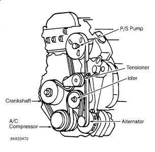

How do you put the serpentine belt back on.
Wednesday, January 6th, 2010 AT 9:02 PM
DOCFIXIT
MECHANIC
18,828 POSTS
Rotate belt tensioner to allow room to put belt on then release see diagram
