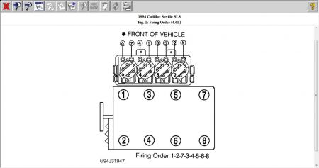

I cant figure out thee firing order?
Wednesday, October 14th, 2009 AT 10:13 PM
MECHANIC
75,992 POSTS
Its a 4.6L engine Check out the diagrams (Below). Please let us know if you need anything else to get the problem fixed.
