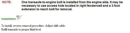

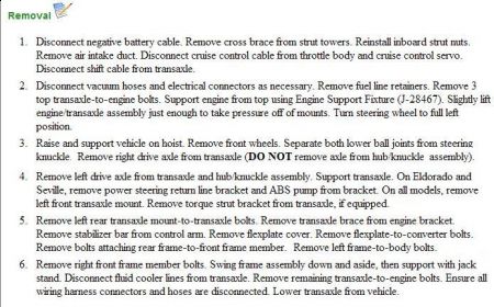

What is invlolved in replacing the trans; unbolt and drop?
