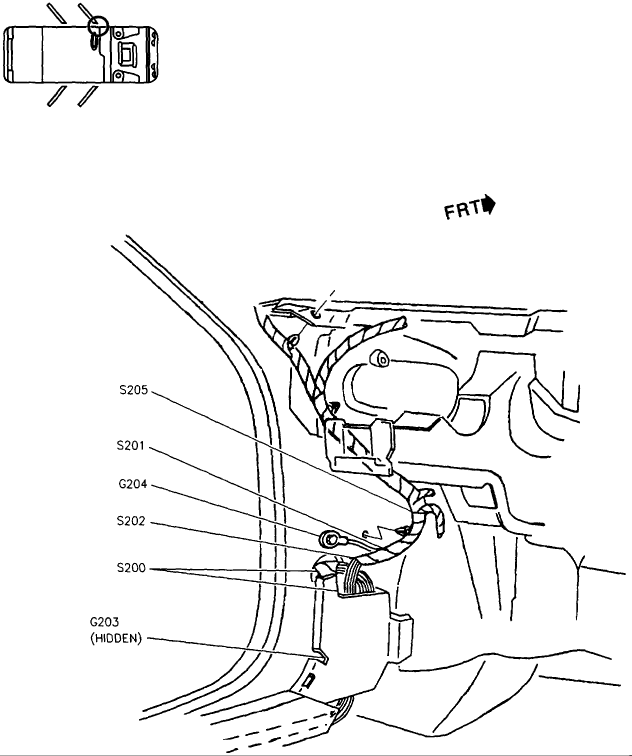

Hi There,
My windshield wipers suddenly stopped working in my 1998 eldorado. I have ground on the plug that goes into the motor but no power? Is there a relay or something? The fuse is fine I don't understand why they all of a sudden stopped? Just before this happened, My blower motor to my heater stopped working after I smelt burning plastic and then a small amount of smoke came from the middle vents. I have checked fuses, fine, I am getting power in my plug that plugs into the motor. I recently bought a used motor plug it in and still doesn't work? Is it another bad motor? I tried jumping my old motor directly from a battery and nothing happened. Same with the used one I purchased, didn't work when I jumped it. Not sure if I jumped it correctly, put the negative to the red wire and positive on the black wire. Can you please help me with this? My baby is falling apart:(

At the three wire blower connector, there is a red, a gray, and a black wire. If you have a test light, check across the red and black wire, and the light should light. If it does not light, the red wire gets it's power from the inadvertent fuse(50A) in left underhood fuse block, I believe it is a maxi fuse. If it does have power and ground, you could have a faulty blower motor, or the spee output from the a/c programmer has a fault. That output can not be measured with a test light, it is a digital pulse width signal. A voltmeter may show you something. Ideally, a scan tool would be able to show you that the control panel is requesting a desired blower speed, and it may also show the commanded speed out of the programmer.
On the wipers, I am showing the washer pump mounted to the reservoir, but that is not important. Everything is controlled out of the windshield wiper module, which is attached to the motor. It looks like the wiper module connector(s) may give you what you need. The first question is, do you have a test light, and do you know if this vehicle has moisture sensitive wipers? The option code for the latter is CE1, and the RPO sticker should be located under your spare tire cover in the trunk. The schematic, and parts involved, are different in either circumstance. I do not see any relation with a blower going out, and the wipers, I don't see that they share anything.

Thank you for tyhe timely response gstacey! I just picked up a test light on my way home today and found out that my plug going to the blower motor has power in it but no ground with the car off as well as started. Does this mean I have a ground issue and the motor is fine? I checked my 50A fuse as well and both sides light up. Does this mean I have a loose wire behind the 50A fuse which is causing a faulty ground?
As far as the wipers go. I do not have moisture sensative wipers. Hypothetically, If my motor recieves power and ground and is still not running it has to be the wiper switch right? I suppose the only way to check the switch is to disassemble my steering column and pull it off?

The wiper switch harness comes out of base of the steering column youll see it runs to a connector. Probe the switch harness to check the voltage on orange and pink with the key on. Where did the blades stop because the delay cover and park switch controls the ground for wiper oper?

My mistake gstacey. I'm obviously new to electric system diagnosis. I performed the correct way to check and yes I do have ground on the plug leading to the blower motor. The used blower motor that I tried should have worked right away then correct? I had everything on high when I plugged the new one in at the parts store. I had it plugged in for about a minute or 2 with not even a noise?
Cadieman, I correctly checked the windshield wiper motor plug and I have nothing there! No ground or power on any speed. The blades stopped in the off position. Checked the wire harness at base of steering wheel. There were two types of wires small in diameter and larger in diameter. The larger wires check out they both light up the tester. With the smaller wires there really isn't an orange wire. There's two "white" wires inside an orange sleeve that seems the only possiblility. With the pink wires there's two seperate ones. One on the far left side of the harness and one next to the orange/white wires which I would assume you are talking about. The one next to the orange/white ones did NOT turn my test light on, while the other pink wire did. If those were the correct wires does that diagnose my problem that it's a bad wiper switch?
The only thing that worries me is it might be a wiring issue or "open wire" because of a few things. It all started with my AC. It stopped blowing cold air, it would only blow cold air when I was at top speed. Then the smoke came through the vents as described in earlier posts. Then my wipers went, my compass in the rearview mirror went, and the auxillary mode in the ignition the one where you put in the far back position to get some power went too! I have A hard time believing my luck is that bad. But I've been wrong before.
