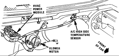

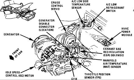

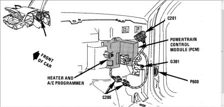

I need to replace the blower motor speed control module. I'm told it's in the evaporator housing,but I have no idea where it's located.

You probably looking for the Heater/AC programmer see-below

Thanks for your help,but thats not it. It's on the firewall close to the blower somewere, in or on the evaporator housing, os i'm told. Do you know where the evaporator housing is? Thanks
I've looked into this in Alldata there's is no module its the programmer that controls the speed of the blower motor

Heres what you are after, known as the HVAC power module.
https://images.2carpros.com/forum/automotive_pictures/309872_42279375_1.gif
https://images.2carpros.com/forum/automotive_pictures/309872_42279376_1.gif
