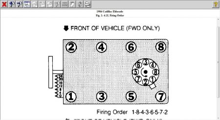

What is the firing order on a 1984 cadillac eldorado? How do you determine what the number one plug is on the distributor?
Sunday, February 15th, 2009 AT 1:13 AM
2 Replies
MECHANIC
75,992 POSTS
There you go
Sunday, February 15th, 2009 AT 1:29 AM
BONGERI
MEMBER
3 POSTS
Cadillac stamps the firing order right onto the engine. Look under the air cleaner.
