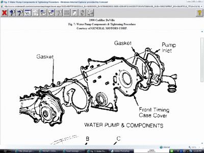

Where is the freeze plug on the block of a 90 cadillac deville. Cant figure out how to get to it :(
Saturday, October 13th, 2007 AT 10:22 AM
3 Replies
MERLIN2021
MECHANIC
17,250 POSTS
There are a few of them. What engine size? There will be some on the sides of the block, and on the rear. Smaller ones on the cylinder heads.
+2
Saturday, October 13th, 2007 AT 10:32 AM
MIBUTTERFLYWINGS
MEMBER
2 POSTS

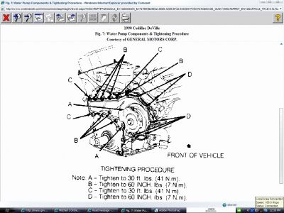

Its a 4.5 v8, leak coming from front of motor on passenger side
Saturday, October 13th, 2007 AT 10:40 AM
MERLIN2021
MECHANIC
17,250 POSTS
If you can get a pressure tester, this will help find the leak, and the coolant can be cold, here is the proceedure for water pump replacement...
