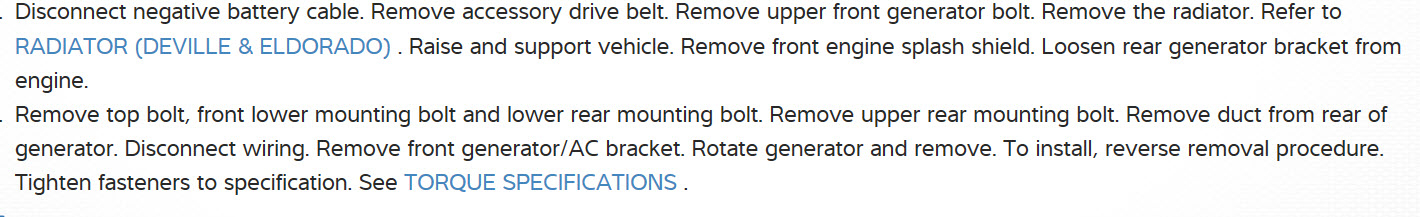

Electrical problem
1998 Cadillac Deville V8 Front Wheel Drive Automatic
How do you change an alternator for a 1998
cadillac deville?
cadillac deville?
Feb 12, 2019 at 2:03 PM
(Merged)
Disconnect the battery, remove the serp belt, remove the bolts mounting the alt, remove the wiring from the alt, and remove the alt. Reverse the sequence to replace it.
