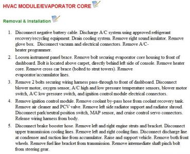

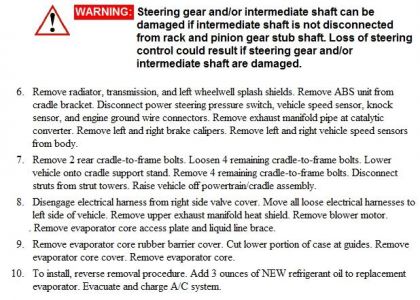

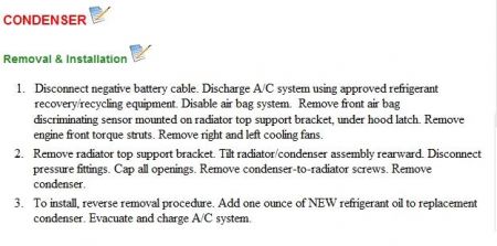

My Mechanic needs to install a new evaporator core and condenser in my car, and I am wondering what all is involved with this process--the dissassembly and reassembly. I'm trying to keep my mechanic honest by knowing a little more about the process. Any assistance would be appreciated.
