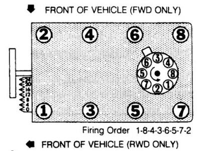

cylinder location and firing order
1998 CADILLAC DEVILLE
JENIMAE
need firing order in relation to cylinder
Thanks
Dec 2, 2008 at 9:40 AM
  • CAR REPAIR CONTRIBUTOR
  • 110,190 POSTS
Hi: I hope this helps. It for a Deville 4.6L.
https://images.2carpros.com/forum/automotive_pictures/249084_94652368_1.gif
If you have other questions, let me know. Joe

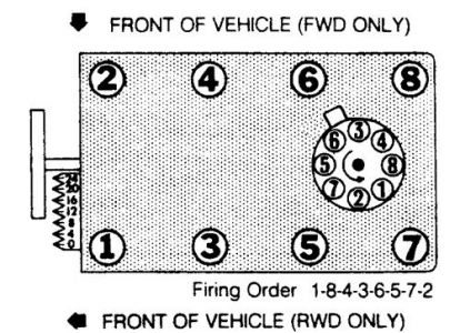

Dec 5, 2008 at 10:49 PM
STORMY747
where do you start #1 from the engine to the distributer cap? do it go clockwise or counterclockwise? is it possibe to show a diagram of the firing order for the selected make and model?
Feb 12, 2019 at 5:03 PM (Merged)
BUZZSAW
  • 1,198 POSTS
[quote:b5561f37e9="stormy747"]Engine Mechanical problem
1995 Cadillac Deville V8 Front Wheel Drive Automatic 120000 miles
where do you start #1 from the engine to the distributer cap? do it go clockwise or counterclockwise? is it possibe to show a diagram of the firing order for the selected make and model?[/quote:b5561f37e9]
the firing order is on the intake, I believe it goes in a clocewise direction, remove the distributor cap to ck, to find where #1 is remove the #1 plug and have someone bump it over when its on #1 compression should be comming up

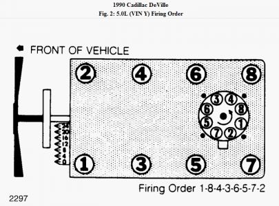

EDB40505
Engine Mechanical problem 1990 Cadillac Deville V8 Front Wheel Drive Automatic I need to now the firing order for a 1990 Cadillac Deville. I found one diagram
https://images.2carpros.com/forum/automotive_pictures/512618_55492DE_1.jpg
But this doesn't seem to be correct.
  • 75,992 POSTS
https://images.2carpros.com/forum/automotive_pictures/12900_fo_105.jpg
