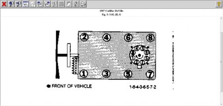

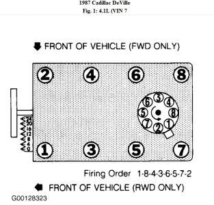

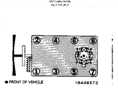

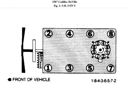

I need the firing order for this car and also could you tell me which cylinder is number 1? Thanks guys.
