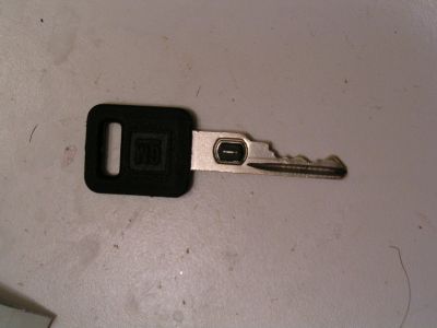

It should be easy to see. Looking at the ignition key there will be a little pellet embedded in black plastic that has a resistance value. There are 12 possible resistance values. Basically if your looking at the ignition key and the door key, the ignition key should look different, right where the key enters the ignition cylinder should be the pellet. Is it possible for you to take a picture of key and upload it, then I can point it out to you or to make sure you have pass lock 2 system and we are on the same page?

The key has a black sort of retangle with a sliver of metal in the middle of it approx 1/4 inch from the end of the key cut and below the plastic or rubber coating at the square top of the key blank

Exactly, thats pass lock 2. The no start is not from the theft system.

This is my key

Yes that silver piece is the pellet. That system is all by itself and can be bypassed if need be by measuring resistance across the pellet and getting a resister to match it and then wire it across the 2 tiny white wires under the steering column in the orange sheeth. If the car ran before changing pcm then problem is going to be in the pcm. I would ask the dealer if the pcm can be programmed for the different gear ratio, they can give you a better and more definite answer.
