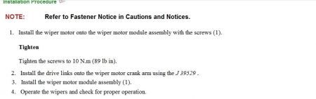

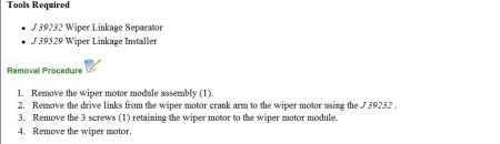

How do I change the wiper motor in my cts. I do not have a manual.

BLUELIGHTNIN6
MECHANIC
16,542 POSTS
Friday, July 23rd, 2010 AT 9:44 PM
