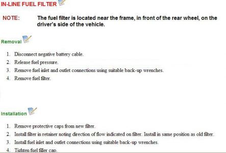

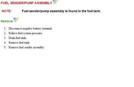

Can you give me step by step instructions for changing fuel pump and fuel filter

That's how it is done, simple as that. Still can't do it? Take it to shop
