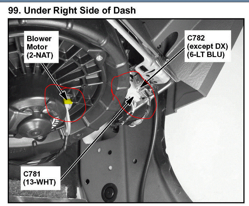

The first thing we need to do is check the wiring connector at the blower motor and the speed controller.
The blower motor is located under the dash on the passenger side. If you look at the pic below, it shows the connectors I need you to inspect.
When checking them, make sure there is no evidence of the connector overheating, wiring damage, and make sure the connectors are in good condition and not loose.
See pic below.

All connectors and wire look good. In addition, I used a multimeter after disconnecting the blower motor connector and found that I got 12V at one of the 2 pins. The other must be ground. So, I removed the Power Transistor Module connector and then reconnected the blower motor connector. I used a jumper wire to give it ground, bypassing the Transistor, and the blower began to turn, but not at full speed. Hence, I think the bearings may be shot. Any ideas?

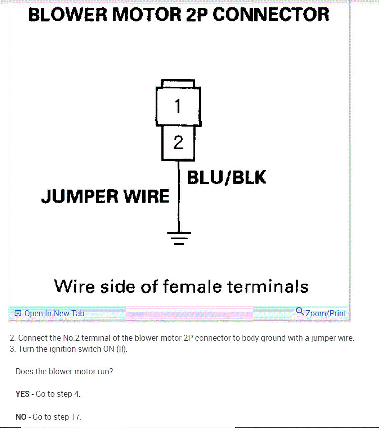

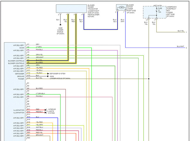

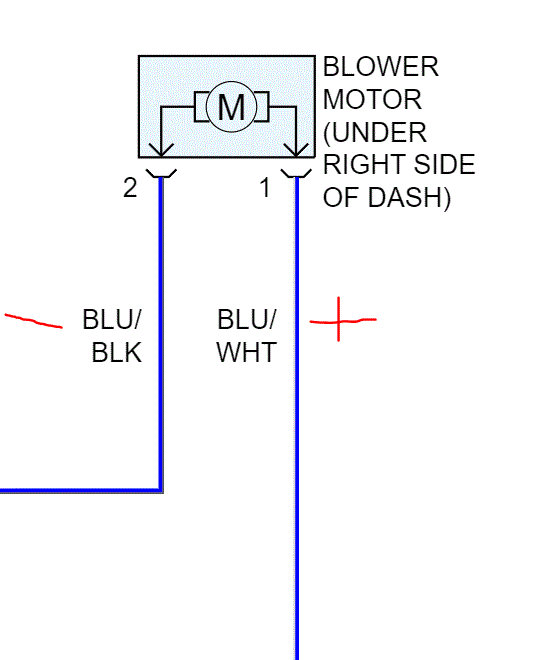

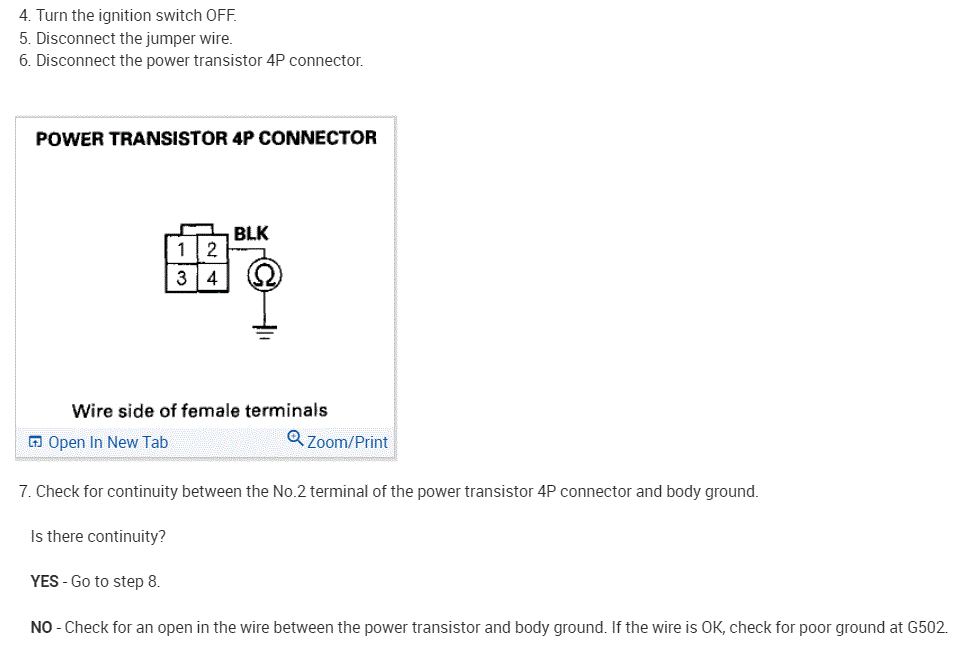

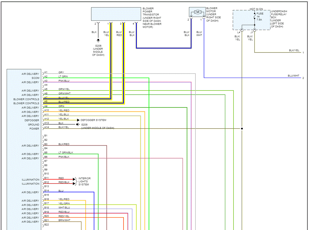

Take a look at pic 1 below. There should be two wires at the blower motor connector. The blue with a white tracer receives power from the blower motor relay. There should also be a blue wire with a black tracer. That is the ground. It runs to the transistor, and based on the speed selection, the transistor provides a ground path through different levels of resistance to change the motor speed.
Now, if you supplied 12v to the blue/white wire and ground to the blue/black wire, the fan should run full speed. Is that happening?

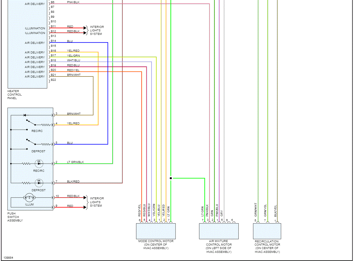

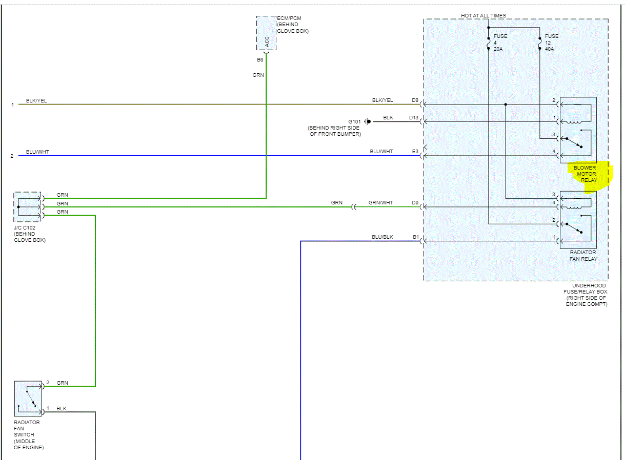

Also, the remaining pics are the wiring schematic for the circuit. I thought you may want to see if and use it as a reference.

Like I said, now the motor does not turn at all when the key is on and ground is supplied at the blue/black wire. So definitely the motor. But is there a way to test if there is a switch or power transistor short?

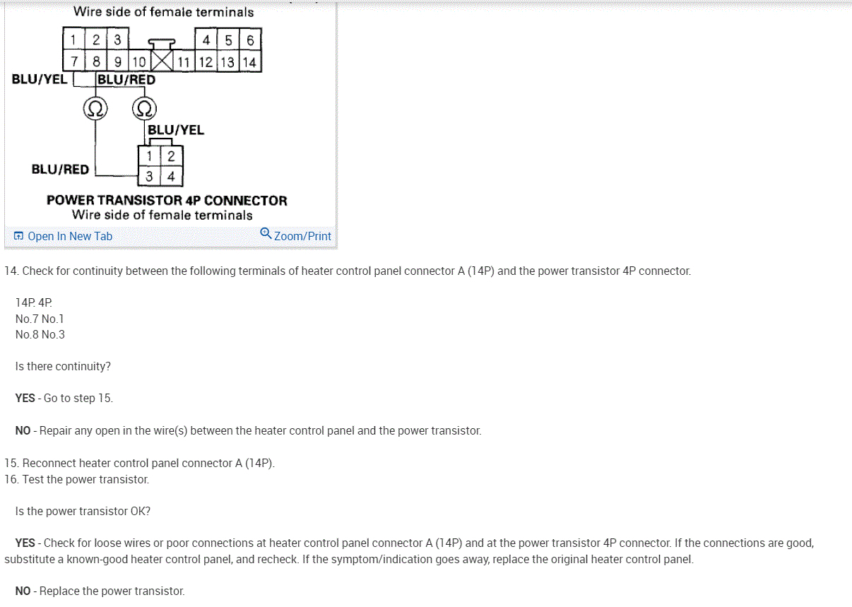

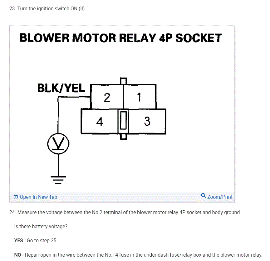

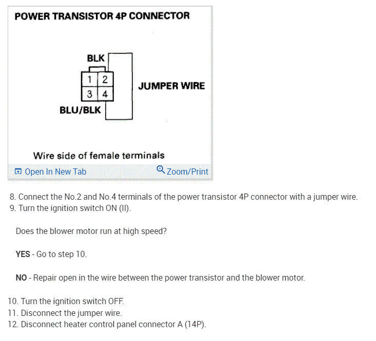

  • 110,194 POSTS

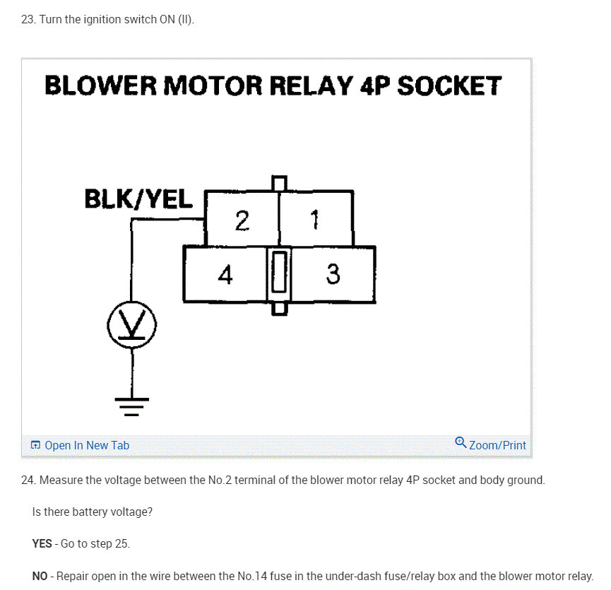

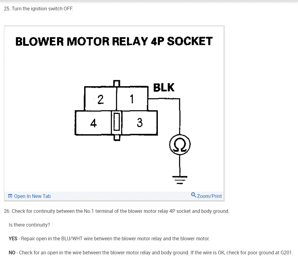

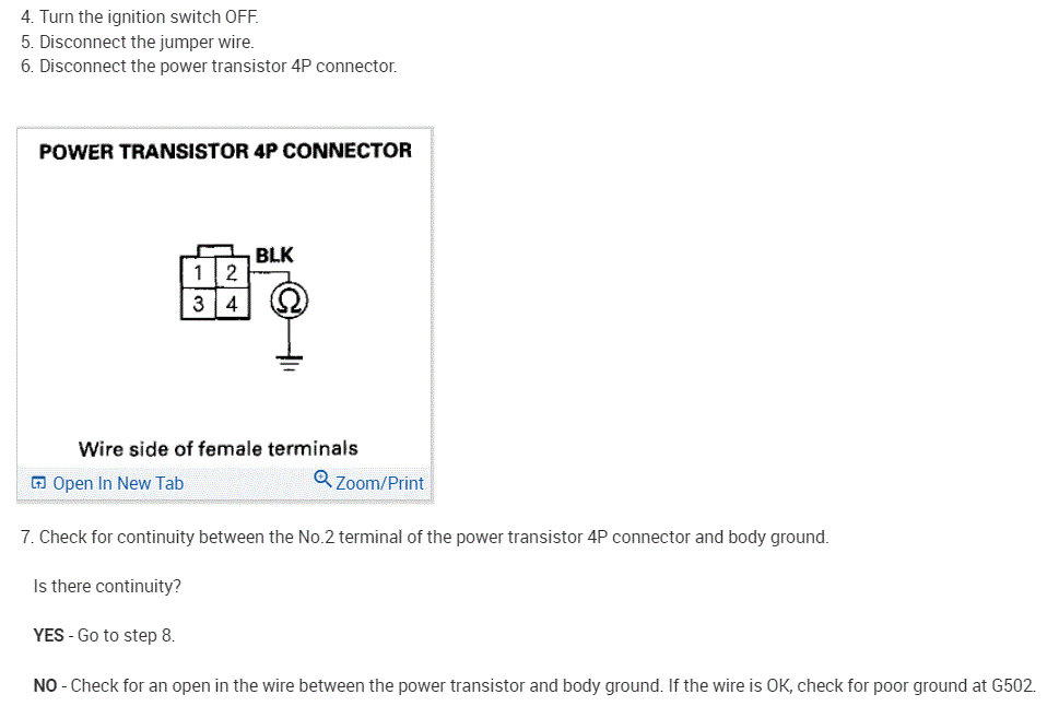

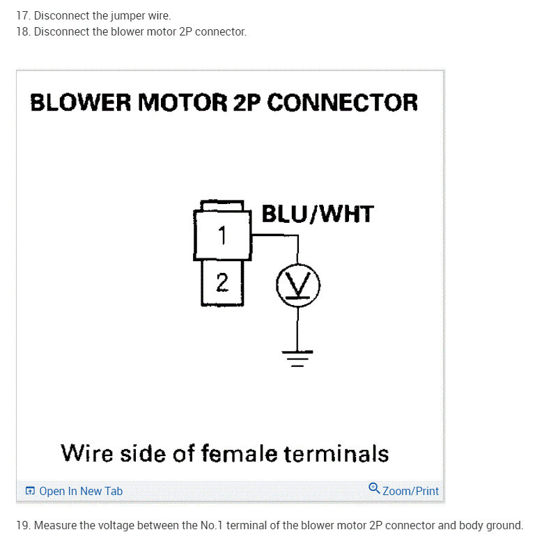

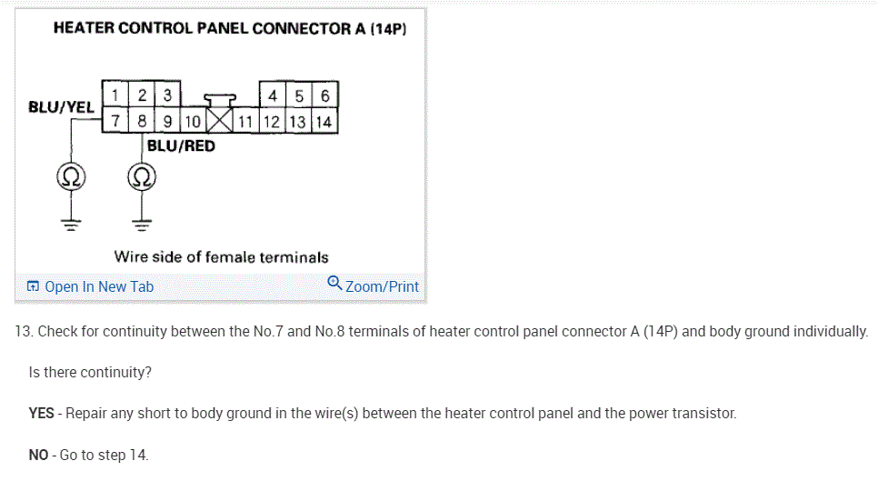

Okay. When I check an electric motor, I always like to supply both the ground and power. That way I know there is nothing other than that could prevent it from operating.

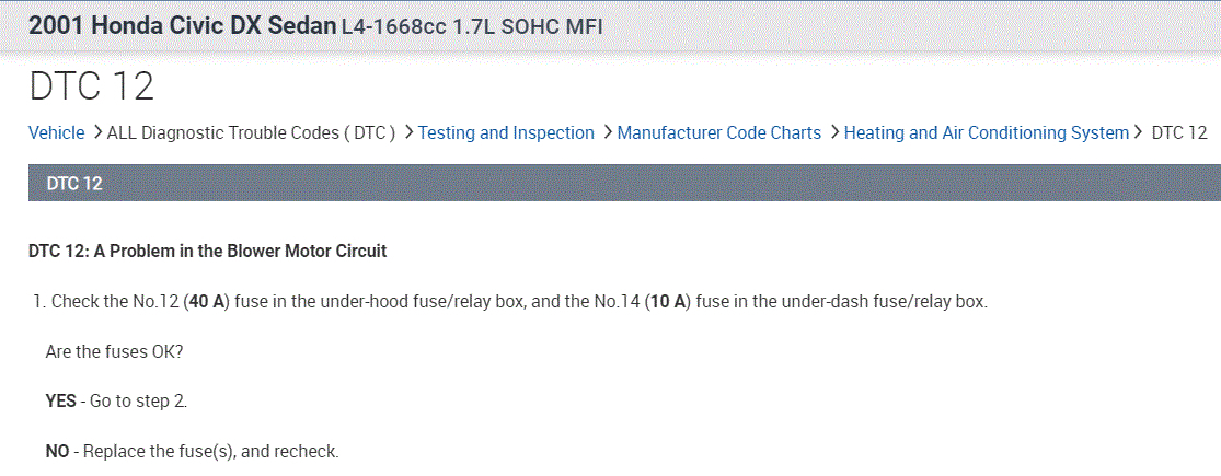

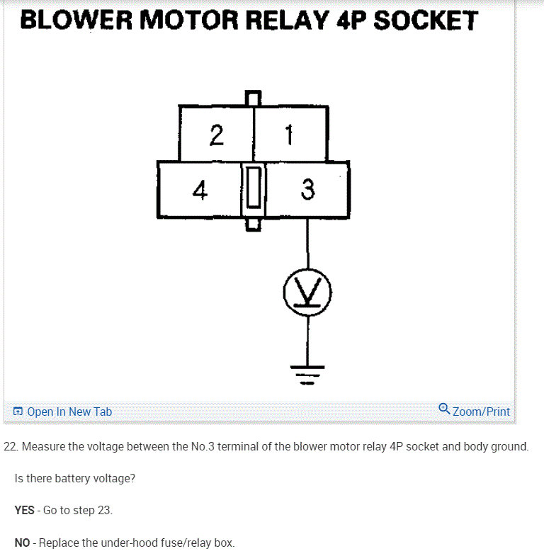

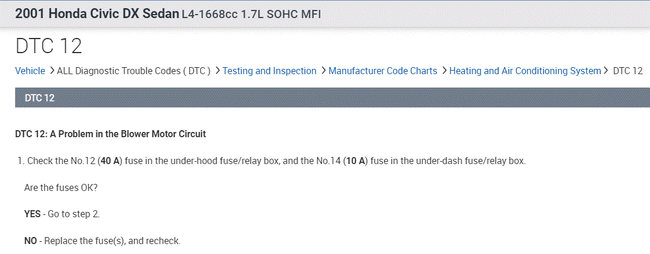

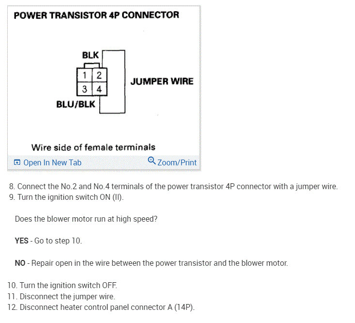

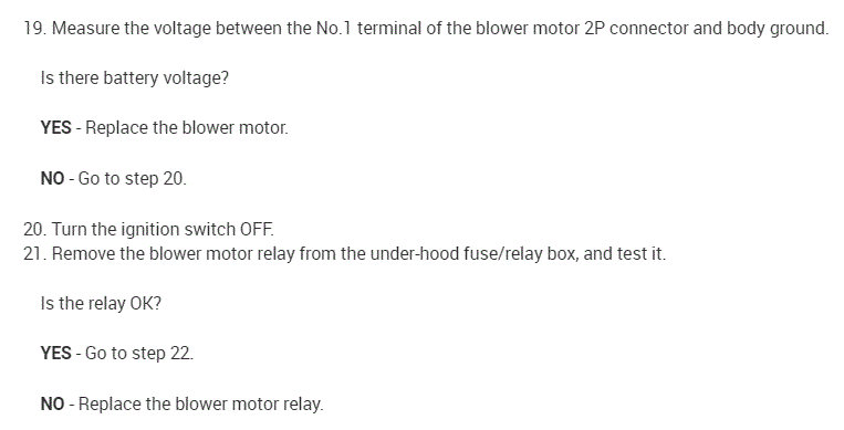

As far as the test is concerned, I attached everything below. The diagnostics cover the switch, relay, power transistor, wiring, and blower motor.
Let me know if this helps.
